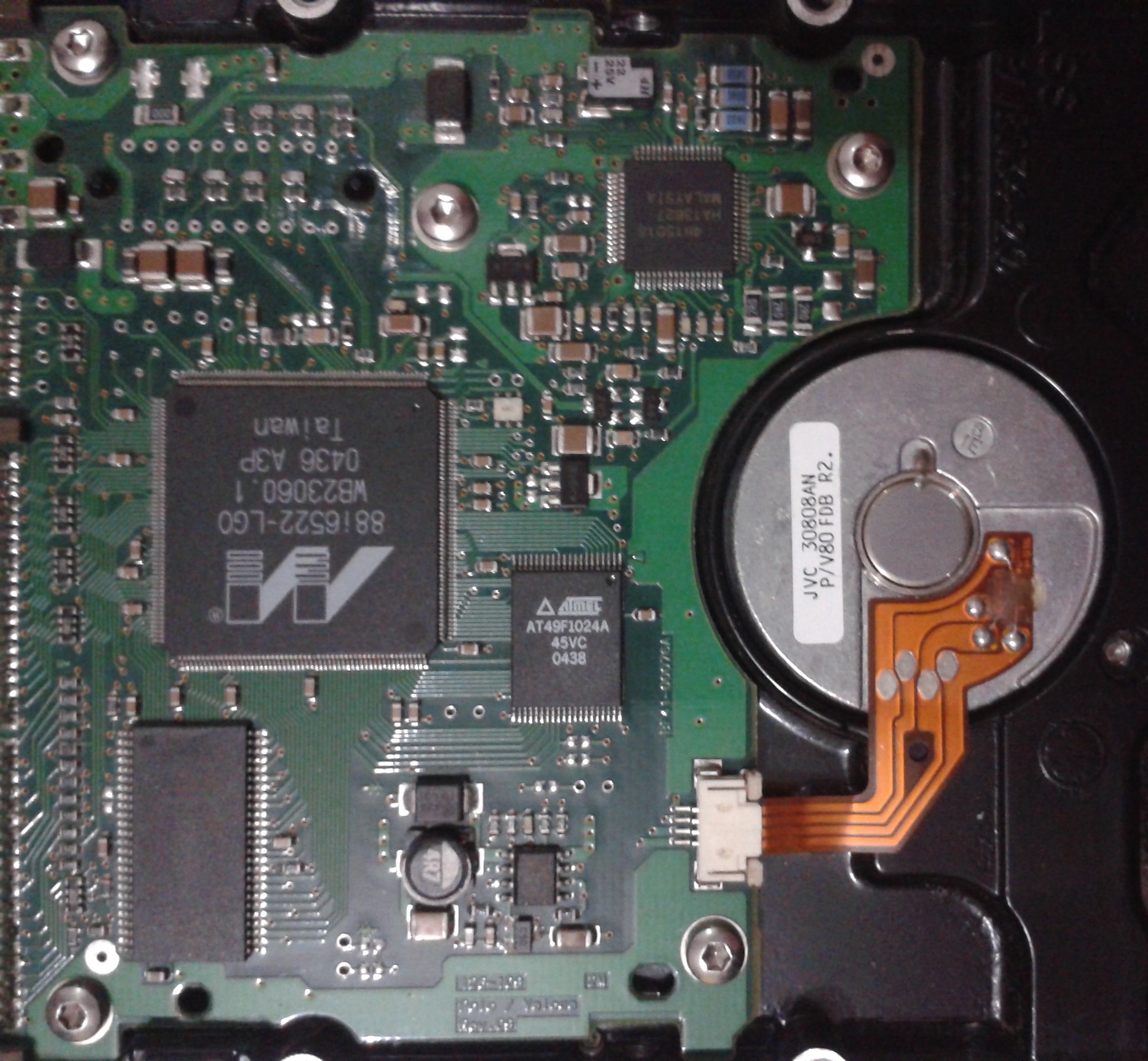

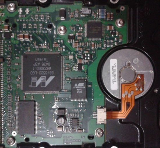

The diodes are OK. Could we see a detailed photo of the PCB?
 Post subject: Re: Samsung IDE hard drive won't spin up
PostPosted: December 12th, 2013, 15:17
Joined: December 12th, 2013, 10:30
Posts: 13
Location: Turkey
Sure, here.

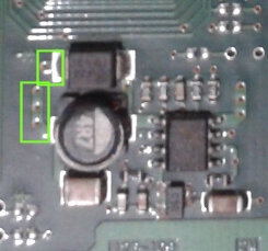

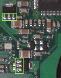

I would measure the voltages at the points identified in the attached photo clips. Be very careful not to short adjacent pins with your probes, as catastrophic damage will result.

And I just measured the spots you pointed out in the pictures in the 20VDC range:
    First picture, from top to bottom: 0.00, 2.05, 2.05, 2.05
    Second picture:
      Top one, from left: 4.03, 5.06, 3.32
      Bottom one, from top: 2.04, 2.05, 1.34
