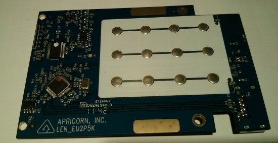

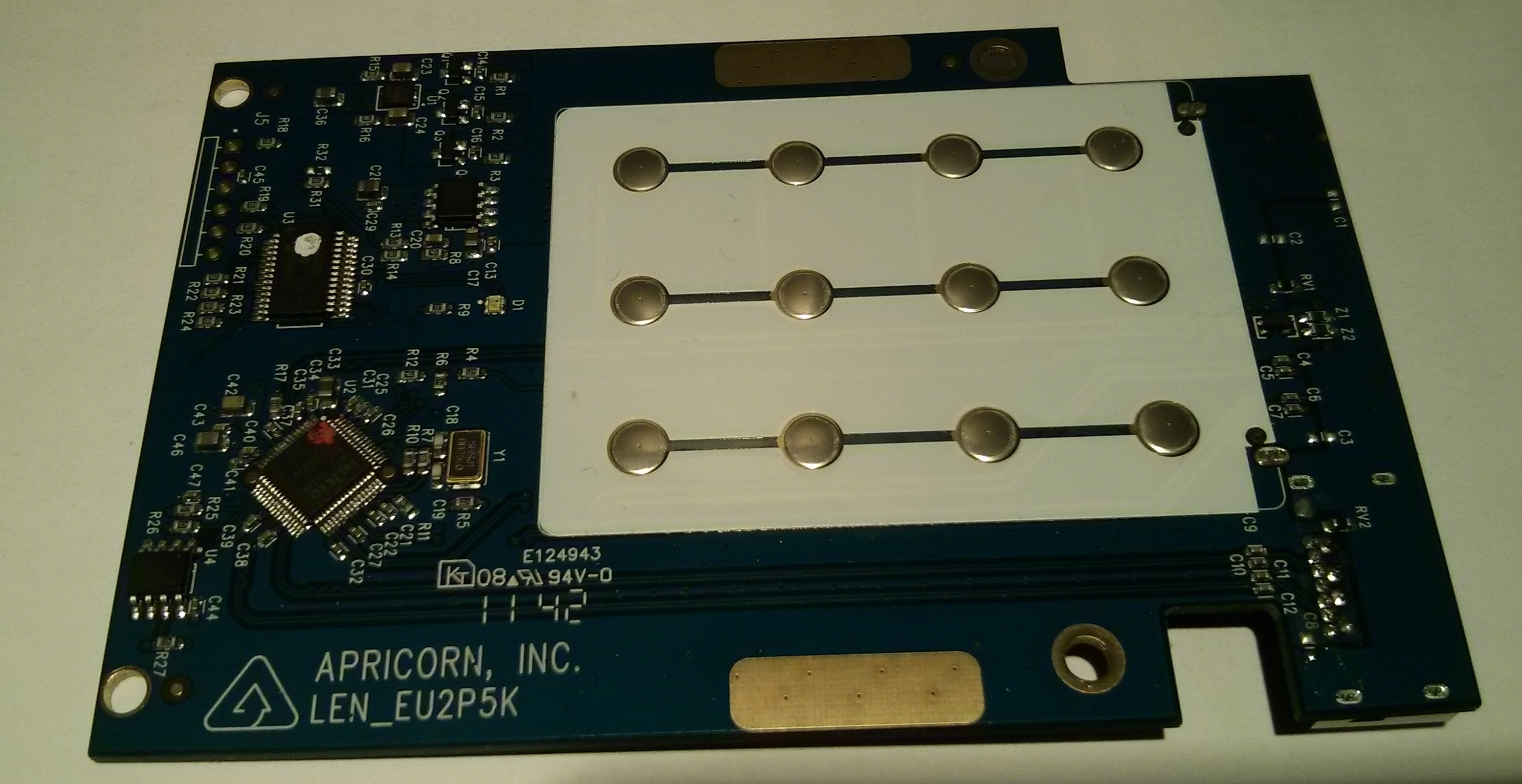

I've been left struggling due to encryption based on the PCB of a caddy, one of these:
http://support.lenovo.com/en_GB/product ... MIGR-74406
http://download.lenovo.com/ibmdl/pub/pc ... _hd-ug.pdf
HDD has had full disk image created, bad sectors filled with pattern, there were very few.
Connection by USB powers the HDD, it is possible to unlock using the keypad and get the green light indicating successful unlock. The device is not detected by the computer (no USB detection or by eSATA). I've checked continuity on all the USB pin-outs. These are fine. The data + & - have no break in continuity to the point they reach the USB processor - Initio INIC 1610EL.
The manufacturer of the PCB with the security features is Apricorn INC. I've had one in before branded as "iStorage diskashur" and it was straight forward to decrypt. It appears there is some fault with the caddy PCB.
I presume the security info is stored in either of the 8 pin serial ROM chips or the larger 28pin chip, but I expect trying to find a matching donor caddy PCB will be difficult due to chip revisions? On the previous model I handled the critical chips had a hard epoxy covering to prevent removal or identification
Does anyone have any suggestions?

Image of PCB can be viewed here:
http://s30.postimg.org/chj3tw4yp/IMG_20 ... 193828.jpg

If you could provide a better photo, perhaps I could try to help you on the electronics side.
BTW, you first two URLs are incomplete.

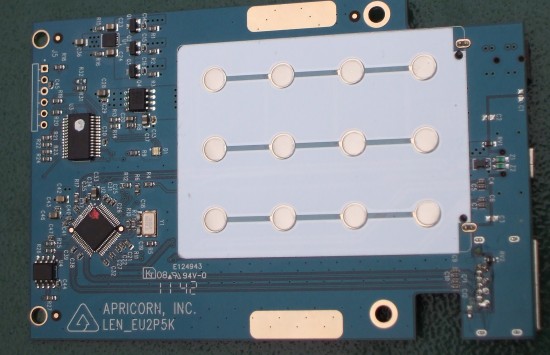

A (slightly) better quality image is attached.

The photo is still useless, but ISTM that if the password were stored on the PCB, then a PCB swap would easily defeat it.
I don't see the two "8 pin serial ROM chips" that you refer to. I only see Q4 which is possibly a dual MOSFET for switching power to the SATA connector. The other is U4 which, judging by its proximity to the bridge IC, could be a flash memory.
I suspect that U3 (the 28-pin IC) is, among other things, a keyboard decoder, not a memory device, although it may contain some embedded flash.
If you could provide the markings on each of these chips, then I may be able to determine a little more about them.

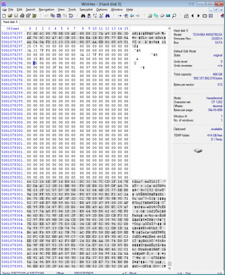

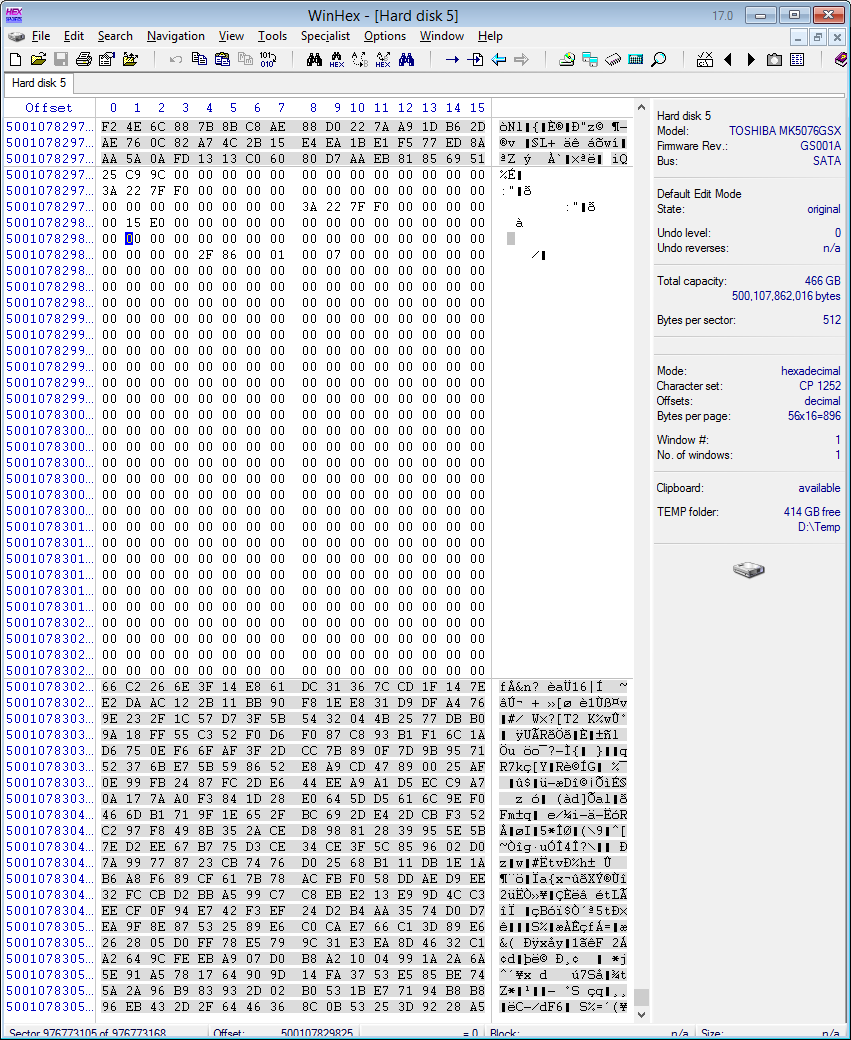

Post the contents of sector 976,773,105

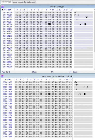

See attached the sector dump as requested. Content of the requested sector obviously of different sort to the encrypted data on the sectors either side.
PCImage - Interesting that the device does not initialise to be detected by the computer even as a USB device if the critical sector has not got the correct data in.

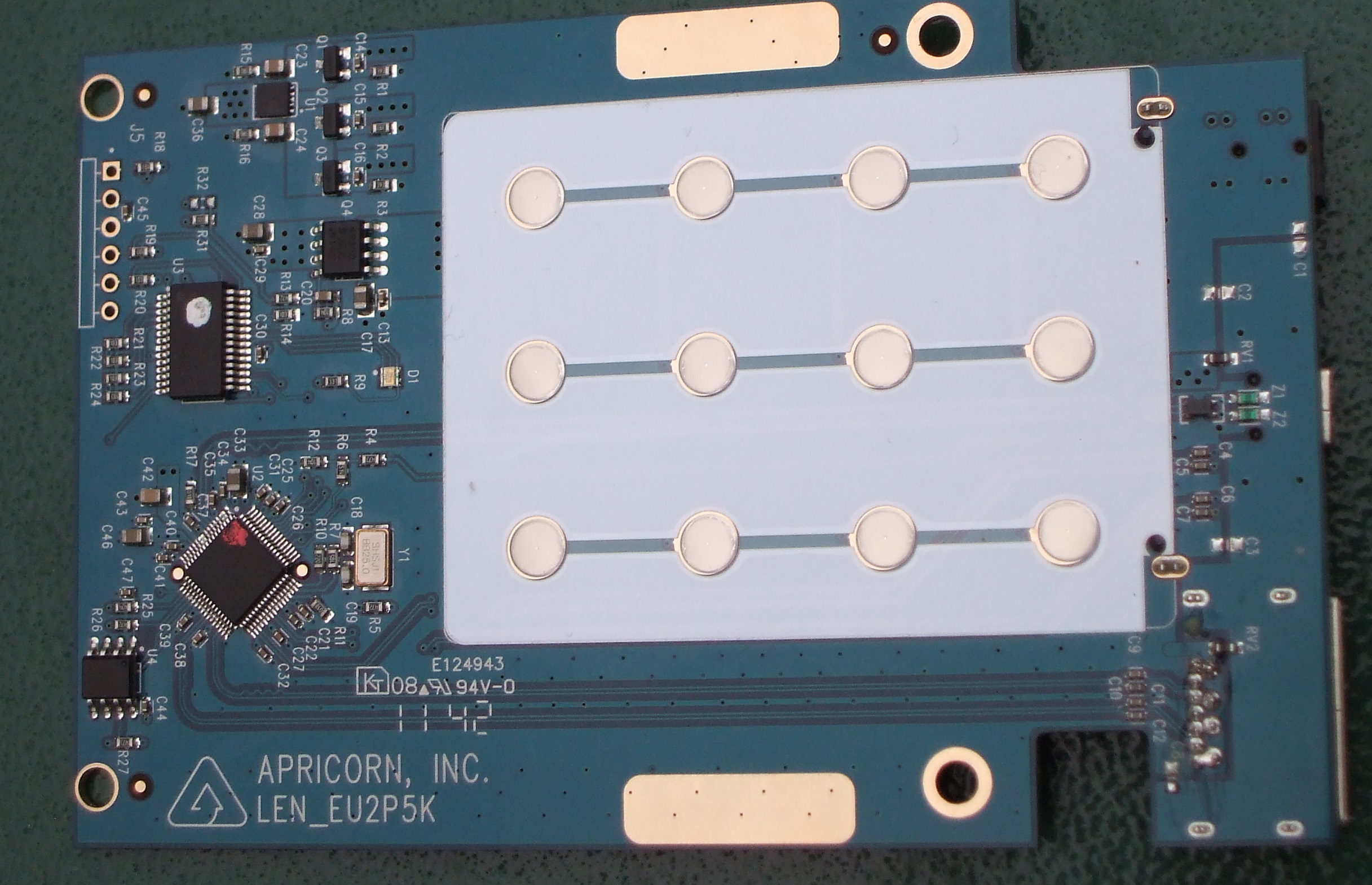

Yes, my apologies for the bad pictures - the battery on the SLR has died. Better picture now attached.

@cheadledatarecovery, if you would like me to help you determine the function of the various chips, I would need you to identify their markings. I can't make out anything in that regard from your photos.
If you would like to determine whether the USB interface is functional, one way would be to imagine how the board would behave if the flash memory (U4) were blank, as would be the case at manufacturing time. In this case the Initio bridge IC would probably prepare itself to receive a firmware upload, and to this end it would probably enumerate itself as an Initio Default Controller using Initio's PID and VID. To place the bridge in this mode, I would short U4's HOLD pin (#7) to ground. Of course you would need to verify the chip's pinout from a datasheet before you could be certain that this was safe to do.
BTW, Q4 appears to be a single P-channel MOSFET whose function would be to switch +5V power to the drive. Pin #4 is the gate (control) pin, and it would probably be driven by U3 or U2, probably the latter, if WD's products are any guide.
U3 appears to be an intelligent chip, possibly a 4-bit microcontroller with several 4-bit I/O ports. It may contain some flash memory. The keypad has 3 rows and 4 columns which means that 7 I/O lines would be required to decode it. I can't see where these lines go, but the underside of the PCB will probably point to U3 as the decoder. U3 also has 3 I/O pins which drive the tri-colour LED at D1.
U1 and Q1-3 appear to have some power related function, but I can't be certain until I see their markings.

Regarding sector 976,773,105. I've found that if I do zero this out, or even using a completely non-matching HDD, that when I enter the security code that I still obtain the green LED indicating a successful unlock.
Moreover, if I then remove the HDD from the caddy and check sector 976,773,105 it shows that same data as pictured in the above sector dump has been re-written to the hard disk drive.
In this case the user's key code is the default code provided with the HDD (12345678'unlock'). From reading the user manual it appears that after certain number of incorrect attempts that it will prevent further unlocks and the device requires resetting to allow normal functionality. What the manual does make clear is that if you choose to reset the device then it will not be possible to recover the data from the device.
I am not certain what previous attempts the customer made with this device. He works for a large organisation and it could well have been handled by his IT support staff too.

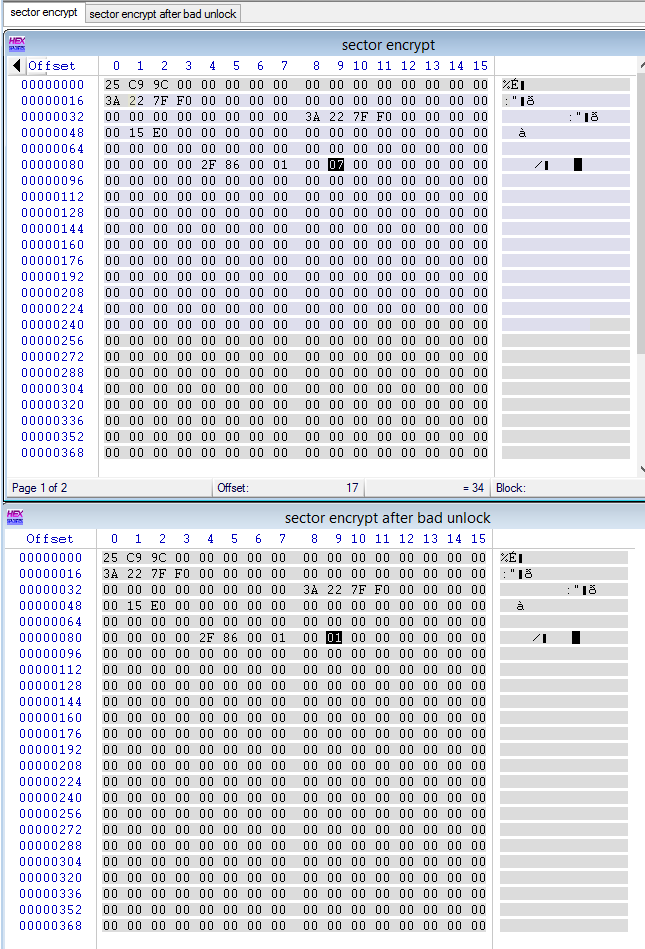

If you enter the wrong code, do you get a different coloured LED, and does the key sector change to something else? For example, does it look like some counter is being incremented? If there is no change, then this would suggest that the password attempt counter could be stored within U3. It would help to know the markings on U3 (can you not see them under a bright light?) so that we could consult a datasheet. The datasheet might tell us if U3 has rewriteable memory. You might need to scrape away the white paint.
 Post subject: Re: Apricorn encrypting USB HDD
PostPosted: December 18th, 2013, 18:19
Posts: 306
Location: Manchester, UK
When the wrong code is entered a red flashing LED is produced.
See attached sector dump for the difference in data on the HDD at 976,773,105 when the incorrect unlock code us used. Differences highlighted. When a incorrect code is entered a second time there are no further changes to the sector.
On U3:
PIC16F883
-I/22
11189BQ
