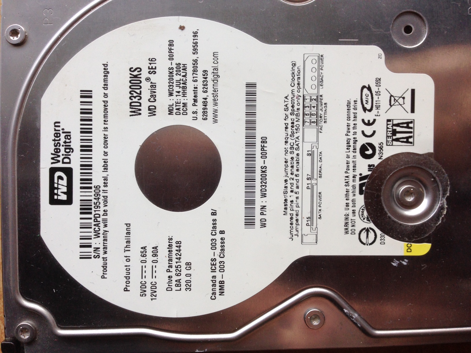

Yesterday my most important hard disk drive fell off my hands on the floor and my heart stopped for a few seconds :)
When i put it back on-line i heard clicking noise from the heads. I open it carefully and I saw that one head has broken.
The hard disk is a Western digital
MDL : WD3200KS-00PFB0
LBA 625142448
DCM HHBACAJAH
So decided to swap heads watching some videos on you tube and reading some articles, but i need to find the compatible heads.
So my question is :
Do you know for sure what letters from DCM should be the same to find the same heads ?
Thank you very match.

 Post subject: Re: Western digital head swap question
PostPosted: December 18th, 2013, 15:47
The DCM is the least of your issues, these drives have hideous inter-head alignment issues which prove very tricky, even for a lot of pros.
So with respect, I give you 0.1% chance of succeeding :-(
If you need the data then send it to a DECENT pro, with specific experience with this model.

There is conflicting information about DCM and what characters are necessary to match. Some people say 4&5 and some say 5&6
But to me personally, DCM is mostly irrelevant and have had success with using heads from drives with totally different DCM, and even model.
But in 99.9% of cases the drive DOES NOT spin up and work right off on its own, as you're expecting it to. I can virtually guarantee that.
Sorry it's not what you wanted to hear :-(

Positions 5 & 6 for this model.
This is a drive with 6 heads, and a lid / bearing cap alignment issue. You've already buggered up the head alignment by opening the drive. The fact that this drive doesn't have a parking ramp, but parks heads on the platters, and one head is broken, means that there is media damage.
You'd be better off spending your time and money with a bottle of Tsipuro, vrai.
Yiassou (kai kali tehee),
