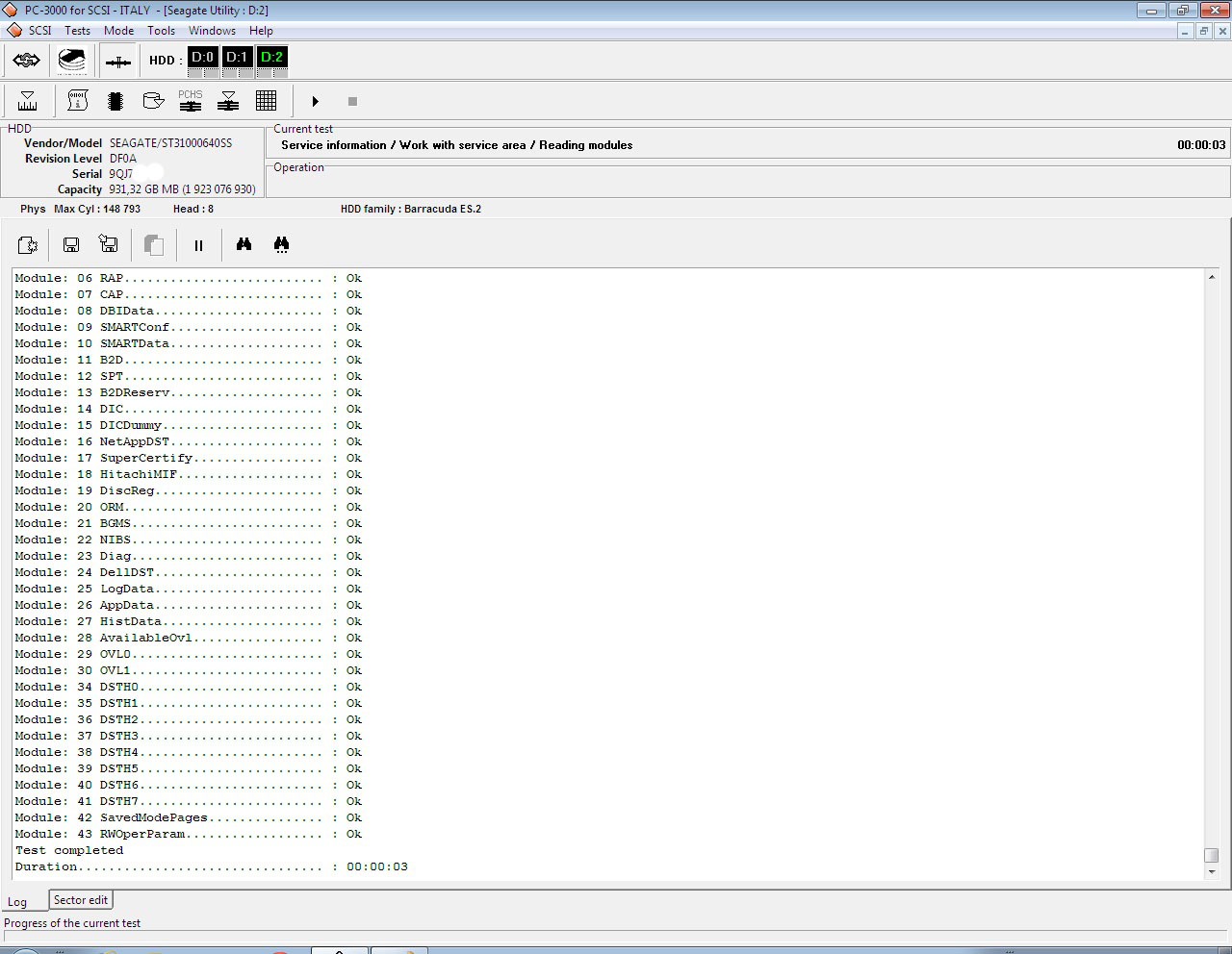

Do anybody faced issue cloning seagate barracuda ES.2 1 TB ST31000640SS ?
pc 3000 scsi (not with ASPI settings) can read sectors from utility only...
i have tryed 3 controllers but i can't clone...drives are good but hungs any cloning software and pc3000 SCSI too..

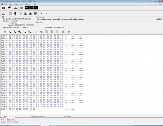

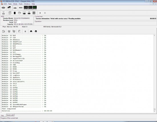

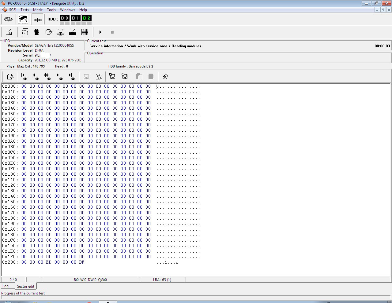

In utility: correct capacity, can read sectors
in DE: wrong capacity (488 MB ) can't read sectors
