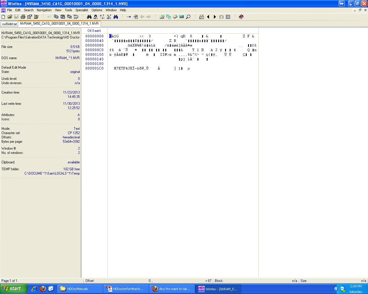

I just saw the post by Moltke. Here's the NVRAM:
 Post subject: Re: Any Pro want to take a crack at this drive?
PostPosted: January 15th, 2014, 9:37
Joined: October 24th, 2005, 17:04
Posts: 242
samick
So what is there to see? :shock:
upload to somewhere *. bin file NVRAM
