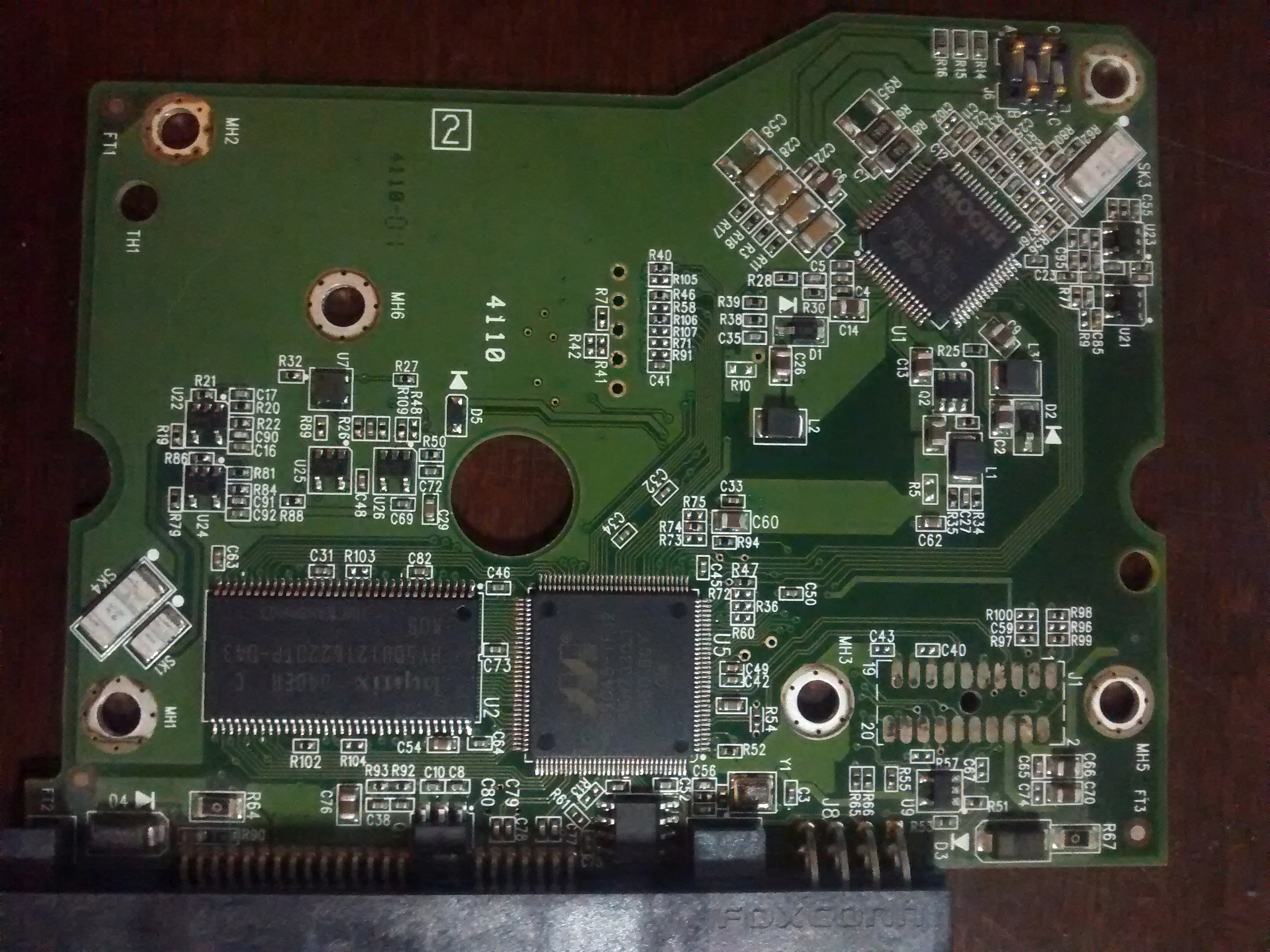

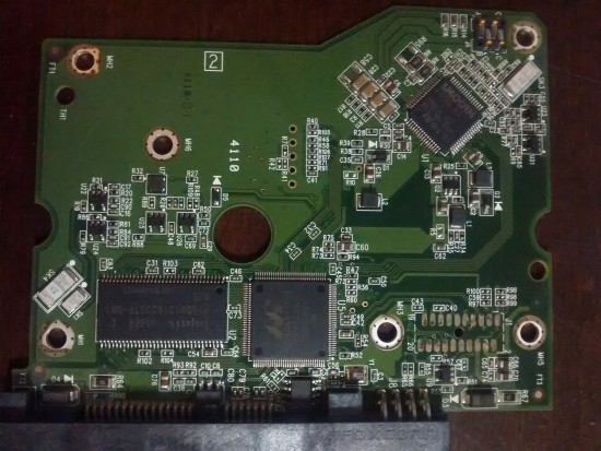

I've attached a pic of the PCB (2060-771642-003 REV A).
Hmmm.. I decided to do the little I know of in terms of obvious suspects before sending this, but D3 and D4 check out ok. But checking the other diodes I see D1 at about 200mV but reading ~1V when reverse-biased. Not good, I think.
Thanks again for any pointers you can offer.

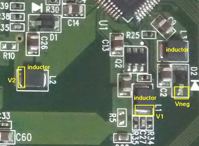

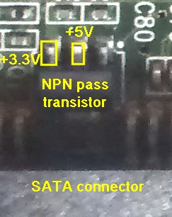

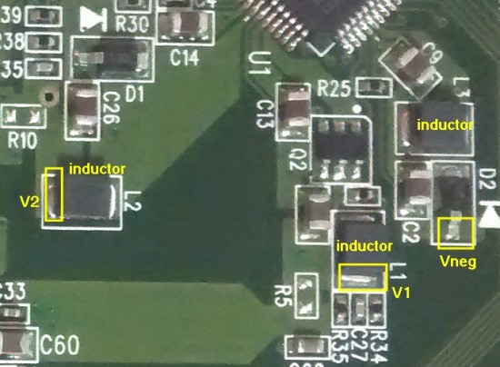

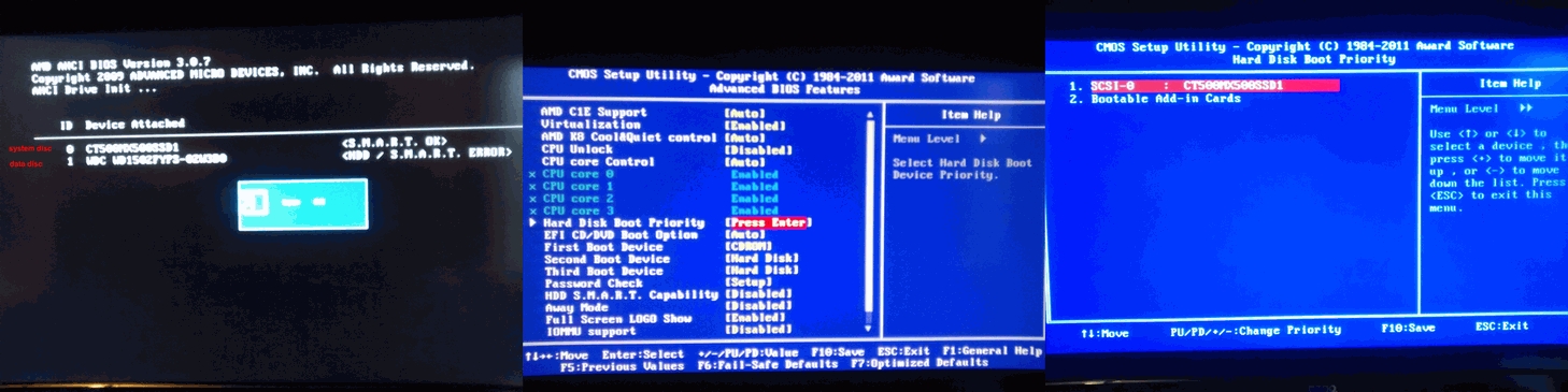

If your drive doesn't spin, then it could be because your drive is configured to Power Up In Standby (PUIS), as has already been suggested. In such cases the drive may still be detected by BIOS, although sometimes the model number may be blank. CrystalDiskInfo would show some ID info, but not the SMART data. What does it show?
I doubt that the PCB is at fault, but measure voltages V1, V2, Vneg, and +3.3V. Don't short adjacent pins, as catastrophic damage may result.
Note that Vneg may come up very briefly to -5V after power-on, but the MCU will probably switch it off when it fails to detect the preamp. That's normal behaviour for some PCBs.

1. Sorry if there's been a misunderstanding wrt the CrystalDiskInfo issue. To be explicit, I was referring to the historical "Crystal Disk logs on the system disc [that] don't show any S.M.A.R.T. anomalies"; CrystalDiskInfo can't of course access the current state of the data drive that isn't working.
But I should have attached the logs anyways, so here they are as a zipped folder.

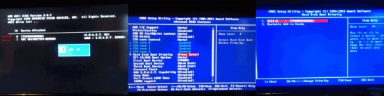

2. I also attached an image showing the data disc "disappearing" during the BIOS process.

(You'll note from the 1st screenshot in the attached image that he BIOS does show the model. As for CrystalDiskInfo , as mentioned it doesn't detect the drive.)

5. Thanks very much for the clear instructions on what to measure - that's great. (Also, since you didn't mention the D1 readings, could I ask for a brief explanation of why it wouldn't be relevant? To this amateur, voltage drops in both directions signifies a failed diode.)

In-circuit measurements are not always conclusive. Not only are you measuring the resistance of a particular component, but you are measuring everything it is connected to. In this case your meter is seeing the resistance of the load at V2 via inductor L2. That is, you are measuring the resistance of the MCU, not just D1.
Does CrystalDiskInfo see your drive if you install the PM2 jumper? Is there any difference if you connect the PCB on its own, including the jumper?
I suspect that the drive may have a head or preamp fault (assuming that the firmware tests these components before spinning up the drive). It could also be a bad motor controller.
