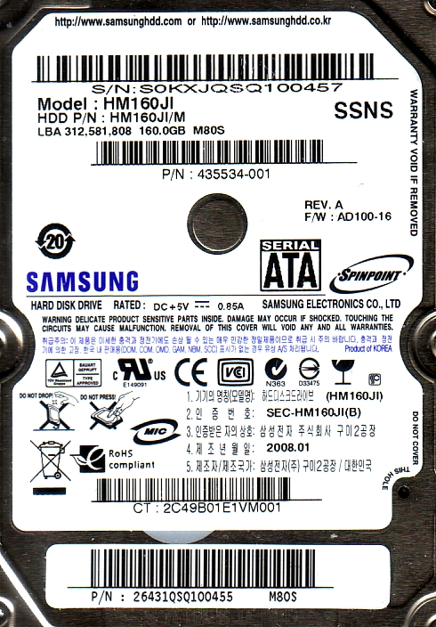

I have a USB/SATA bridge connected to the drive to power it. As for the drives history, I am not too sure. I assume it was in a laptop or something. Here is more info on the drive provided by the image.
Here is more terminal log of more commands I searched and entered to see what would happen.
