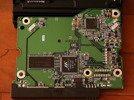

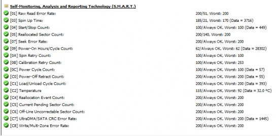

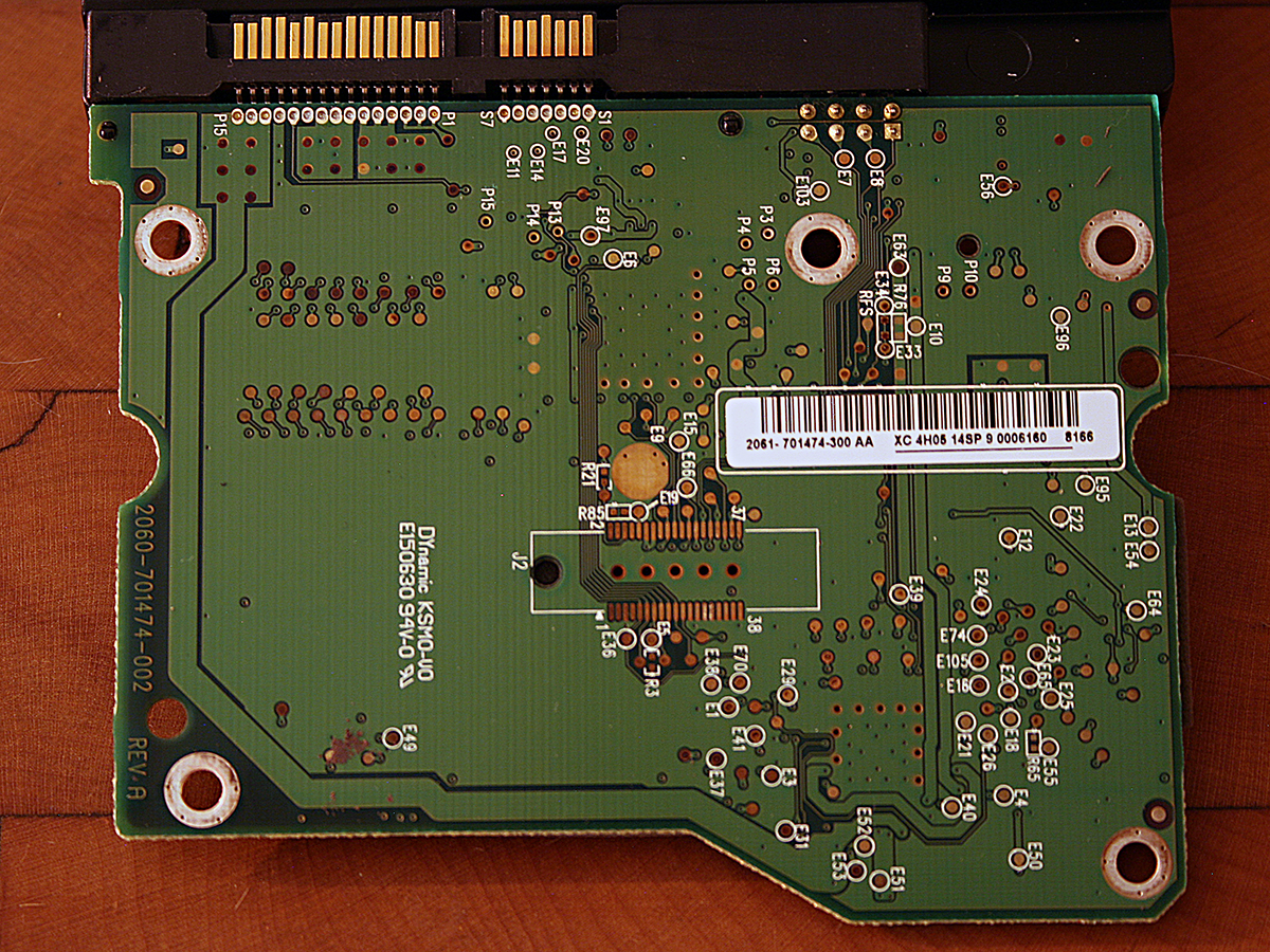

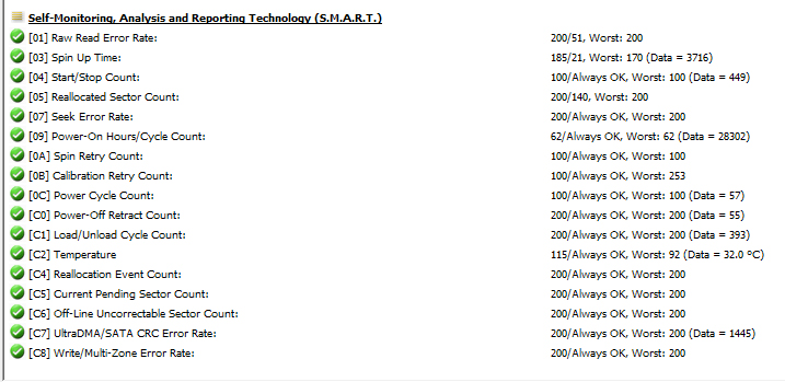

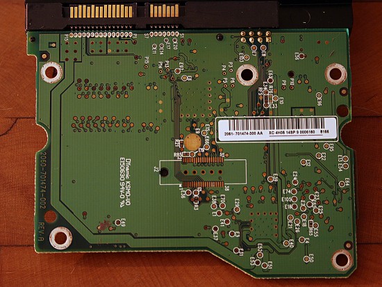

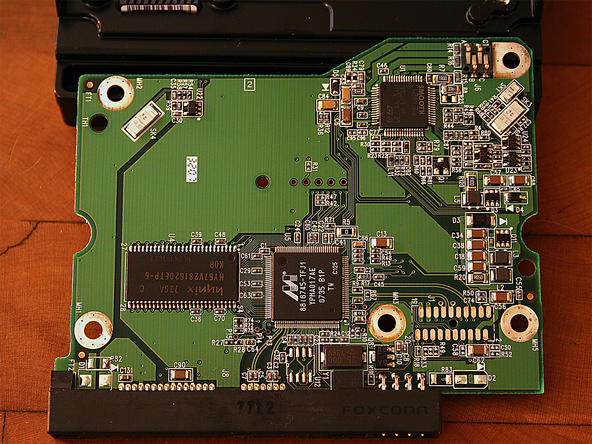

Hello everyone. A friend of mine handed me a headache today, namely a Western Digital WD10EACS-00C7B0 1tb Green HDD Revision 01.01B01 that would randomly drop offline and not be accessible. I hooked it up to my workstation via SATA 3Gb/s and when power is applied, the drive does spin up, followed by the standard sound of the arm working. A few seconds later the drive will appear in Windows explorer, then disappear. The same goes for storage management in admin tools, and when running Active@Partition Recovery. It's never up long enough for me to access it or run a test. Strangely though, the drive is shown in HWiNFO32 and Corsair LINK software, as well as it's SMART status which seems ok. The PCB itself doesn't have any visible damage which leads me to believe there is probably something wrong with the firmware. And to add insult to injury, i see this PCB is lacking a bios chip, so a board swap isn't on the menu.
Here are some photos of both sides of the PCB, and the SMART status from HWiNFO32.
Soo... what do you guys think? I have no problem swapping boards, soldering bios chips, or pretty much anything else that can reasonably be done by hand, but I have a feeling this is something that is beyond my ability. I hope there is something stupid that I carelessly forgot to check out, because this drive has the last 6 years of family photos/video, and if prices to have this professionally repaired are even remotely in the same ballpark as a drive I had Ontrack do the recovery on about 10 years ago, then she'll just have to deal with the fact that they're all gone. If only she had listened to me always telling her how she needs redundancy in order to ensure this doesn't happen.
Any help would be greatly appreciated.
Thanks in advance,
-Andrew
