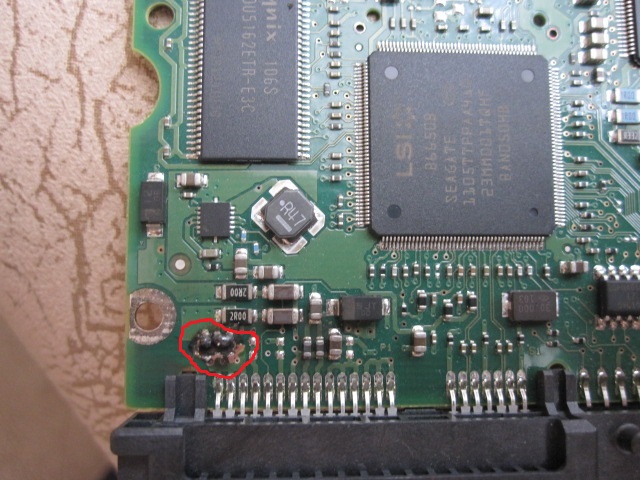

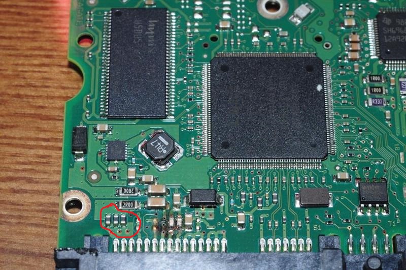

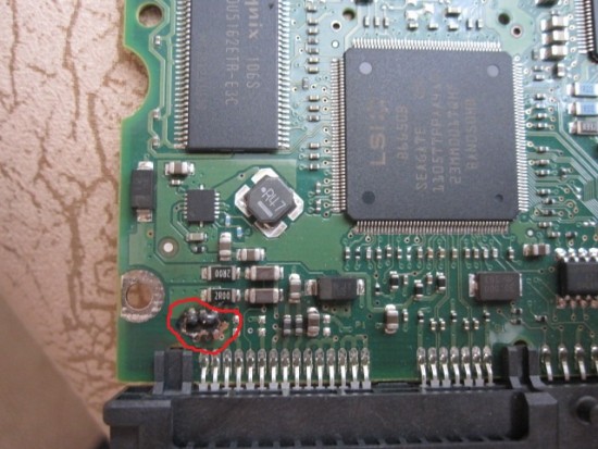

Prompt what this kompanenty and their denomination

100617465 REV B
 Post subject: Re: Seagate 2tb HDD
PostPosted: January 17th, 2014, 15:57
Posts: 17328

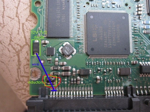

The circled components are probably inductors, but the layout of the supply traces is odd. In any case those components appear to related to the 12V supply whereas the darkened area to the right suggests that the drive may have sustained damage to its 5V components.

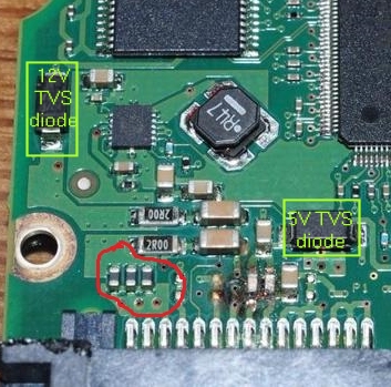

Did you measure the resistances of the two TVS diodes?

I have the right side of all good, that's just burned these elements

and now do not know what elements should be there and what they can be replaced

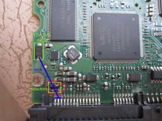

Those are the inductors for the 12V supply. Your drive has sustained an overvoltage on the 12V input, so please check or replace your PSU. The 12V TVS diode will be short circuited, so remove it.
You then need to run an insulated wire link between the 12V pins (13 - 15) at the SATA power connector and the cathode of the diode. The cathode will be marked with a "v" on the PCB. Confirm that there is no short circuit across the 12V input after performing your repair.

It's in my external HDD connected children by mistake the power supply from the laptop)))

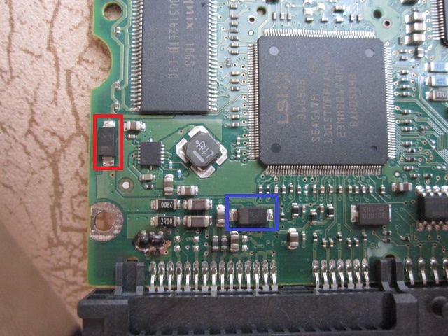

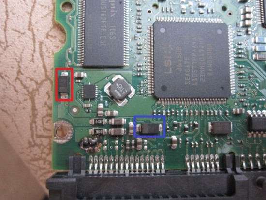

When checking the tester marked red diode current flows. A marked blue no.

The 12V diode (red) is short circuited. Remove it. Replace it with an SMBJ12A if you want continued protection.
The function of the inductors is to filter high frequency noise.
