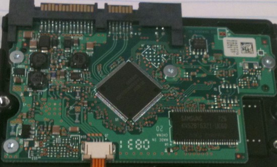

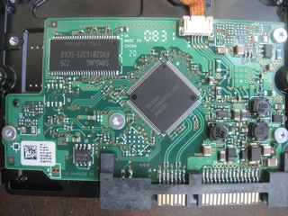

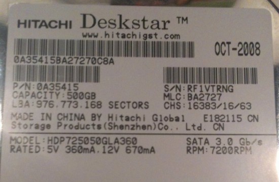

I need to find a PCB for this drive. Appreciate any help locating. Bought similar model HD on Ebay but slightly different PCB unfortunately, so no joy. Can't find anything current on Ebay and am not sure of PCB model #. Is it printed on white sticker? Anyway, have tried googling all numbers from sticker and chips but still no luck.
White Sticker:
0A29778
BA2798-
Z2R837
0A53

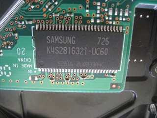

rectangular chip:
Samsung 725
K4S281632I-UC60
printed on PCB:
110 0A900026 01

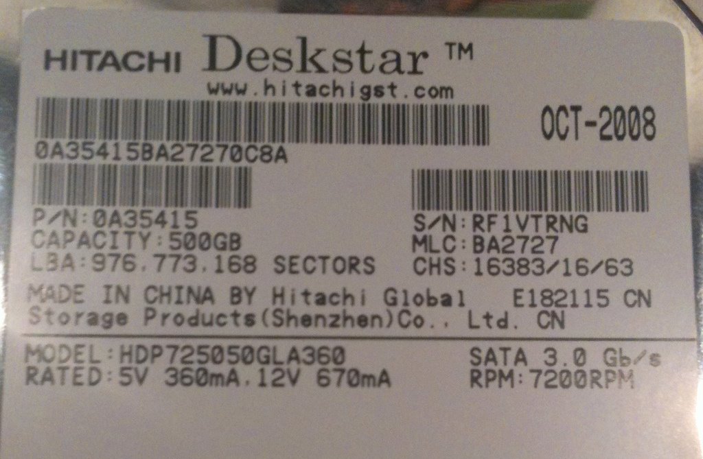

Re: Need PCB for Hitachi Deskstar 500GB HDP725050GLA360
September 8th, 2011, 19:54
pic of label

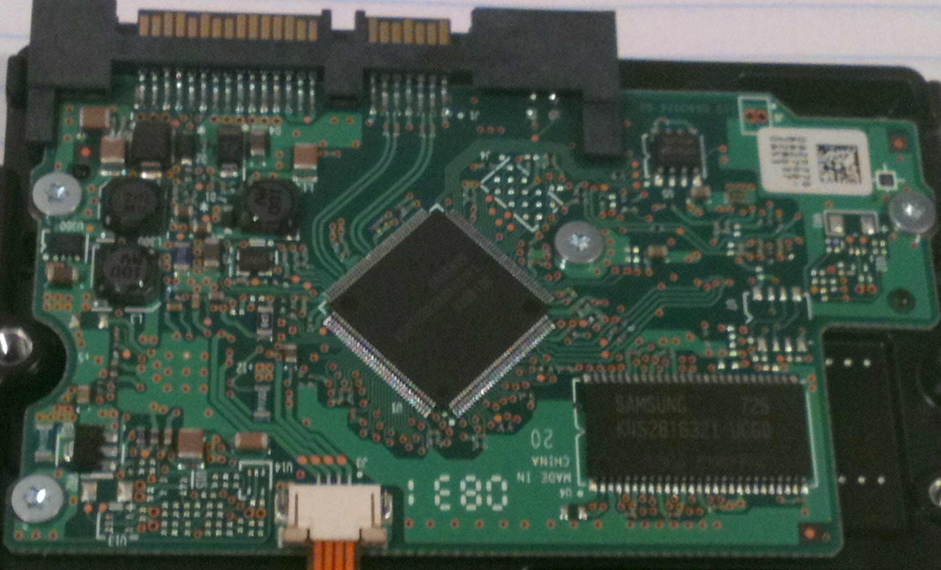

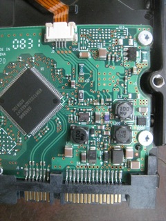

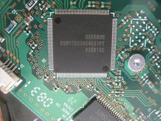

September 8th, 2011, 21:41
Pictures attached are close ups of chips on PCB

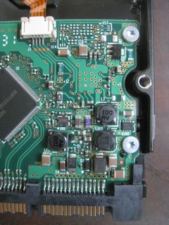

September 8th, 2011, 22:13
The diode seems like it may be burnt, but cannot quite tell. Need a better picture, preferably taken from up top.
Search for diode here on the forum to learn how to test using a multimeter.
September 8th, 2011, 22:40
Will do, thanks for the suggestion. Just gotta locate my multimeter.
Will also try to get a better pic - been farming the pics out to my wife after failing with my original iphone pics.

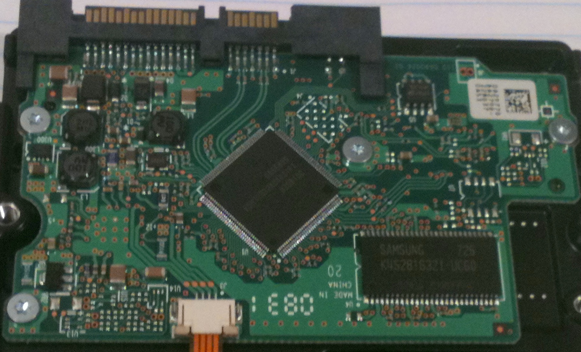

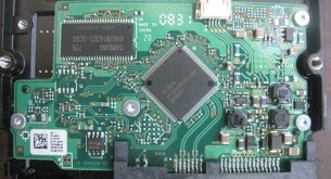

September 9th, 2011, 13:36
Various pics of the diodes, etc.
September 9th, 2011, 22:38
Cannot locate test leads for multimeter! :(
It's got the clamp leads on it which makes testing small diodes difficult. Have ordered replacement set from Mouser, but the diodes don't look physically burned out to the naked eye. Sorry about the small pix.
Anyone on the board do PCB repairs and wants to take a look at this one? For pay, of course. :)
September 12th, 2011, 0:36
I"ve seen posts about flashing firmware on PCB's to make them work with different hard drives. I have an almost identical PCB from the same model hard drive. Can I flash the firmware to make it work with this drive?
September 12th, 2011, 23:29
"Almost identical" is not enough to say if it will work or not. Typically, matching the first two lines on the PCB's white label should make board compatible. This is just the starting point for this. Then you have to make donor PCB work with the drive by transferring adaptive information.
September 16th, 2011, 4:25
Can you hear some "buzz" noise from the drive? If yes, forget about PCB exchange - most likely the diagnose is "head stiction".
September 16th, 2011, 12:48
No buzz. Drive just did not spin up at all. With donor PCB (from board with same two lines on white label), the drive would spin up but would not read. Tried swapping ROM chip from original board to donor board, but same result.

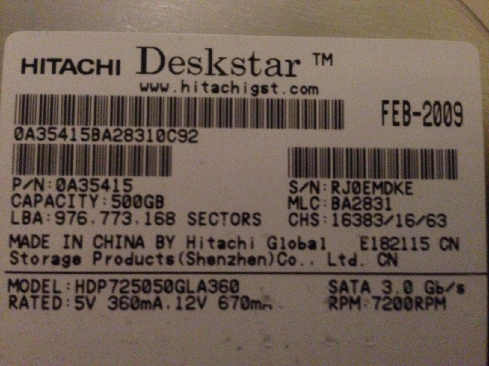

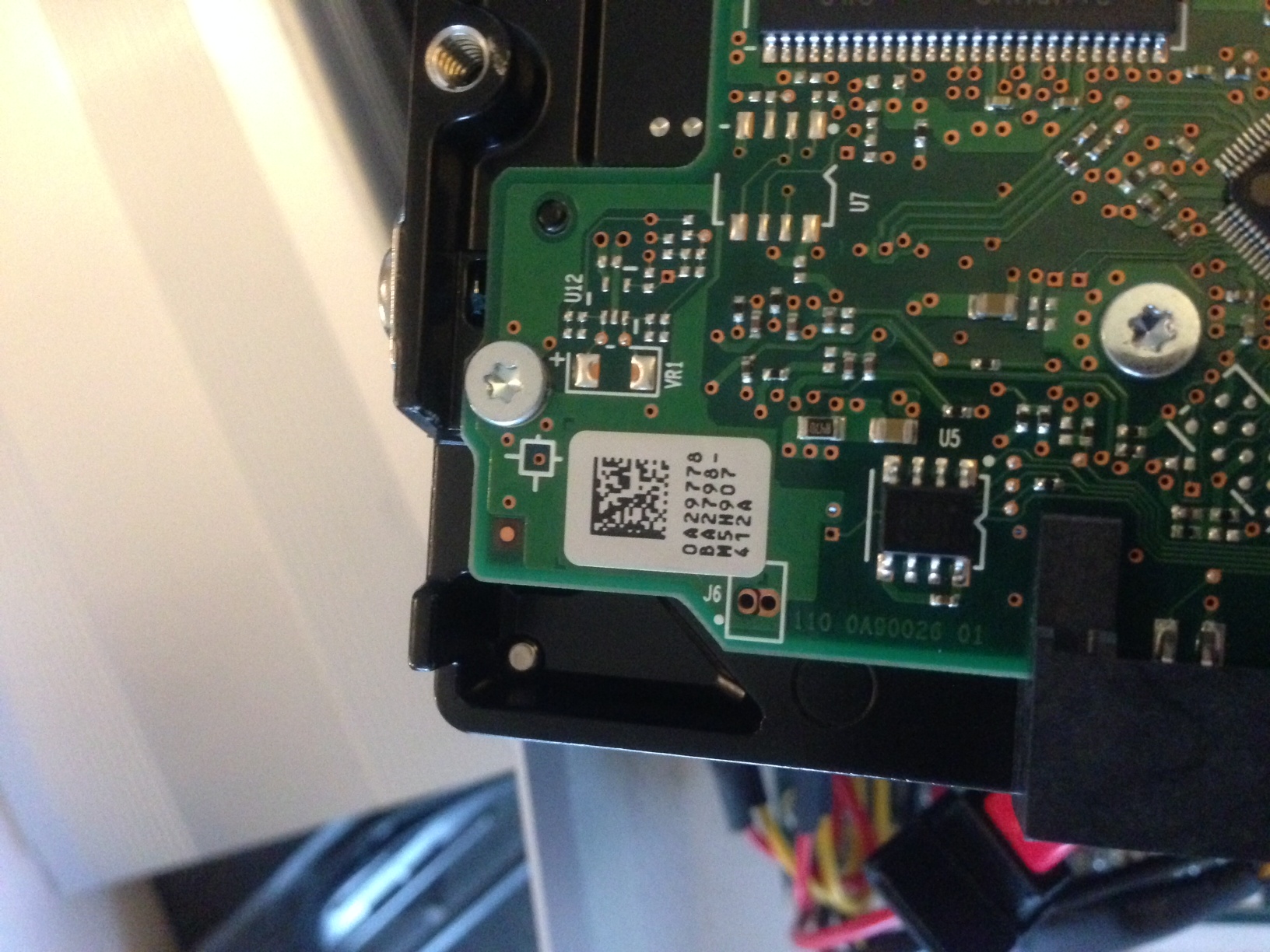

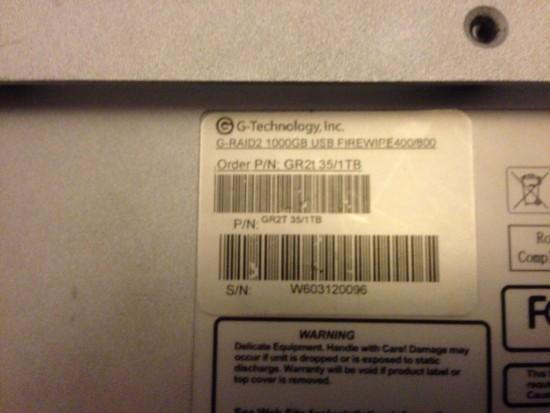

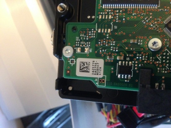

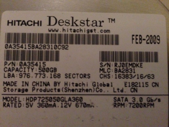

Now, what I need to know is, what are my options? I have read alot of forums where people have had success by replacing PCB Boards and ROM Chips and the drive has worked again. I have also read other stories where it hasnt and the only option is then data recovery. I have uploaded pictures of:
G-RAID Sticker at the bottom of the Enclosure
Sticker on top of the HDD
Sticker on the PCB Board
Please please can ANYONE help?!
Taj
PCB
HITACHI DESKSTAR 500GB HDD (Feb 2009)
G-RAID 2 1TB
January 5th, 2014, 8:11
Is this a test? :shock:
The PCB is missing the NVRAM chip!
