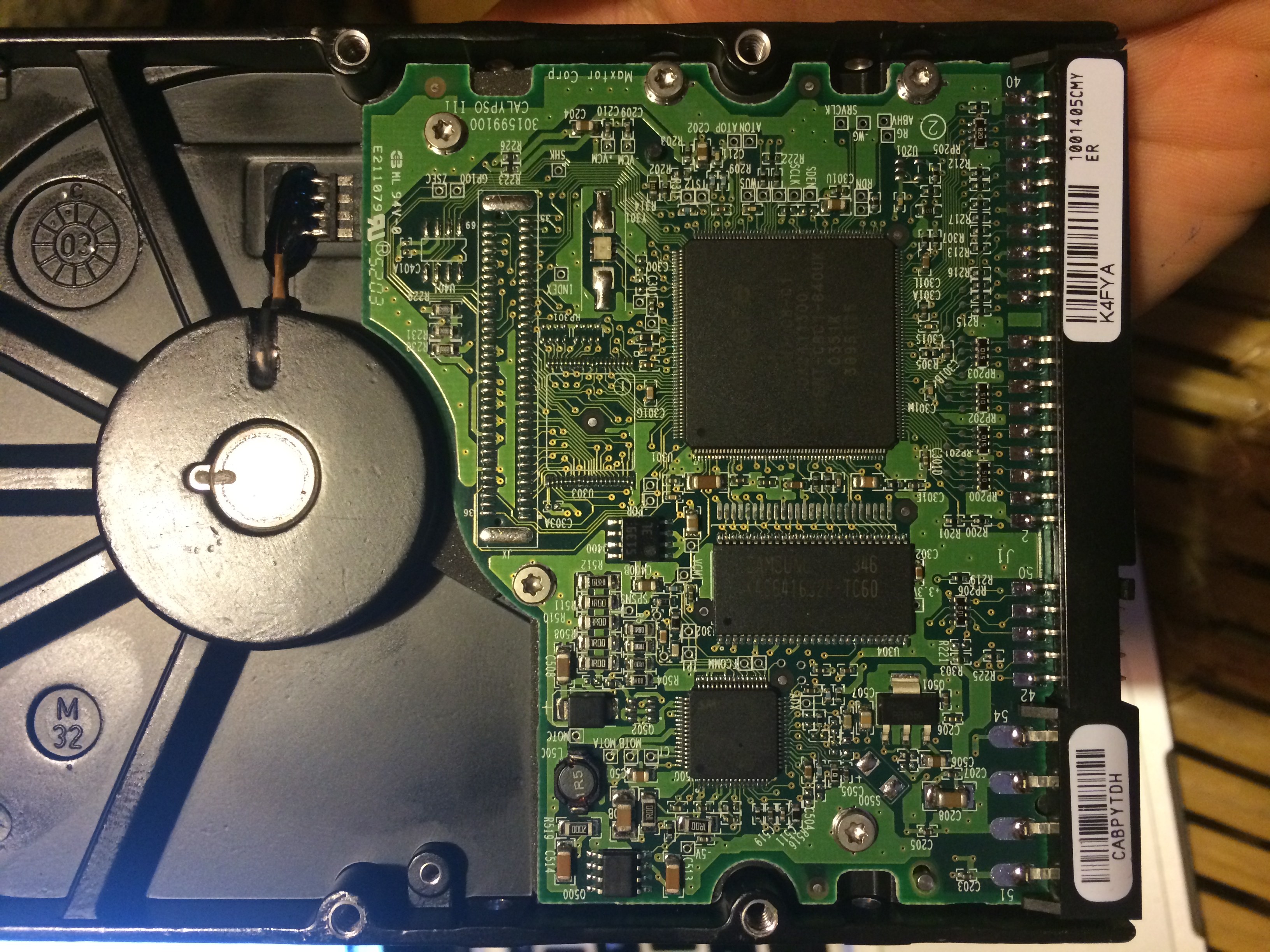

Another question, that is the match for K4FYA ? I have a label on the PCB with K4FYA written on it. The donor PCB needs to be K4FYA as well ?

can you post an image of your PCB?

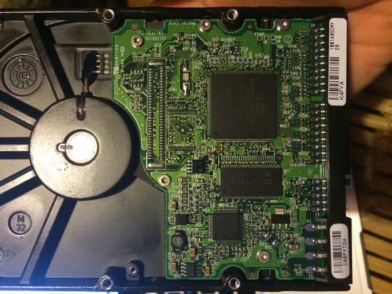

Here is the PCB :

I'm not 100% sure, but I think your TVS Diod, that might be shorted due to the voltage overload would be located left of the Smooth chip above the coil on the bottom left of the image. Its a little black component.
If that is the problem, snipping it off should get the drive working again and all you need to do is replace the component.

Is it the component between MOTC test point and C508 ?
If is it this one, I got 12V on this component...

Your PCB has no external ROM chip , so you can use other xxFYA PCB that:
1. has no external ROM chip
2. MCU (the big chip) matches yours ( as I remember C8-C5)
3. PCB model number , printed on the lower part of the PCB, matches too.
If that is indeed a 12V diod then the board could be dead. Is there anyway to remove the board and see if there are any other components on the other side? There should be a 5V diod that would protect the drive. If this drive does not have one, then a over volt would have damaged all the components on the drive, it might have even fried the pre-amp inside the drive itself.

In my case, my PCB# is 301599100 ? MCU is C8-C1 ?
 Post subject: Re: DiamondMax 9 Plus PCB swapping, good idea ?
PostPosted: January 7th, 2014, 4:37
Posts: 927
Location: uk
Hi, it looks like ARDENT C8-C1 which you can also find on 80gb drives with the same pcb.
There is just a very very small chance that the coil L50C has gone open circuit. Test it for continuity just in case.
