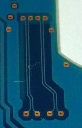

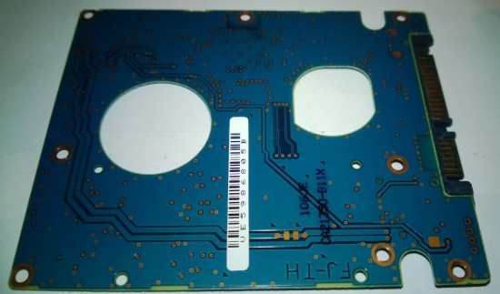

fzabkar, could you please show where can I find the write channel?

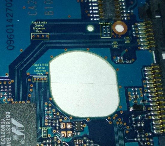

 Post subject: Re: Fijitsu MJA2250BH firmware issue
PostPosted: February 18th, 2014, 16:34
Posts: 17343
I think the differential pair with the visible terminators is the read channel. The pair on the left would then be the write channel.
BTW, you need to measure the voltages between each pin and ground, not between each pin in the pair.
