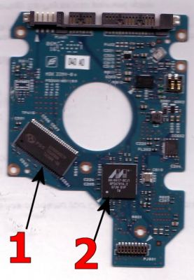

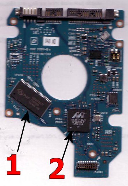

Ok - i found an exactly identical drive, exactly the same! Everything other than the serial # match.
I swapped the pcbs and the drive powers up now, makes a faint but repeated ticking like the head is trying to read then try again and again. It sounds like the PCB is simply not compatible this way. See the photo attached - which is the chip i need to swap? Chip 1 or 2 ?
Thanks.

Hello zed, next to the M Chip right hand, looks like an Atmel chip, at some models thats could be the ROM wich u need to unsolder and solder on donnor, i cant see very good on u photo, check t

Thanks beto, i swapped the small 8 legged chip and it fixed the problme! Success! Thanks all.

Where is the small 8 legged chip at the photo ? thanks
 Post subject: Re: How to swap a Toshiba PCB ? Any tips?
PostPosted: August 27th, 2008, 2:21
Joined: April 17th, 2008, 8:52
Posts: 52
Noth East od the M chip.
