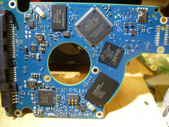

Got this drive in and PCB is "dead".
Well I say dead, it does not spin up drive or give any terminal output and stays BSY.
I have a good drive and that PCB gives terminal output and comes DRDY, whether it's connected to the HDA or not.
I swapped the ROMS and then both PCB's exhibited the same symptoms.
I'm guessing that the ROM tries to access the flash part of the drive and recognises it's not native?
Attached is a photo of the duff PCB....
Anyone come across this and/or offer some suggestions?

the chip at right upper corner near hda connector says it all... :mrgreen:
 Post subject: Re: Seagate 1Tb "SSHD" dead PCB
PostPosted: January 22nd, 2014, 9:13
Posts: 4000
Why, because it has a "P" in white marker written on it? that's what it looks like to me, not a blown chip.
PostPosted: January 22nd, 2014, 9:20
Here I see like a corner is damaged and so the left side but I am on a mobile device and enlarging doesn't help.
Without any other info that's all I could see.
PostPosted: January 22nd, 2014, 9:25
No, thats the "ROM" chip, which has been off/on the PCB.
I wrote the "P" on it for "PATIENT" when I swapped them over (to keep track and avoid confusing them) and a mark on the corner to highlight pin 1, and it's fine :-)
The "DONOR" chip has a "D" on it ;-)
PostPosted: January 22nd, 2014, 10:29
Posts: 3598
Location: Chicago
I suggest you also move the NAND chip
Although the problem could be in it
I'll give it a shot!
Thx :-)

Before hacking into any of the chips, I would at least measure the onboard supply voltages.

Take care when read or writing the "ROM". The "B" version has a supply voltage range of 1.65V - 1.95V, with an absolute maximum of 2.35V. The "VCC + 0.4" spec for the "B" part is ambiguous, but the datasheet for the "V" part makes this clearer.
W25Q80BWIG, Winbond, 8Mbit, serial flash memory, SPI, B = 1.65V - 1.95V:
http://www.nexflash.com/NR/rdonlyres/A4 ... 5Q80BW.pdf
Absolute Maximum Ratings
Parameters      Symbol  Range
Supply Voltage  VCC     -0.6 to VCC + 0.4
W25Q80V, Winbond, 8Mbit, serial flash memory, SPI, V = 2.7V - 3.6V:
http://elinux.org/images/f/f5/Winbond-w25q32.pdf
Supply Voltage  VCC     -0.6 to 4.0
The supply voltage for the SDRAM is also 1.8V, with an absolute maximum of 2.3V. Therefore you could kill more than just the ROM if you attempted to program it in-circuit via a chip clip.
H5PS5162GFR, SKhynix, SDRAM, 1.8V, 32Mx16, 512Mbit:
http://www.farnell.com/datasheets/1580326.pdf
http://www.skhynix.com/inc/pdfDownload. ... _H5PS518(6)2GFRseries(Rev1.8)_130628.pdf
Absolute Maximum DC Ratings
Symbol       Parameter                               Rating
VDD          Voltage on VDD pin relative to Vss      - 1.0 V ~ 2.3 V
VDDQ         Voltage on VDDQ pin relative to Vss     - 0.5 V ~ 2.3 V
VDDL         Voltage on VDDL pin relative to Vss     - 0.5 V ~ 2.3 V
VIN, VOUT    Voltage on any pin relative to Vss      - 0.5 V ~ 2.3 V
Stresses greater than those listed under "Absolute Maximum Ratings" may cause permanent damage to the device.
BTW, I don't understand why the patient ROM needed to be physically transferred to the donor PCB. Can't PC3K program the ROM in situ on the donor PCB, and wouldn't you have backed up the patient ROM in a chip reader ASAP as a matter of course?
Assuming that the PCB is unsalvageable, could you use a regular SATA PCB (not SSHD) and extract the adaptives from the patient ROM and transfer them to the donor? Would the SA modules be compatible, and, if not, could you use an appropriate loader to circumvent any incompatibility?
As for the voltage test points, I can see at least 4 inductors/coils. Two are located near the SATA power connector, and another two near the motor controller. These are the landmarks for the onboard switchmode DC-DC converters. Measure the voltages on the load side of each coil. Also confirm the Vcc supply on pin #8 of the ROM.
There is also a 5V TVS diode, but if it were shorted, then your PSU would have shut down.
PostPosted: January 24th, 2014, 5:37
Posts: 17314
There is a 3.3V linear regulator (1L05C33) near the NAND flash.
ST1L05CPU33R, ST Microelectronics, LDO regulator, 3.3V, 1.3A, marking 1L05C33:
http://www.st.com/web/en/resource/techn ... 186925.pdf
I suspect that the LX7169 device generates a Vcore supply for either the MCU or the flash controller, or both.
LX7169, Microsemi, 3A Step-Down Converter, 3V - 5.5V input:
http://www.electronicsdatasheets.com/do ... format=pdf
I don't know what the two A74 devices do, but I suspect that they, together with the "ET31" device, may consitute a preamp supply of some kind. "ET31" looks like a transformer.
LMV931MG, Texas Instruments, single, 1.8V, RRIO Operational Amplifier, SC70 package, marking A74:
http://www.ti.com/lit/ds/symlink/lmv931-n.pdf
The "6855A" device appears to constitute a DC-DC converter of some kind, but I can't identify the IC.
