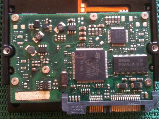

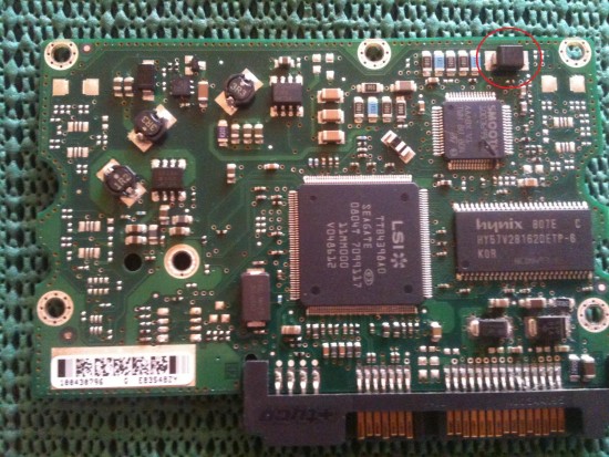

hi guys,
as the subject states i have a ST3500630AS. blown smooth chip,
found replacement via drivestar.biz
replaced pcb and transferred rom chip. still wont spin up.
any suggestions. i thought maybe tvs diodes but this is with the replacement pcb. drivestar state they send out pcbs that have been tested etc.
any suggestions??
many thanks

@Spitfire2678, if you could upload photos of your two PCBs, I could show you the voltage test points. It might also help to see which corner of the SMOOTH was damaged.

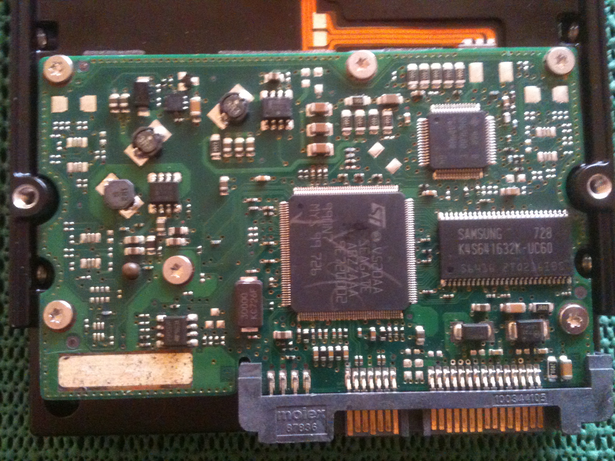

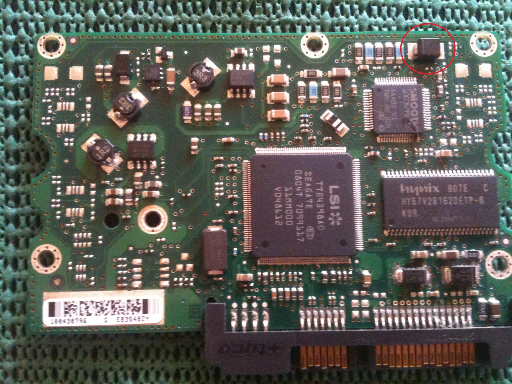

i will try mentioned options to see what i can discover. drivestar has responded to me and they are sending out another pcb. as i discovered even though pcb no matched my original pcb was slightly different as you will see in my attached pics. whether it makes a difference or not, not sure. but drivestar still sending replacement.
the hot air rework station i have seems to do a pretty good job. removing in one go and replacing. do you guys recommend cleaning rom chip pads before adding back the rom chip?
fzabkar, my pics attached. you should be able to see the smooth chip pin/s that are damaged.
the red circle was simply to illustrate to drivestar the part that was missing from drivestar pcb when compared to the original pcb

The MCU and motor controller chips are from different IC manufacturers, so I don't know if they are completely compatible. Hopefully they're just functionally identical second sources.
That said, the SMOOTH appears to be damaged on the side that controls the onboard voltage regulators rather than the spindle motor and voice coil, so one would have to wonder about the state of the preamp.
I would remove the PCB from the drive and measure the voltages at each of the 3R3 coils, and the voltage at pin #1 of the 8-pin chip adjacent to the 1R2 coil. Use a screw hole as your ground reference.
