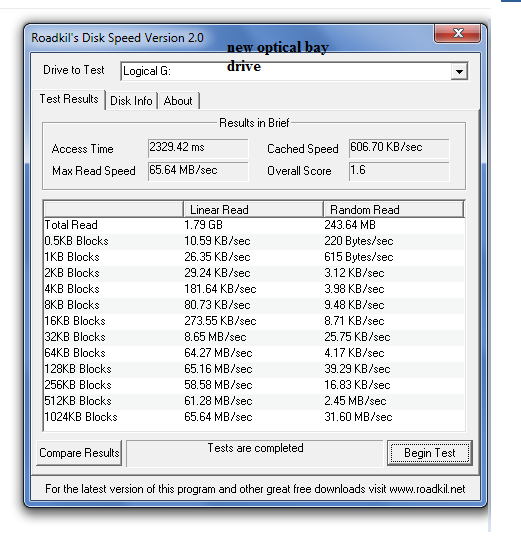

 Post subject: Got an HD Caddy for Optical bay, Disk performing very slow
PostPosted: February 11th, 2014, 16:55
Joined: February 7th, 2013, 2:52
Location: america
I recently got a hard drive caddy to put in my external hard drive instead of the CD ROM. Everything went well, it fitted in, but the speed i am getting is incredibly slow. Even opening folders takes up to 30 seconds.
I have attached the bench-marking screenshot for that drive, please suggest what could be the issue and what should i try, i have already cleaned the connectors and the hard drive works great when connected with a usb 2.0 cable as an external.
This is the hd caddy that i got - http://www.ebay.com/itm/290724142346
Here's the benchmarking result - http://s3.postimg.org/mcnmapqrn/image.png
File comment: benchmark

Hi, Have you:
a) upgraded the BIOS on the laptop
b) installed latest chipset drivers
c)installed latest rapid storage drivers or other storage drivers for you board/disk
d) searched on forums for the laptop/caddy/drive combination for others having the problem and possible solutions?
that would be my list of things to initially try.
Cheers
