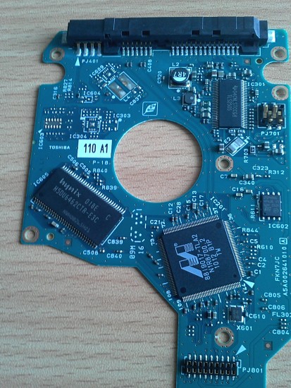

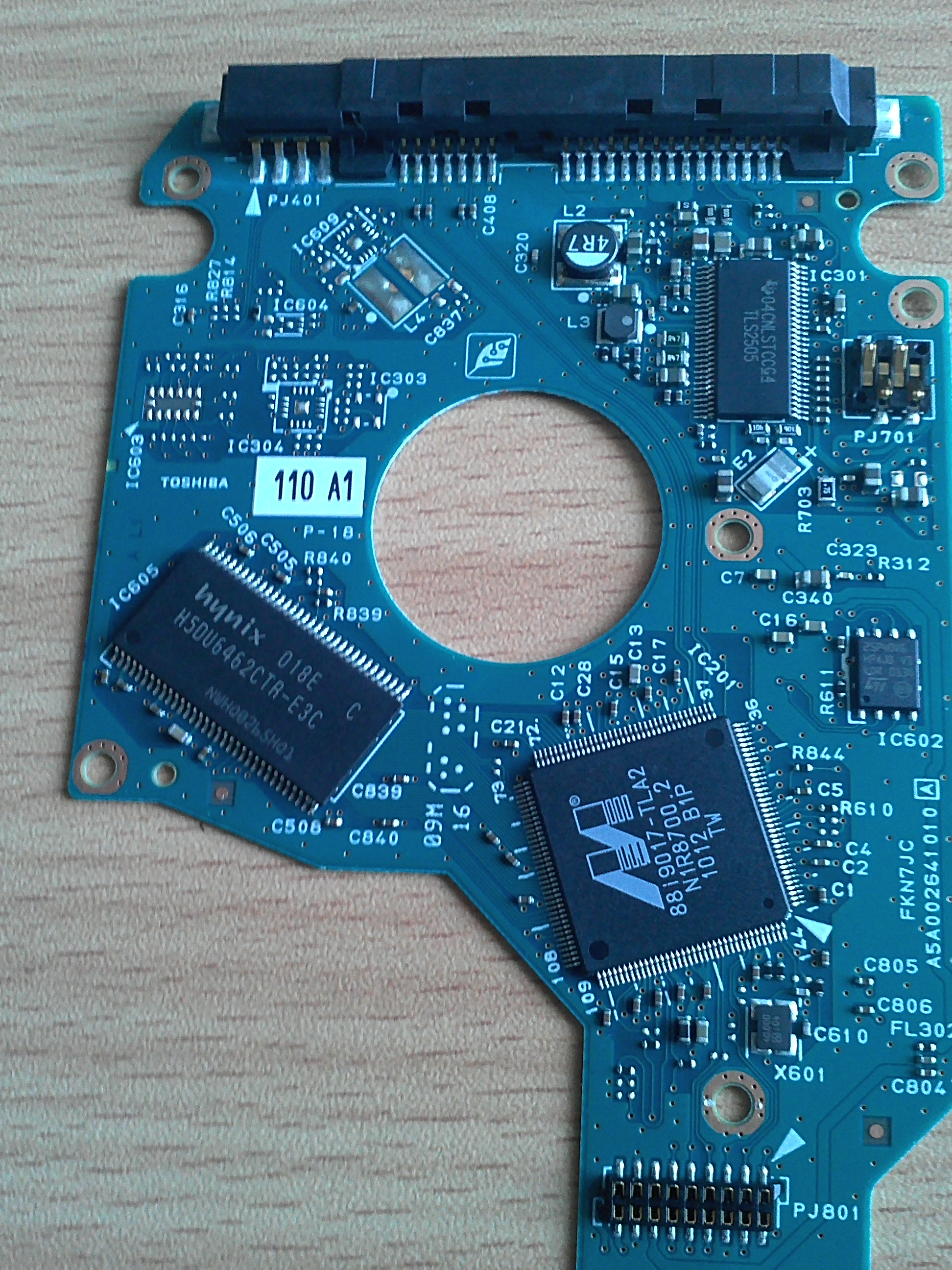

Hi Guys,
I’ve got a Toshiba MK6465GSX HDD2H81, Please see images attached.
The customer advised that the laptop it was in got some liquid spilled and stopped working.
I connected the drive and it looks like the PCB is not responsive and has some shortage on it.
I have a donor drive here but trying to see what would be my best method as i am not that familiar with Toshiba drives.
I have few questions in regards:
1. Is there a TVS chip in similar to 3.5” drives that i can remove to check if it will resolve the problem?
3. Does the PCB of a donor need a ROM transfer from original drive?
4. Where is the ROM in this drive?

ROM chip is "IC602" which contains data that is totally unique to each drive.
Be warned that these are particularly difficult chips to remove, and if it gets broken then it's pretty much "game over"

Measure the resistance of the fuse marked "S" near the +5V SATA power pins.
Measure the voltages between ground and each of the L2 and L3 coils. These will be the Vcore and Vio supplies.
Try reading IC602 in situ using an SOIC clip and programmer. Before you do this, confirm that there is no short between Vcc and ground (pins 4 and 8).

The S fuse was shorted but repairing it didn't help so more components were out of the game with the original PCB so i decided to swap the ROM.
All good now, i managed to repair the drive and currently imaging the data.
This one was a real pain - ooohhhhhh :-) sweating a lot today.
I found an old WD PCB with similar chip and practised on it.
Than I transferred the ROM into the donor PCB and the drive got power but now it had buzzing sound, so I opened it in a clean room and found that there is stiction condition.
I released the heads from the platters carefully and closed the drive, connected it to the DDP and it is working, beautiful.
It is currently imaging without any bad sectors so far.
I used 350 degrees on the rework station hot gun, the trick with this type of ROM is to heat it in a circular way around it for quite a while carefully from about 0.75mm distance and heat a lot also the centre of the ROM chip as it is using a plate of solder in the middle to attach it to the surface.
