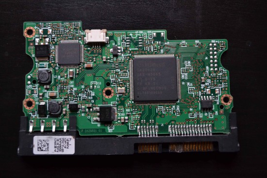

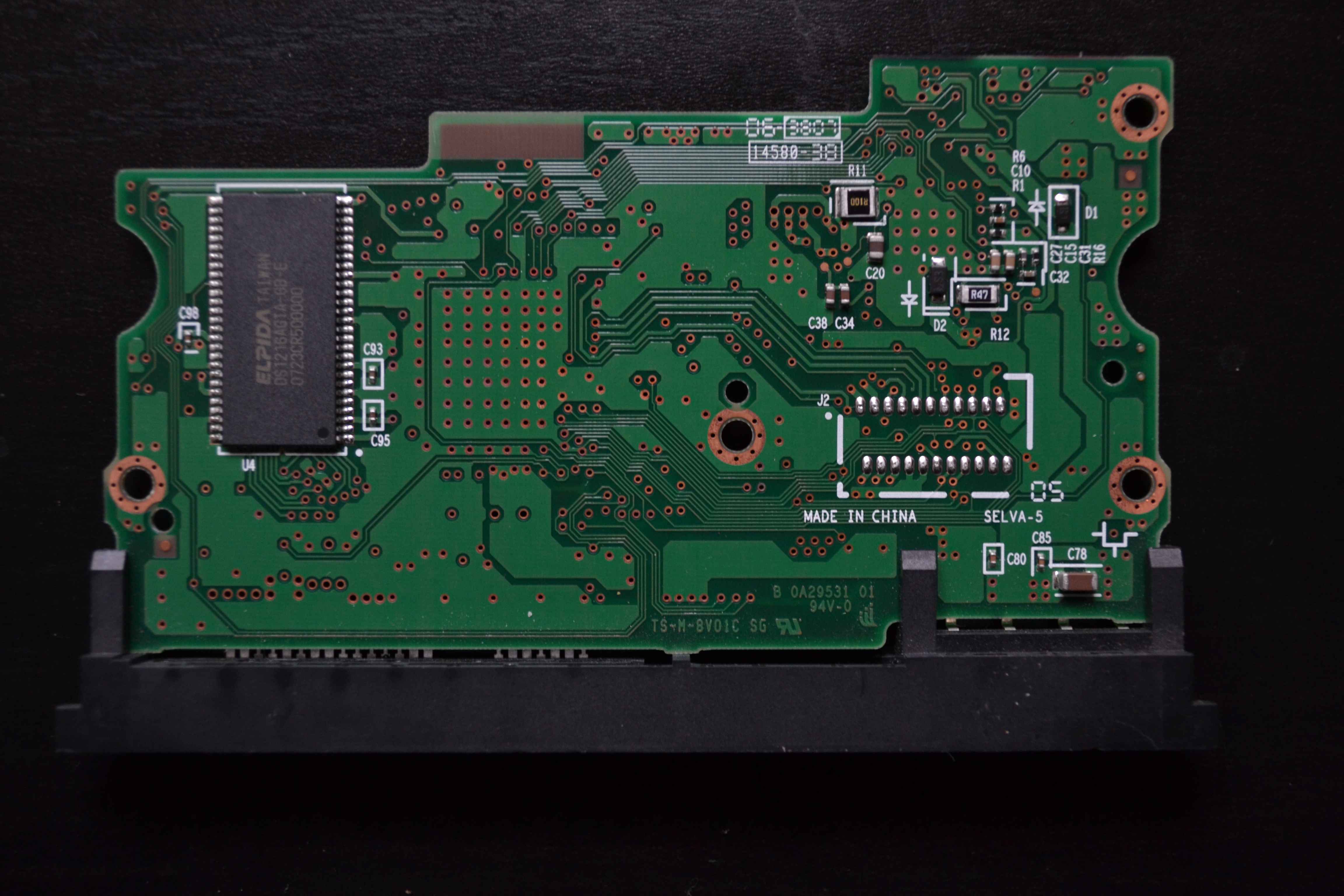

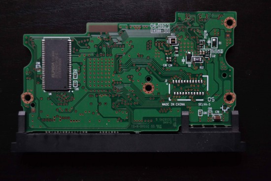

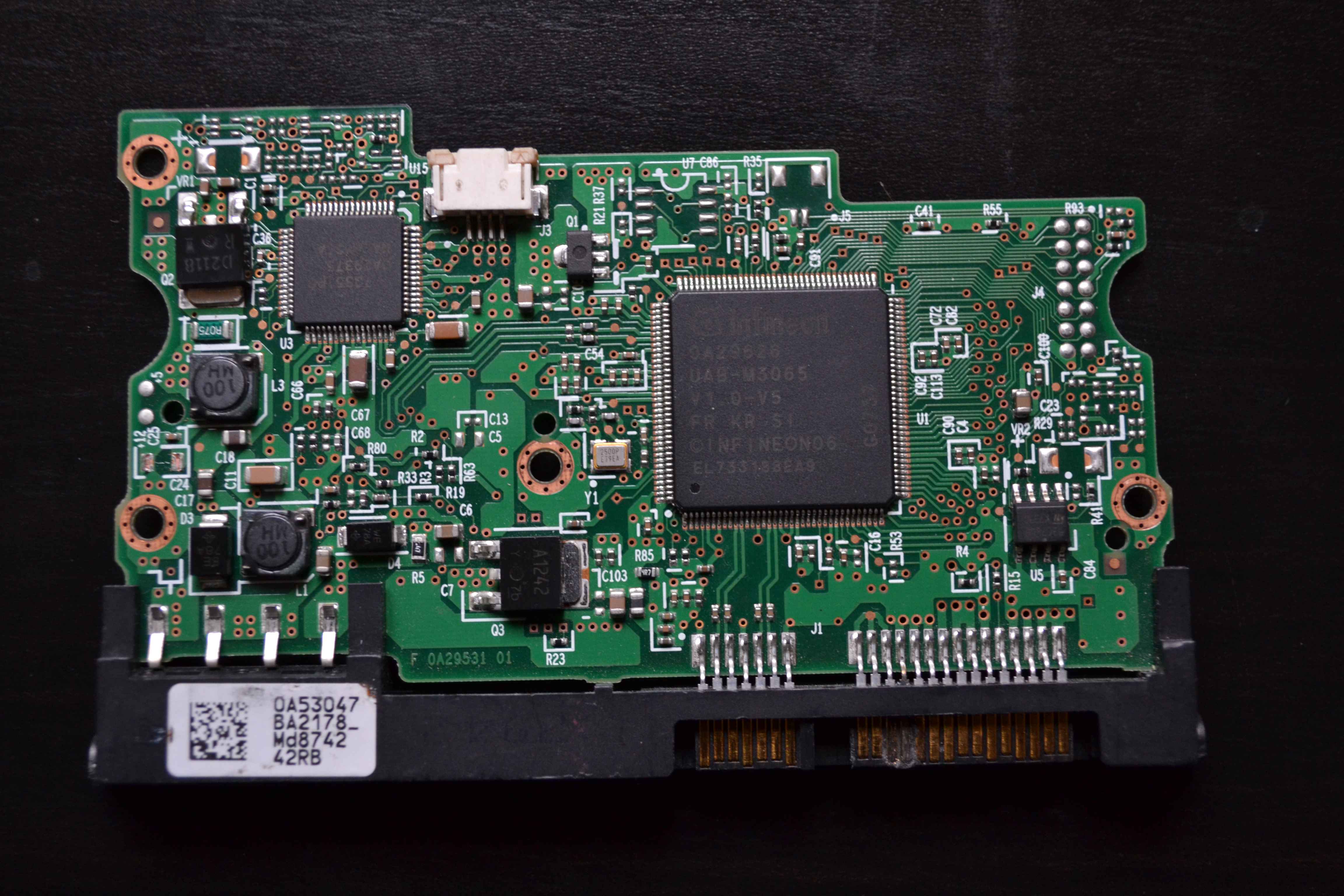

File comment: PCB Back
File comment: PCB Front

You should replace ROM, this Pcb has burned connectors.
So check your PSU / Cables as well.

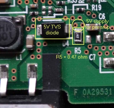

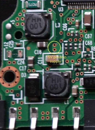

R5 should measure 0.47 ohms. Your measurements suggest that it is open circuit.

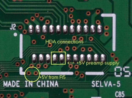

R5 is in series with the +5V supply to the preamp. Therefore I suspect that the preamp may be dead. Before installing your replacement PCB, I would first measure the resistance between ground and the HDA side of R5, with the original PCB installed on the drive.

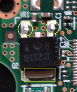

 Post subject: Re: First hard drive recovery
PostPosted: March 1st, 2014, 20:12
Posts: 17323

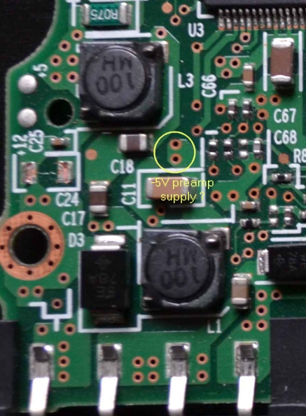

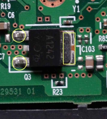

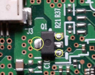

@Gumby, I would measure the following voltages with the PCB removed from the drive. Note that you could power your drive from the Molex connector.

from the single contact side facing down to the top left contact = 1.73
from the single contact side facing down to the top right contact = 1.06
download/file.php?id=7844
from the single contact side facing right to the left top contact = 1.02
from the single contact side facing right to the left bottomt contact = 1.70
download/file.php?id=7843
from the single contact side facing left to the right top contact = 1.70
from the single contact side facing left to the right bottomt contact = 1.00
download/file.php?id=7842&t=1
Measures 0
PostPosted: March 1st, 2014, 20:54
Joined: February 16th, 2014, 18:32
Posts: 10
Location: Okanagal Falls, BC Canada
I think my last message is awaiting moderator approval because I used links to the images you posted fzabkar. So instead I'll post my results without the images (fingers crossed any further messages aren't moderated also)
VR1
Q3
Q1
Cuk Converter - I'm not sure I am measuring this one correctly. I just tested using the two holes. I'm completely ignorant if I am supposed to be using a contact point somewhere else.
Measures 0

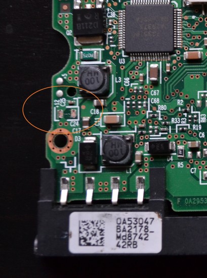

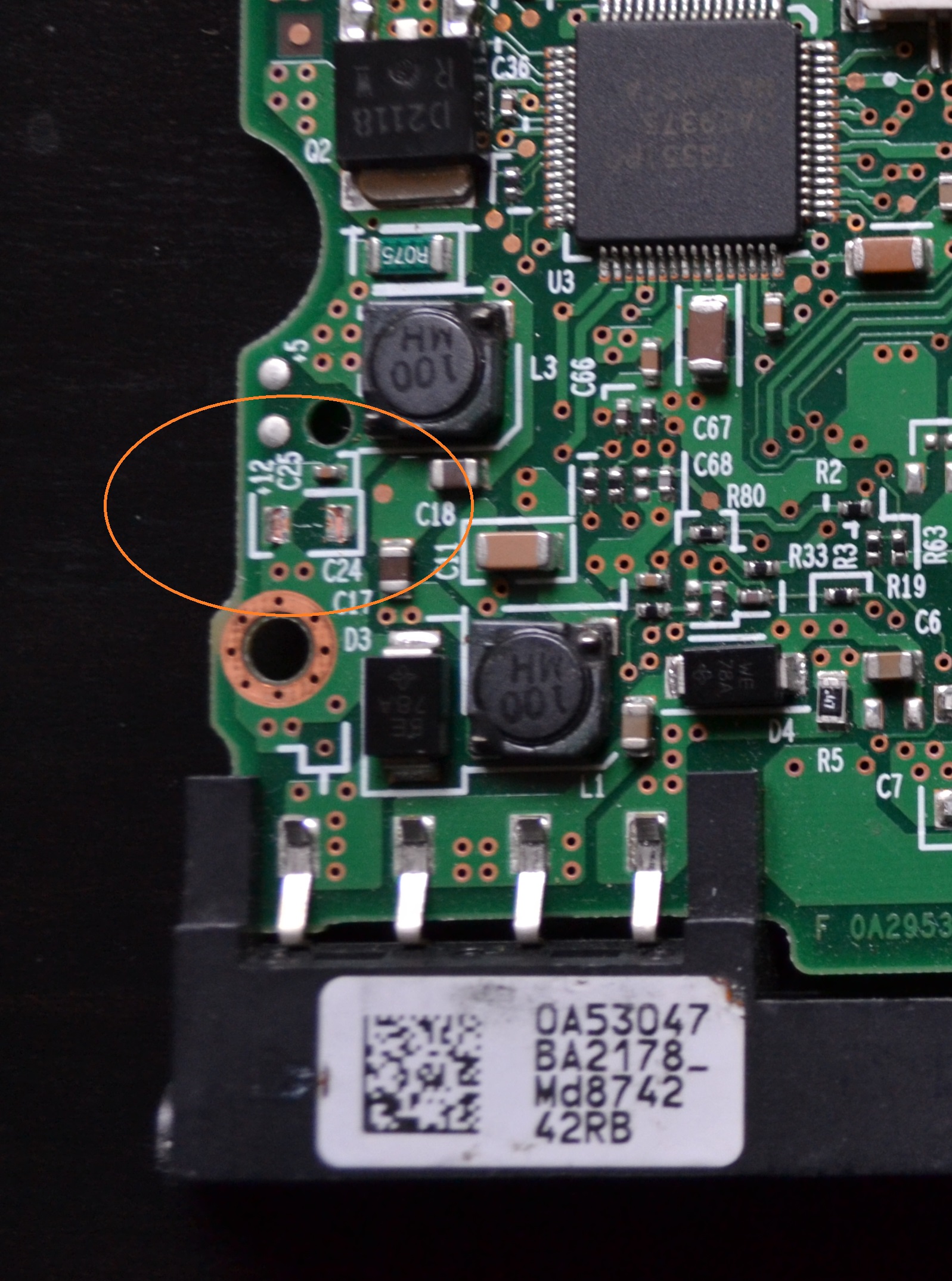

Um, check out C25.... Surely that can't be normal and I did not remove it.
PostPosted: March 1st, 2014, 22:20
Joined: May 21st, 2007, 16:10
Posts: 1592
Location: Gothenburg/ Sweden
Ooops, someone did remove that capacitor :D
http://www.rescue-it.se
PostPosted: March 2nd, 2014, 16:01
Posts: 17323
Capacitors C25 and C24 appear to be the filter capacitors for the +12V supply. C25 (the smaller capacitor) filters the high frequencies while C24 (the larger, missing) capacitor filters the low frequencies. The absence of C24 should not affect the functioning of the HDD, unless the +12V supply is extremely noisy. In any case it is not responsible for the current symptoms.
As for the voltage measurements, each pin should be measured with respect to ground. That is, place your black probe on the screw hole or Molex ground pins.
For example, the voltages at VR1 should be +3.3V, +5.0V, and +4.0V, IIRC.
Also measure the resistance between ground and each side of R5, with and without the original PCB installed on the drive. This will determine whether the preamp is shorted.
