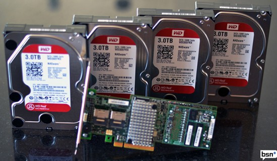

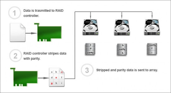

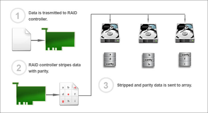

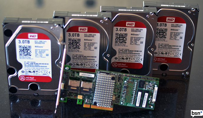

I suggest you: Western Digital WD VelociRaptor WD1000DHTZ 1TB 10000 RPM 64MB Cache
And go with: RAID 5
RAID 5 comprises block-level striping with distributed parity. Unlike in RAID 4, parity information is distributed among the drives. It requires that all drives but one be present to operate. Upon failure of a single drive, subsequent reads can be calculated from the distributed parity such that no data is lost. RAID 5 requires at least three disks.
File comment: Go with the best controller in the market.

Absolutely do not use RAID5 unless you have no other choice. Even for those experienced with RAID arrays, RAID5 has several caveats that can catch you out and lead to data loss. Even with one drive failed, an unrecoverable read error during a rebuild can mean the loss of the entire array. A simple Google search will explain in elaborate detail why RAID5 is a last resort.
Go for RAID10 (0+1) or if that is not an option, live without the performance gains of striping and stick with a RAID1 over multiple drives. Performance is desirable, but losing your entire array is not.
