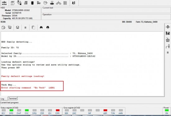

I have a SEAGATE SSHD ST500LM000
When i start the Utility in PC 3K it reports following Error
In sector edit it reads few sectors up to 63 sectors then it gives error everywhere.
Can not read modules as utility is not initialized completely.
HDD family detecting...
Family ID: 72
Selected family................................... : 72, Kahuna_5400
Model by ID....................................... : ST500LM000-1EJ162
Loading default settings!
Use the options dialog to review and save utility settings.
Then press OK!
Family default settings loading!
Tech Key...
Error starting command "En Tech" (ABR)

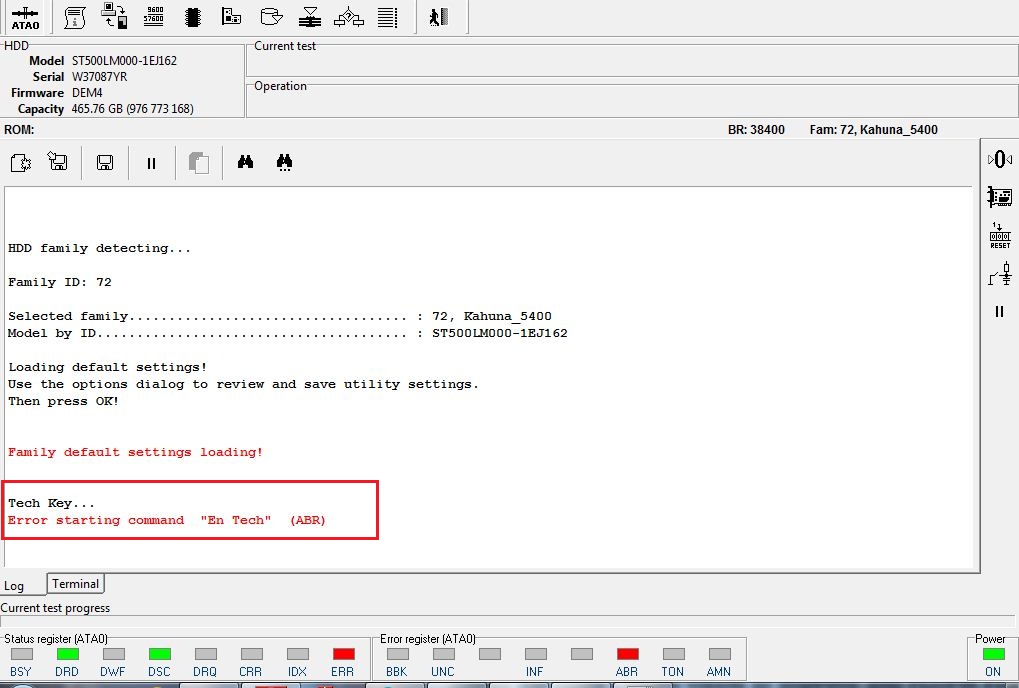

 Post subject: Re: Seagate SSHD ST500lm000 Help Required...
PostPosted: February 24th, 2014, 9:38
Posts: 264
Only the Model is detected.
Its not loading any modules.
No SA access
No terminal Out
Has any one faced this problem
