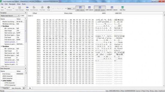

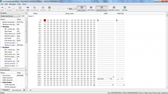

 Post subject: Re: G-Technology 4TB RAID

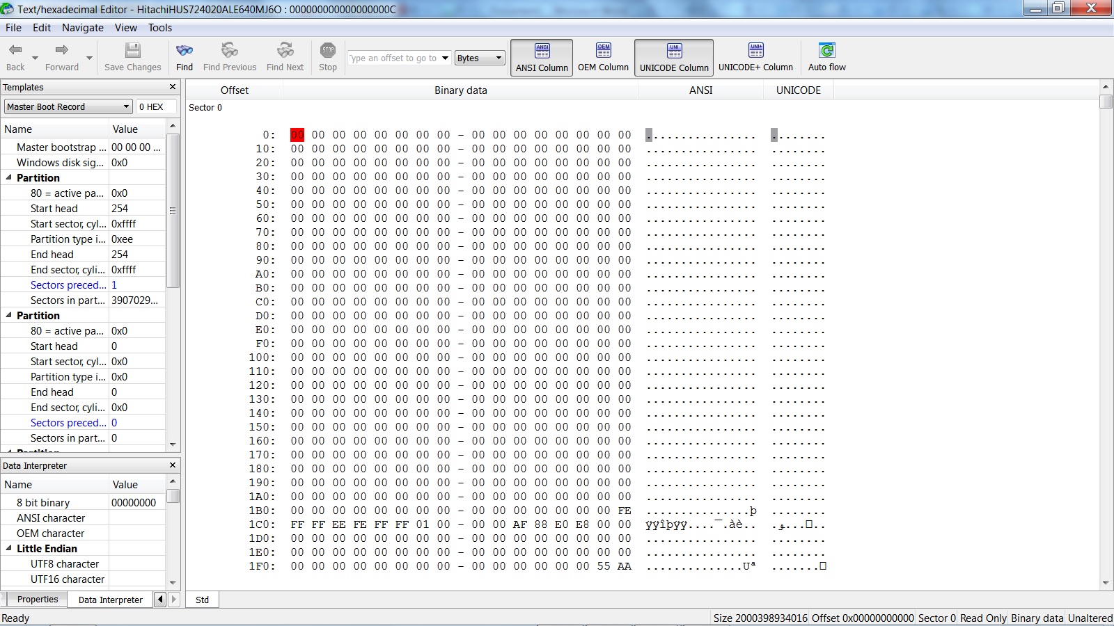

PostPosted: March 17th, 2014, 23:45
Joined: February 25th, 2014, 22:23
Posts: 8
jnorth wrote:
I have one of these to recover for a client and I'm finding it very difficult to work through the correct settings for the RAID 0 configuration.
Can you show us the contents of sector 0 of each drive?

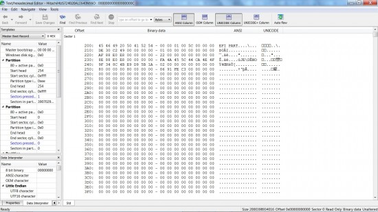

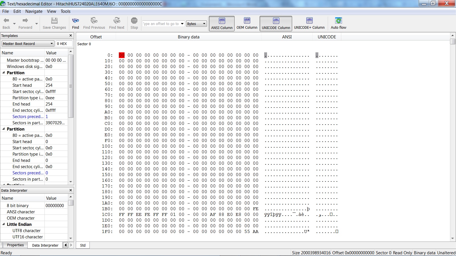

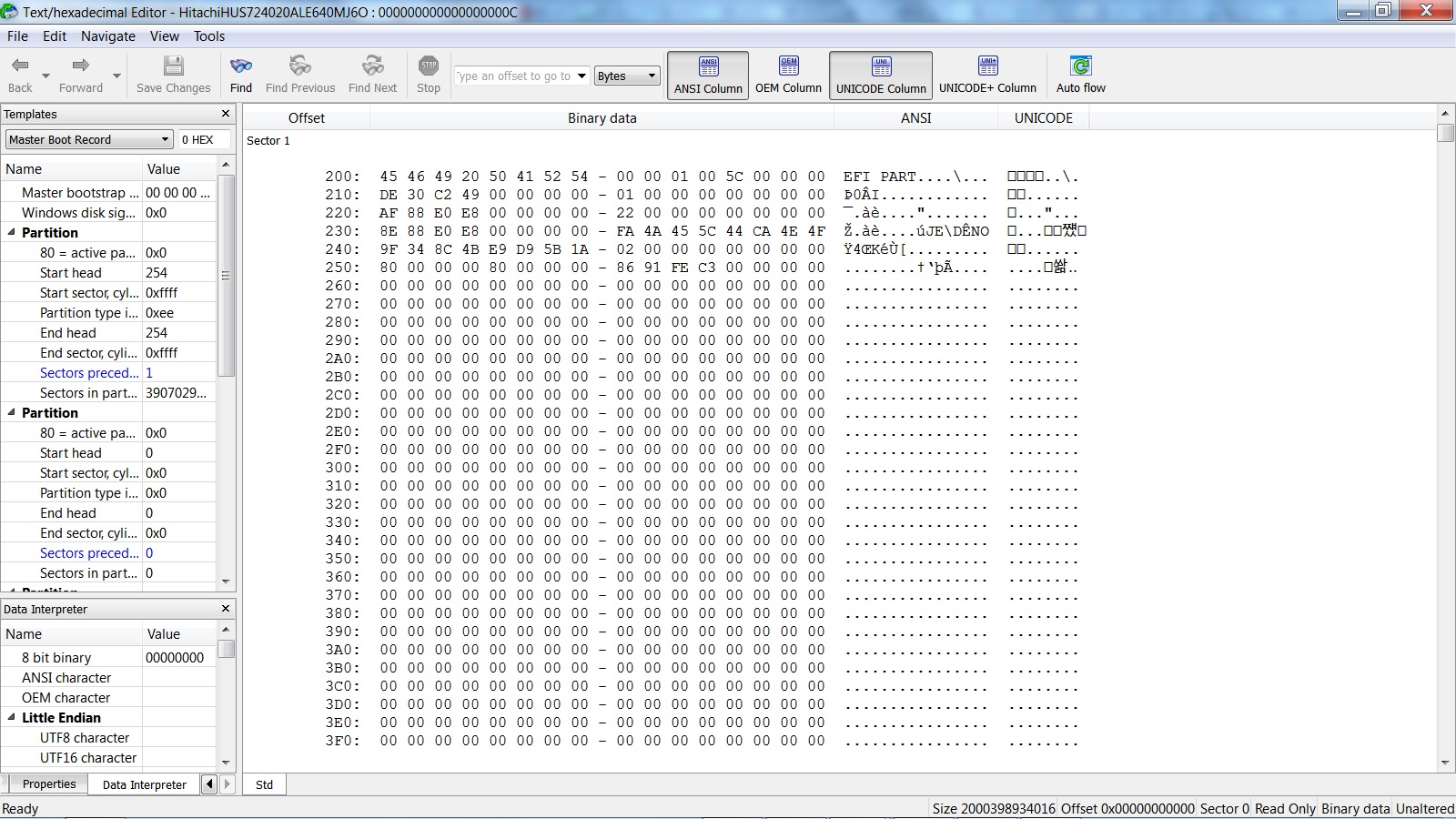

I've captured the data using R-Studio, let me know if there's anything else you need.
PostPosted: March 18th, 2014, 0:40
Posts: 17323
The two sectors appear identical. Each shows a partition table with a single 2TB partition beginning at sector #1.
The size is ...
0xE8E088AF x 512 = 2 000 398 933 504 bytes
The partition type is 0xEE which tells us that this is a protective MBR.
Therefore you have a 2TB RAID 1, not a RAID 0, and the RAID is partitioned in GPT mode.
See http://thestarman.pcministry.com/asm/mb ... es.htm#pte
... and http://thestarman.pcministry.com/asm/mbr/GPT.htm#GPTPT

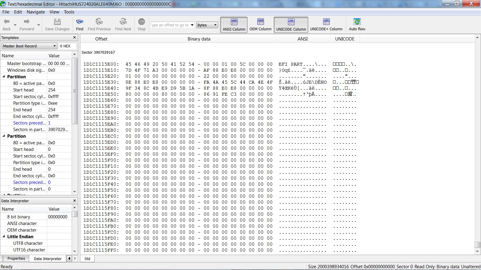

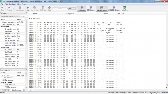

PostPosted: March 19th, 2014, 21:49
Posts: 8
DR-Kiev wrote:
The size is ...
This is the strange part, doing scans with both UFS Explorer and R-Studio both show up nothing in terms of a lost partition. A raw recovery also fails to come up with any data.
Setting it up as a RAID 0 in R-Studio and scanning the drives shows up a HFS+ 4Tb partition, opening the partition shows up the file and folder names however no data is recoverable or accessible ie it is just fragmented. That's what lead me to think it was a RAID 0 config and the owner of the drives is adamant it was not mirrored.
Having said, based on what you've indicated I've gone back and scanned again however still with no luck. This one truly has me stumped...

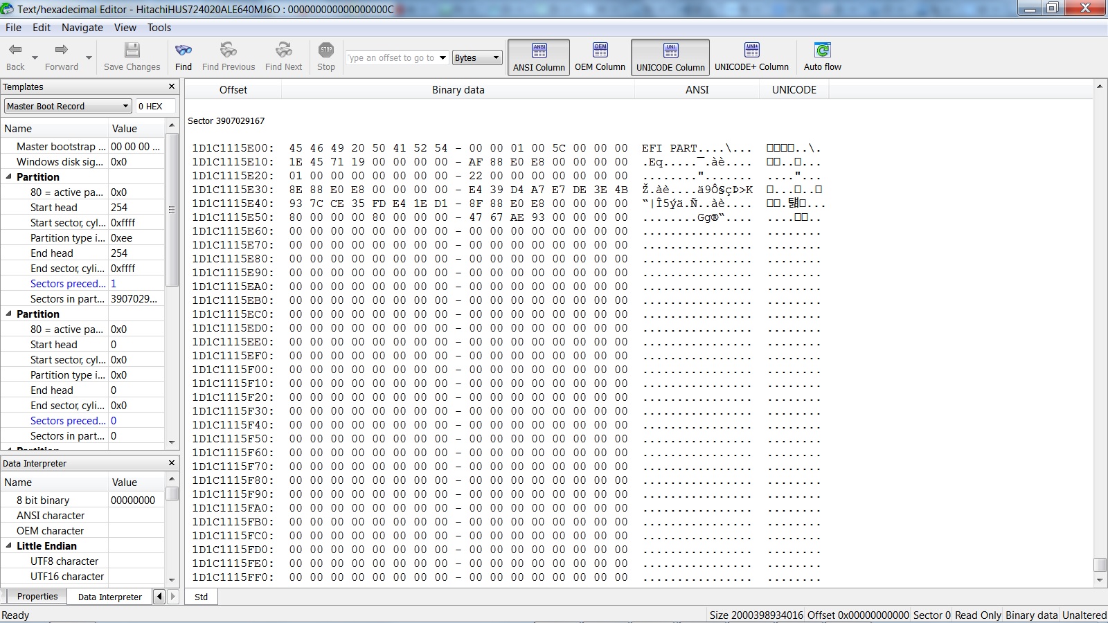

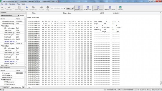

Show the last sector of each drive.
Here they are - first try seems to have not loaded:
PostPosted: March 20th, 2014, 0:10
Posts: 17323
Both sectors contain identical data, but different DiskGUIDs, so it's not a mirror.
I'm thinking that the client may have removed each drive from its enclosure, attached them to a SATA controller, and reinitialised them as 2TB GPT partitions. Sector 2 would have the current partitioning information.

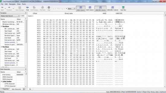

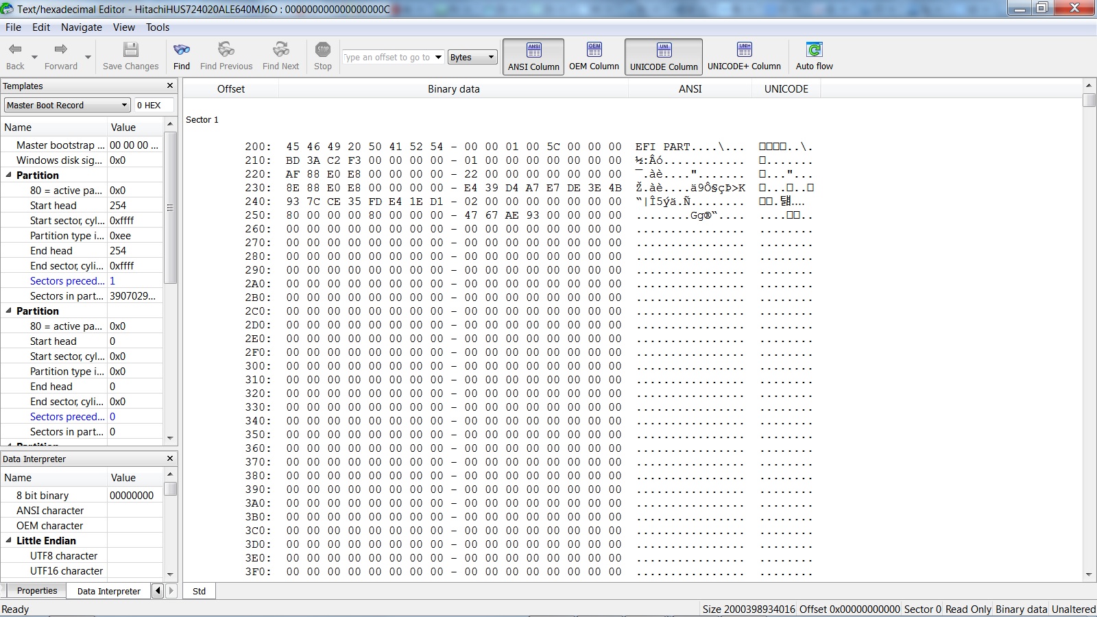

PostPosted: March 20th, 2014, 1:41
Posts: 8

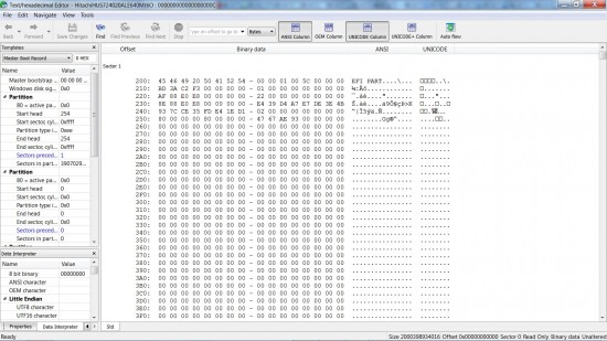

I'm not sure they did remove them but they did report things going wrong with he unit which stopped them accessing the data.

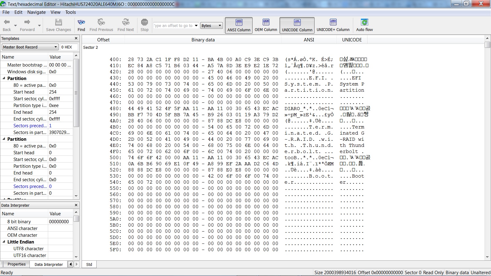

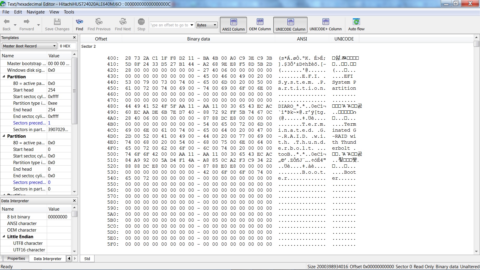

Here's the first and second sectors of both drives.
PostPosted: March 20th, 2014, 15:56
Posts: 17323
Sector 2 shows three GPT partitions. These appear to be original and were not created by an external OS. Each of the 6 partitions has its own unique GUID, but otherwise each set appears identical.
Partition #    Start LBA    End LBA      Size         Partition ID
1              0x28         0x64027      0x64000      EFI System Partition
2              0x64028      0xE8DC8887   0xE8D64860   Terminated G-RAID with Thunderbolt
3              0xE8DC8888   0xE8E08887   0x40000      Booter
http://en.wikipedia.org/wiki/GUID_Partition_Table
I suspect that the second partition contains the user data, and that sector 0x64028 may be the offset for the array. ISTM that the external OS would not see the partition structure, but would only see those sectors in the range of the second partition.
Unless someone can provide definitive information as to the RAID parameters, I would examine sectors 0x64028 (= 409640 decimal) and 0x64029 on each drive. This may help us to confirm whether the array has a stripe size of 1 sector, as suggested by others.
