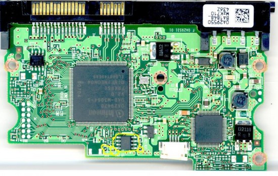

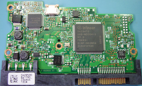

HELLO I HAD A PROBLEM WAS WHEN WELDING POWER SUPPLY MOTHERBOARD OF A HARD DRIVE HITACHI AND RESULTS THAT FELL IN A PART OF TIN PLATE , AT THE TIME BUT I WANTED TO REMOVE MANUALLY GROWING NEED AN EXHAUST TIN O SOMETHING, THE DRIVE STOPPED RUNNING SINCE THAT TIME = ( THE MODEL IS THIS:
HDT725025VLA380:
PLEASE HELP ME!!!
File comment: THE OTHER PCB

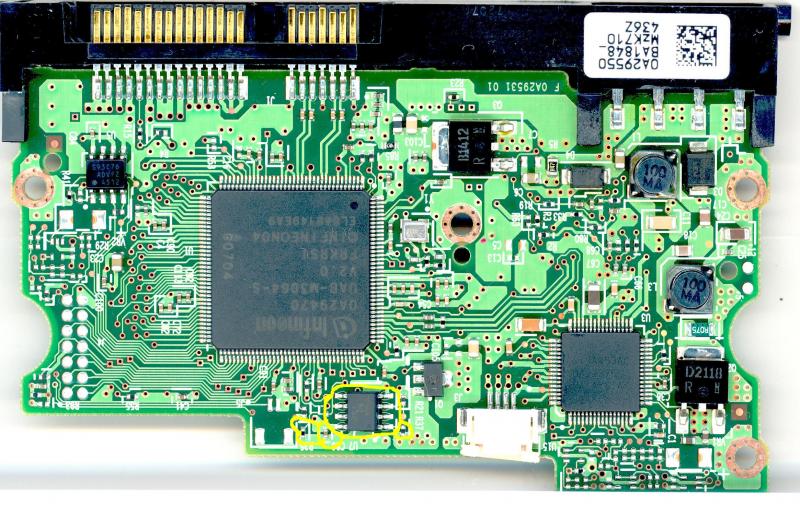

File comment: THIS IS THE PCB

U5 is the important chip. You must not damage it.
The following company offers a chip transfer service for US$20:
http://www.onepcbsolution.com/firmware- ... t-pcb.html
