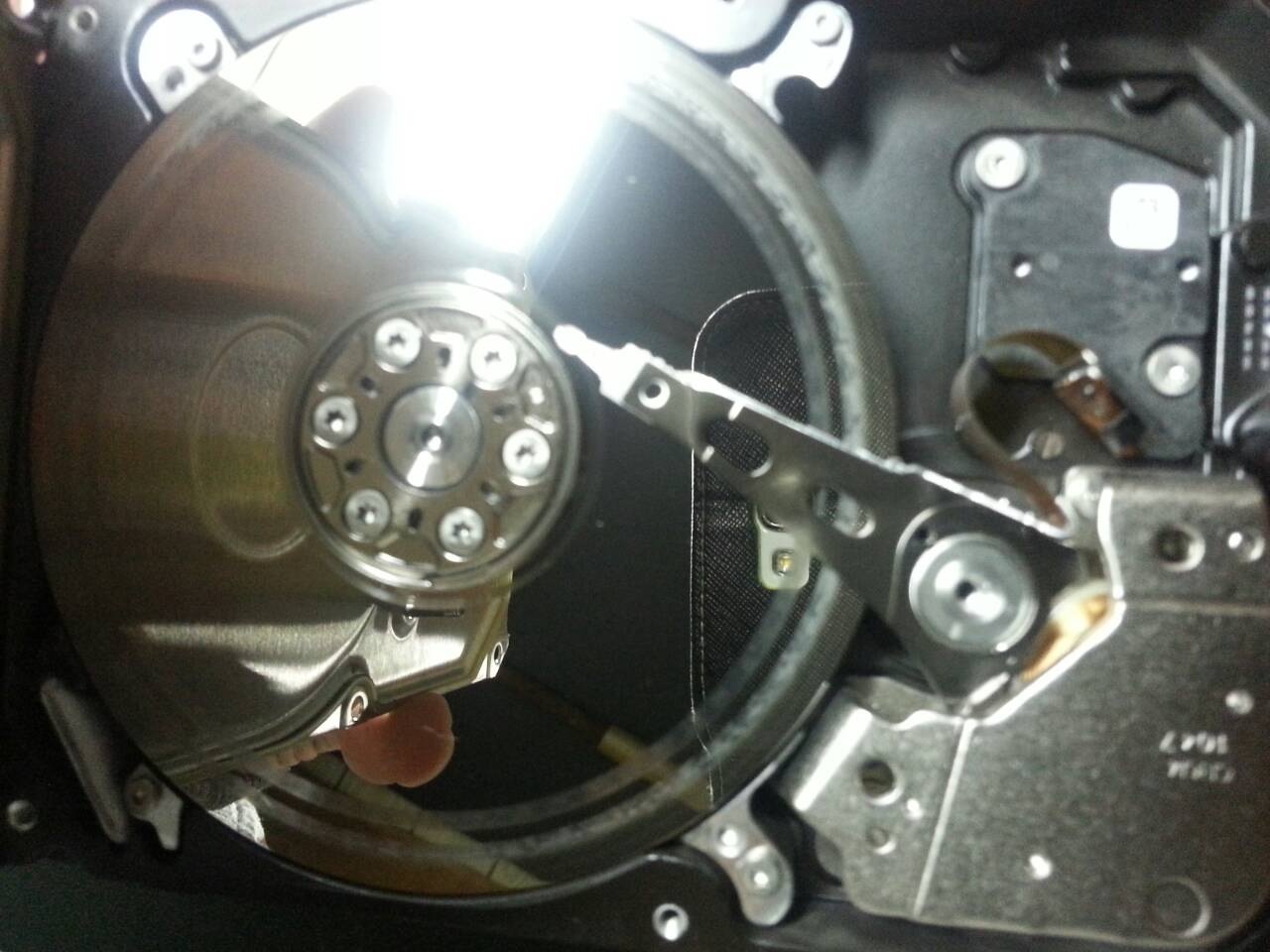

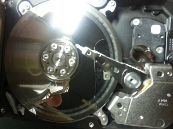

The disk surface is critically damaged.
If anyone can handle this situation, plz pm me with the price, tks :D
On this drive is not recovery possible, but will be great paperweight :)
