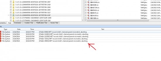

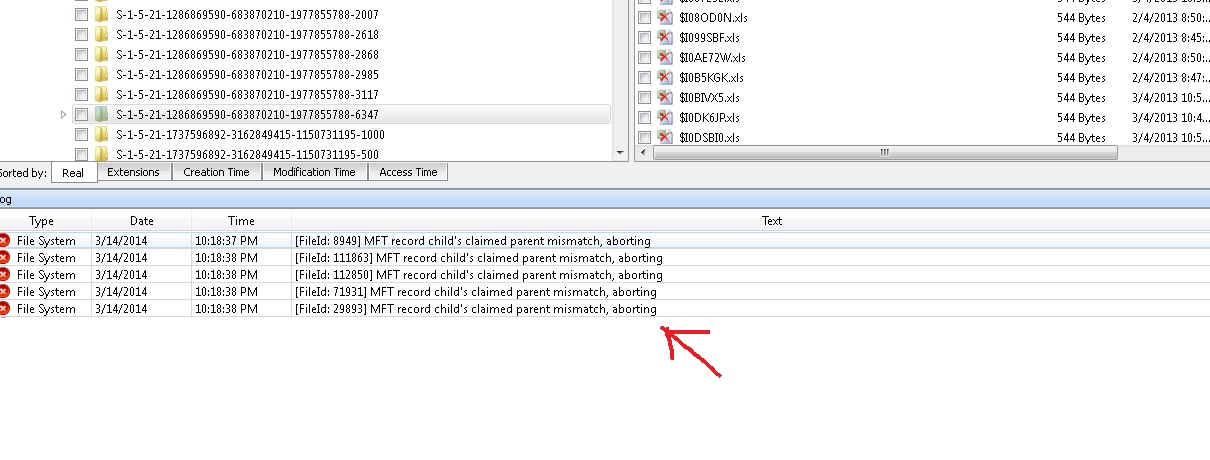

What about this errors.
thanks.

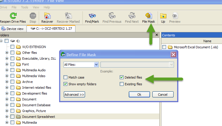

Before doing carving to search files metadata you can try to create regions in r-studio, if you know how to do it...
My firmware database:
 Post subject: Re: Trying to recover delete files
PostPosted: March 16th, 2014, 16:39
Posts: 293
hey Lobox

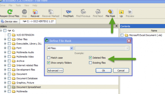

you could try using the Sorted by Extension tab and also "Define file mask" and check Deleted box.
you can then skip to "Real" tab to find original locations.
If this fails do a "Full Scan " first.
this will pick up remnants of old file table entries as well as lost files in slack space.
If you get this far come back and let us know, then one of us can guide you for next steps.
feel free to DM if you feel the need

Heya digitalferret
thanks for info bro, right now doing a full scan to see whats comes up, will let you know thanks man.
