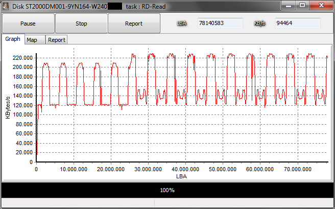

I've made a short stroked test of my drive, measuring the first 40 gB of the drive:
Could this be the result of mixing different density platters? I mean, 667 GB platters mixed with 1 TB platter, this could explain this particular pattern of the spikes on the graph. Is it technically viable to mix different density platters on the same drive?

I thought that because a 667 GB platters drive can't reach 220 MB/s and because the short stroked benchmark shows a very particular pattern, with symmetrical highs and lows on read speed for the very first 40 gB of the drive.
But your explanation has incontestable logic, I'm not an expert in hard drives but I think that the R/W heads must suffer a lot exposed to different density platters on the same drive.
I'm testing now with HDD Scan, some zones from the start of the disk are being read at 120 MB/s, then jumps to 224 for a while and returns to 120 (like in HD Tune Pattern). I'll post my results later.
Thanks a lot!

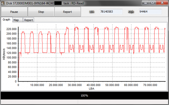

HDDScan results, short stroked to LBA 78140583
Block Size: 256 (HD Tune uses 64 Kb blocks by default).
Same pattern :(

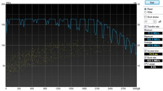

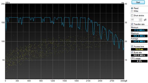

PostPosted: April 26th, 2014, 17:17
Joined: April 26th, 2014, 16:59
Location: who cares
It looks like Seagate is accepting defective drives in warranty, remapping a ton of bad sectors to extra cylinders, clearing SMART and just pushing them back to the unsuspecting.
I just got a 3TB backup plus with a weird hdtune profile, full of gaps. First I thought it was some app interfering with the measurement, killed everything I could, reran with IDENTICAL results - exact same dips at exact same places. This indicated it is really a drive characteristic, confirmed by running hdtune on another drive, which gave smooth response.
Since they just give the remainign of warranty on the exchanges, Seagate is just playing this dishonest game. Your soup has a hair in it? No problem - we take it back to the kitchen, serve to someone else. A 'recertified' soup will be right out to you.
Drives are Seagate Backup Plus 3TB, which have a ST3000DM001 Barracuda inside.
Seagate no more...

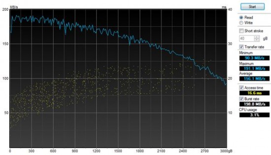

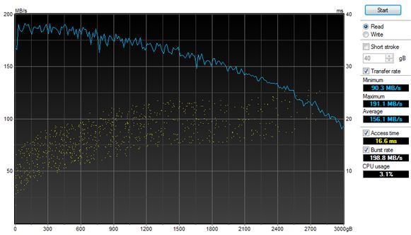

File comment: A healthy, original 3TB backup has great data rates, smooth decay.
File comment: Same model, 'recertified' from Seagate's used car lot has lower top rate and several dips across the disk
