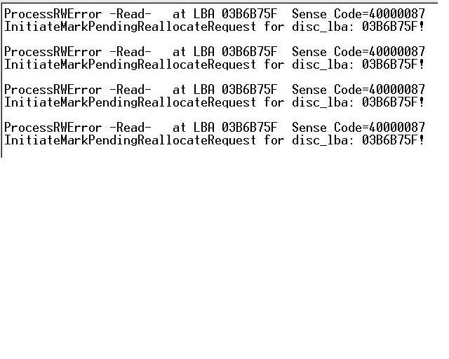

HELP ST500DM002-KC45 NOT READ AFTER 27 % .
FIRST IT WAS GIVING BUSY.
I AM USING DDI4.

Looks like bad translator to me...have you performed any regeneration?

I DID THIS
m0,2,2,0,0,0,0,22
 Post subject: Re: HELP ST500DM002-KC45 NOT READ AFTER 27 %
PostPosted: March 21st, 2014, 5:08
Posts: 1768
Location: Verona, Italy
BAD MOVE.
This drive has NRG list, with command m0,2,2,,,,,22 NRG wasn't taken in account so now you have partial access to sectors.
Sector 03B6B75F (HEX) is sector 62306143 (decimal), this means that from LBA 62.306.143 to last LBA you don't have anymore access (assuming that 03B6B75F is the first sector on which you get error in terminal).
Do you have pc3000 or HD Doctor?
With those you can rebuild NRG and get again access to sectors, then you can continue to clone with DDI

I do not have anything like pc3000 or HD DOCTOR. My client can pay only 5000 RS. I WANT TO OUTSOURCE THIS JOB IN INDIA ONLY.

Sorry, if you don't have professional tools then you can't do much to get data from this drive
