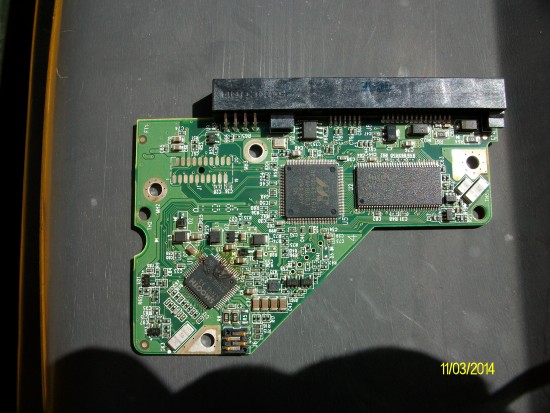

Good Afternoon Guru's
The following drive

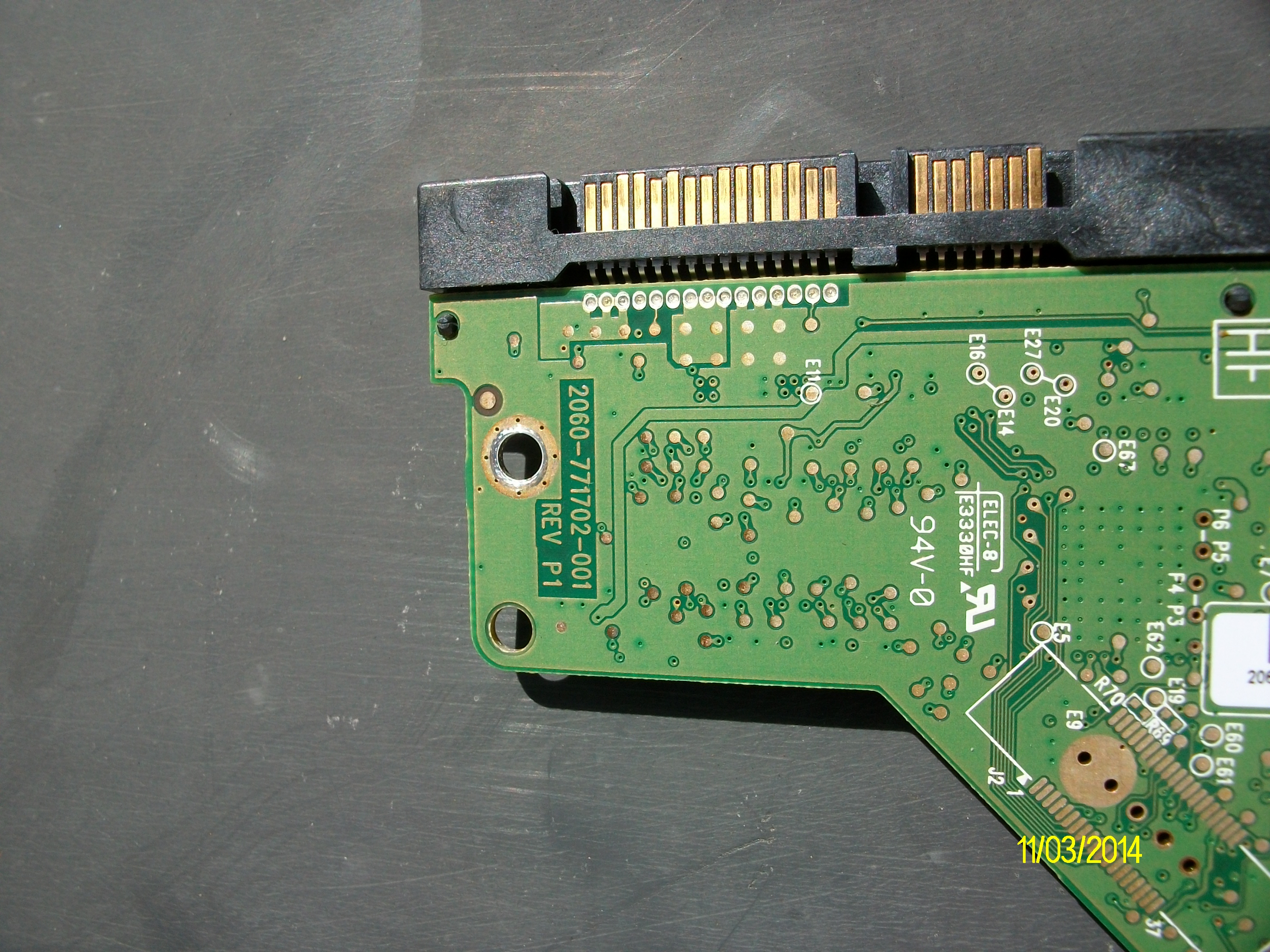

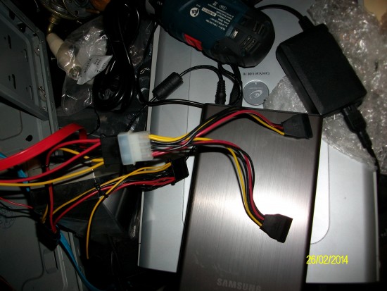

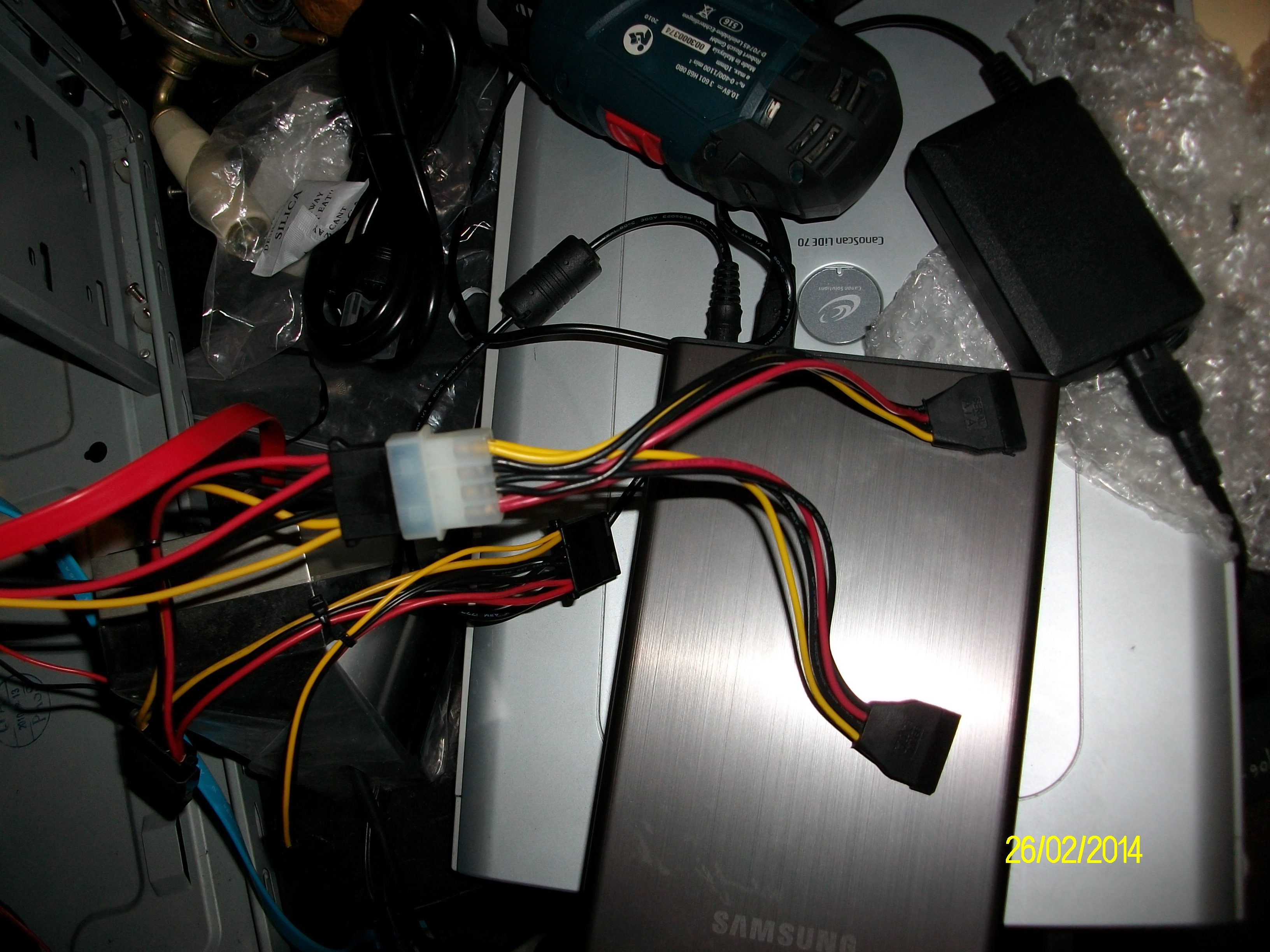

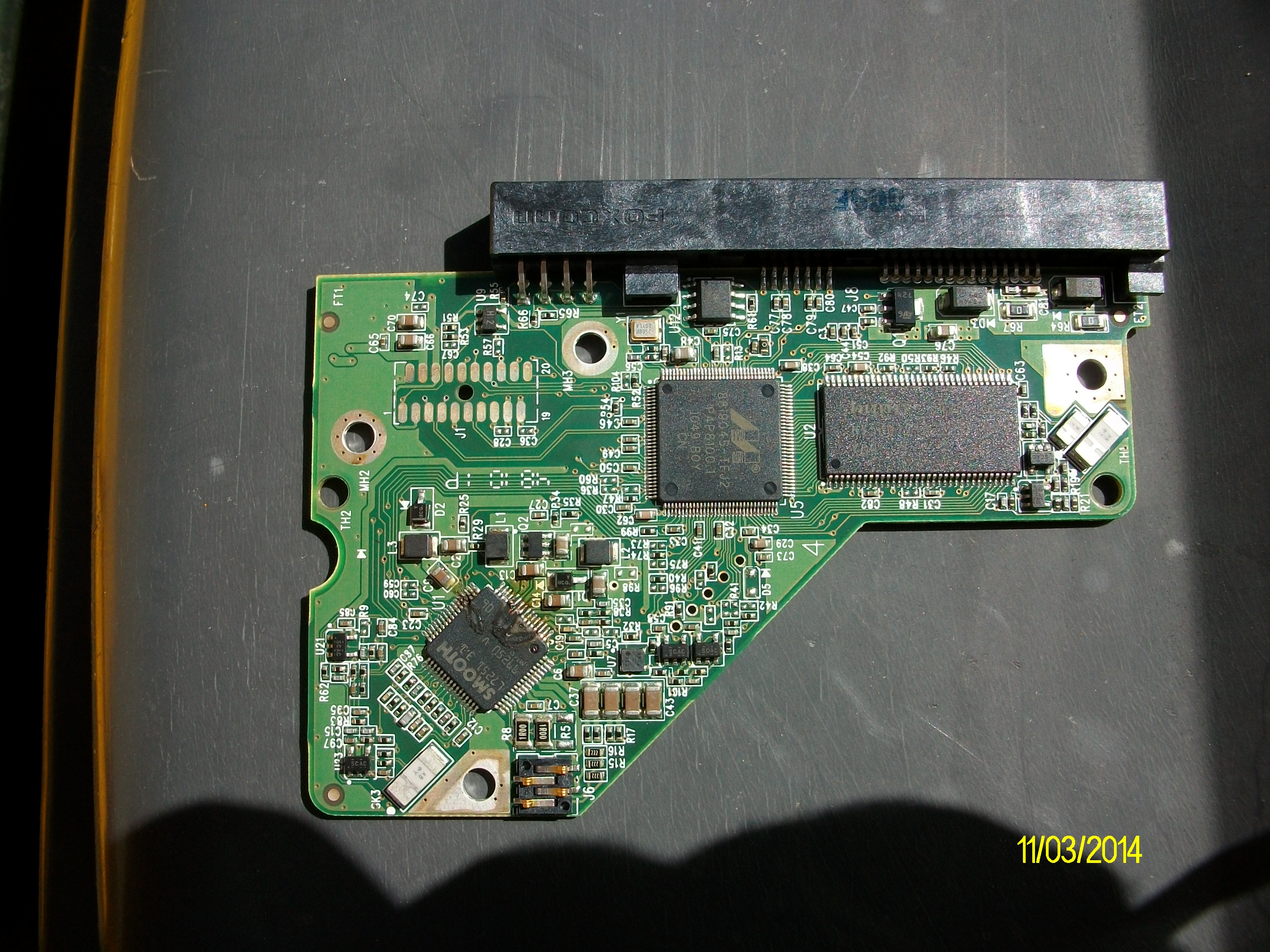

is currently caput the reason why will be obvious the the power supply lead was crossed,

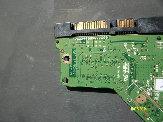

how / why still a mystery, sabotage..... :shock: it does not matter. It happened. The result is a shorted VCM controller as per photo.

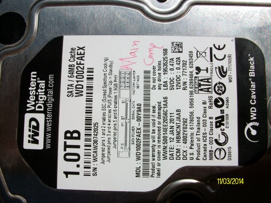

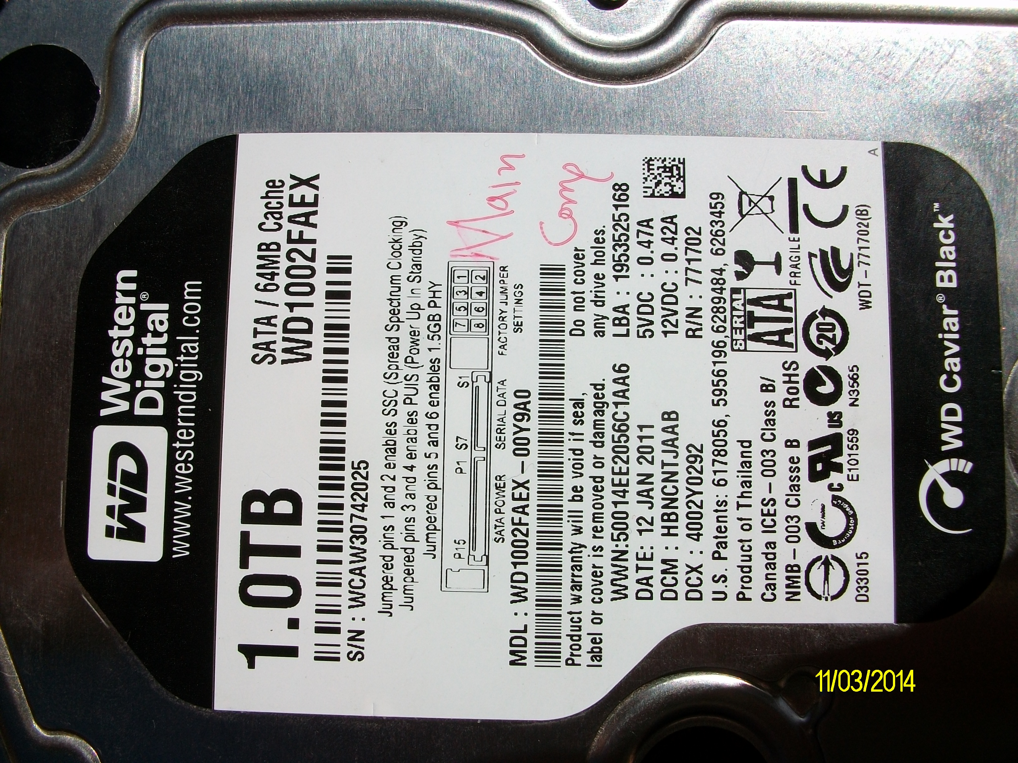

That is as far as I know, from what I can see nothing else is stuffed the drive was in A1 order prior to the short. Is it a proposition to replace the PCB or will there be other faults I am not aware of ? Given I know the reason it shorted I am hoping you will be able to advise on potential remedy. If it was a building i could fix, it isn't so i need your help. If you have a building problem then i could trade advice ! The serial number is
From what I can determine HD parts have one but need the board sent to them. How reliable is that service and / or is there one closer?

Ideally speaking if you can locate a matching board and swap the ROM to get going.
HD Part is also reliable.
At time burnt VCM also damages further.

Measure the resistances of the following components:
http://www.users.on.net/~fzabkar/HDD/bi ... diodes.jpg
The damage to the SMOOTH chip is on the side that generates the Vcore and Vio supplies, plus the negative supply for the preamp. Moreover, an overvoltage on the +5V supply can result in a damaged preamp.
As for PCB suppliers, there is also onepcbsolution.com. I don't know of anyone in Australia who provides a similar service for the same price or less.
Best of luck.

Thank you for the feedback, Rob and fzabkar, will a new PCB resolve the issues that you are referring to, or, are we talking inside the case ? Thanks for the other contact re PCB supply !
I think i am getting it 12 volts coming into what is supposed to be 5 volts.

If the TVS diode protection is blown, then applying 12V to the 5V input will most probably damage the preamp (on the headstack inside the case).

Well, on this subject, I am wondering why the diode did not protect the components, my only Idea is that the power supply rammed so many amps down it it blew the diode, also from the SMOOTH chip being burned like that I surmise the Preamp chip inside the drive itself is probably damaged too. How the hell could a red wire be mixed with a yellow?
I believe a professional data recovery is now needed, unless you have backups.
