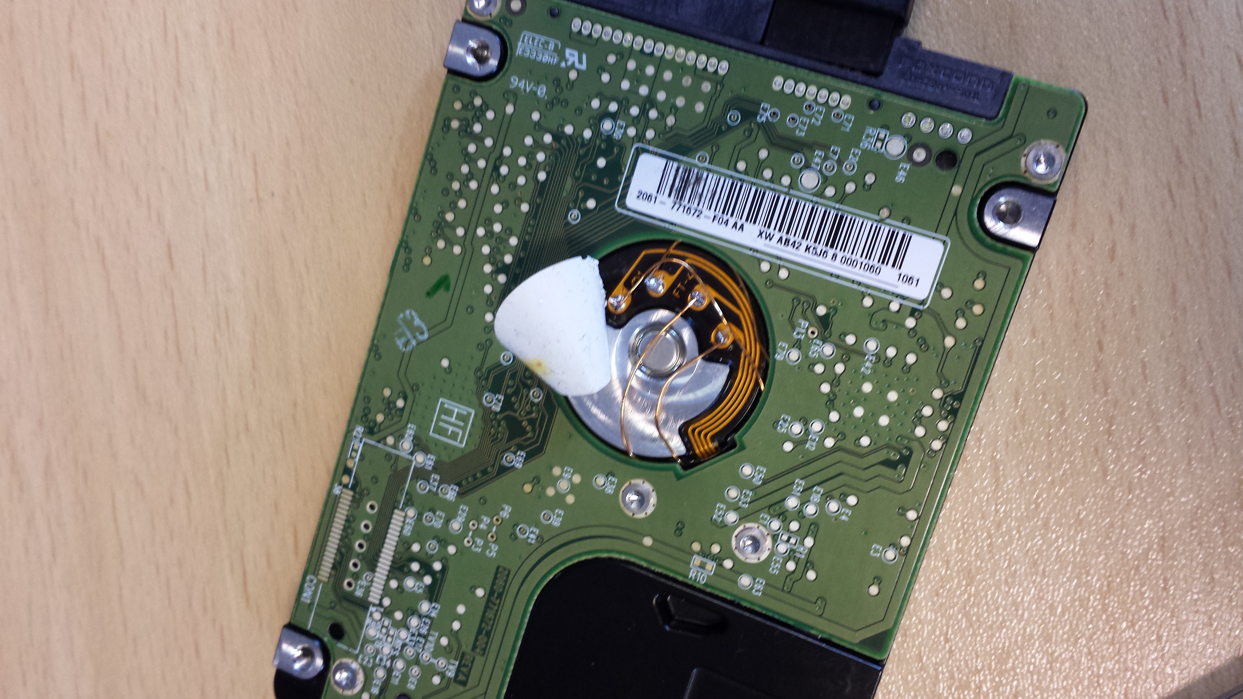

Had one of these in, only drawing 90ma on the 5v rail. Prob should have checked it further but went for a board replacement, did the same thing. Motor windings resistance upon testing was infinite, thought that was a little odd so lifted the sticker below the motor and tested points there, came back fine. Upon looking closer someone appears to have taken a scalpel to the cable (see picture). Bit weird? Guy denies any knowledge!
Had to be a deliberate act?

One of the local computer shops damaged several Fujitsu drives by slicing through their flex cables with a scalpel. They did this accidentally while cutting through the cardboard box that they were shipped in. Yours looks deliberate, though.

i think the only two options is to try and get the damaged pieces off that drive and put a new one on from a like drive. Or a Platter swap...
I guess you could also attempt to repair that wire

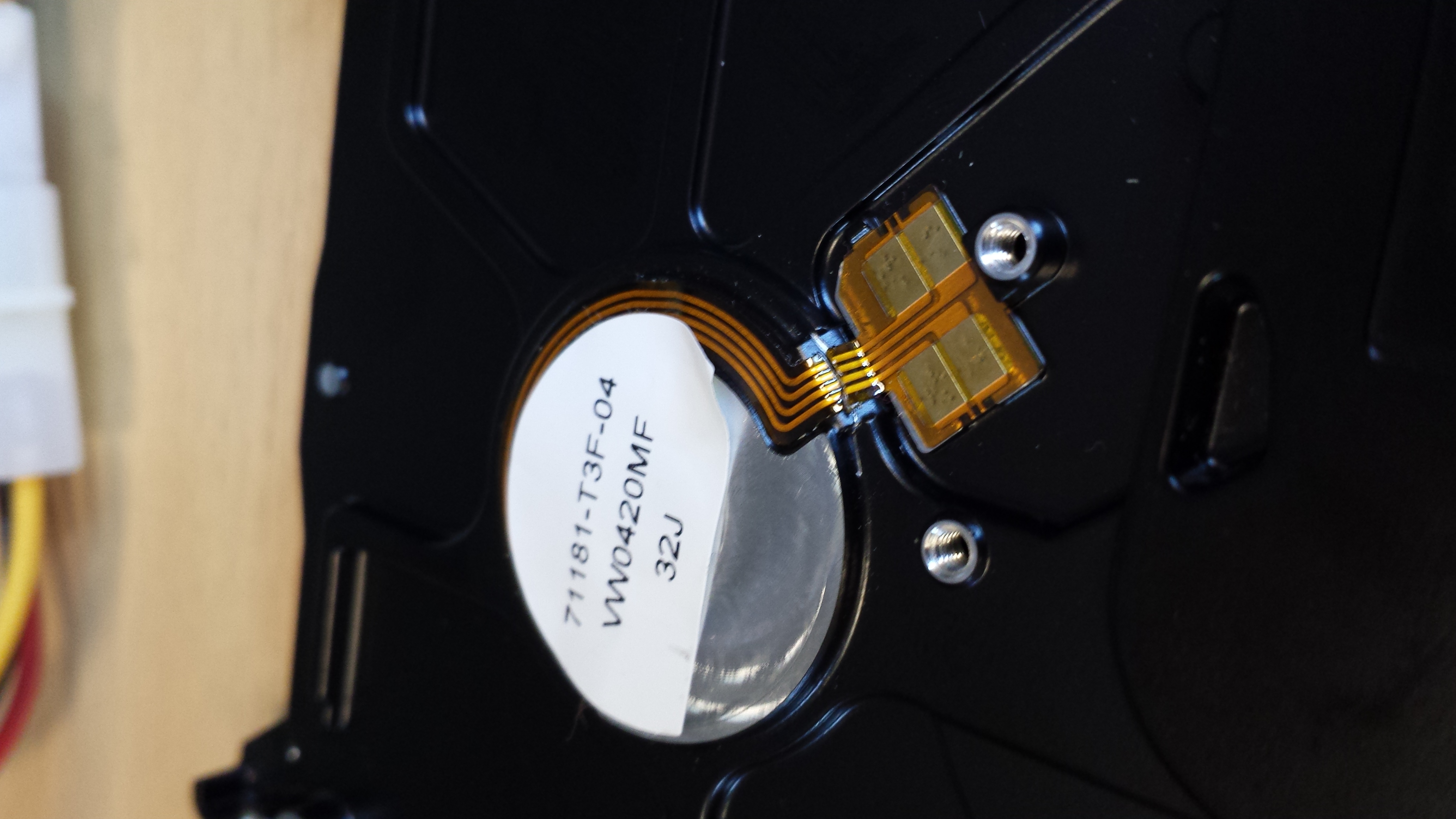

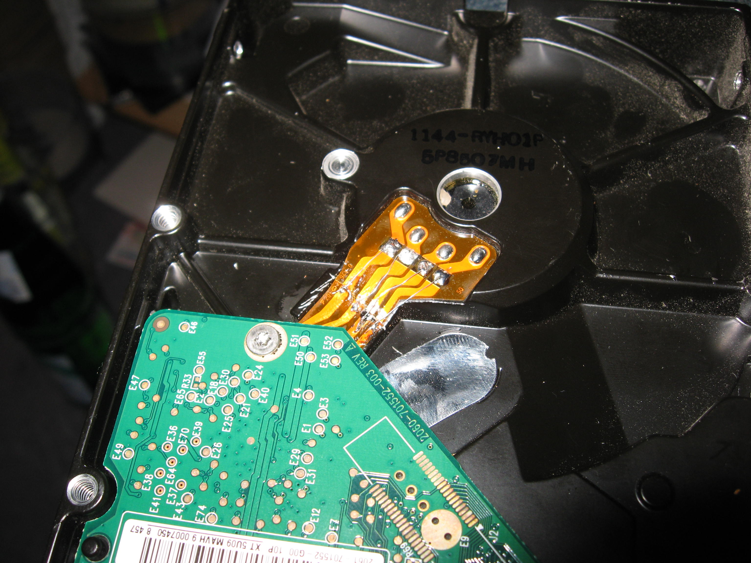

Scratch away some of the insulation and solder some small wires over it.
On a 3,5" drive it was kinda easy and nothing melted.

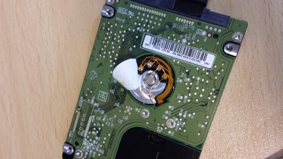

My solution..... Hey it works so thats the main thing

As to the original repair, I've found a small bit of solderwick works well as a jumper. It soaks the solder up nicely and is less prone to snapping as wire is, since it maintains flexibility.
