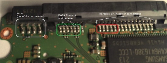

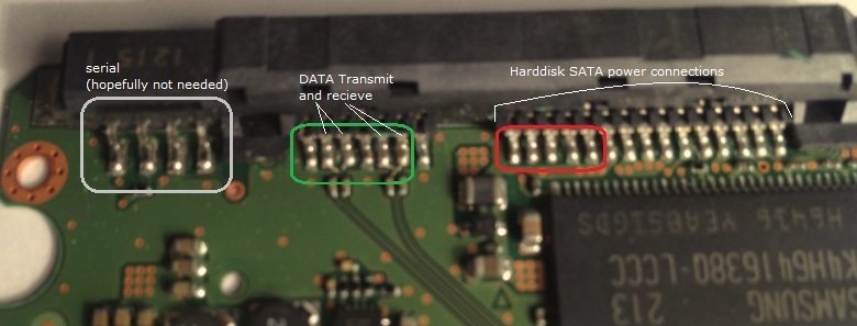

No probs, as I was saying, this drive I soldered last week or so, under microscope, had Data tracks severed, but power tracks connected, so spun up but no data access. perfect recovery.
green and red circled were torn off PCB
BTW Im driving to Nhill tonight,instead of Melb as usual.. bummer.

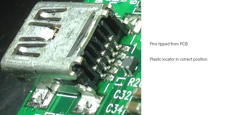

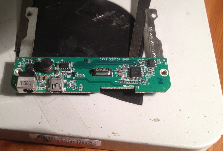

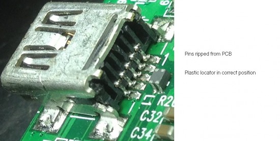

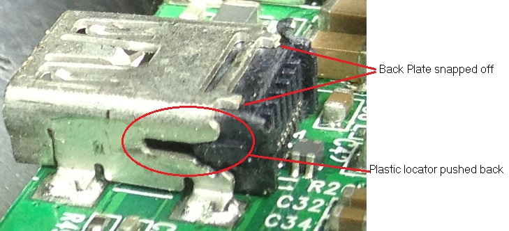

This drive has a USB plug and external DC power plug. Power was fine, USB the issue.
Plug was pushed in
Supposed to look a bit like this but with pins soldered to board... New Connector time!

Update: After new USB connector was soldered on, drive is working fine. Owner was lucky that the USB legs ripped out of the solder but did not lift or break any tracks. Still amazes me why there is not a plug, short lead going to the USB plug and this assembly fixed to the case. In case of breakage, just unplug and replace with new USB connector assy. A bit like the power plug on some laptops.
