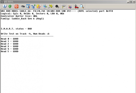

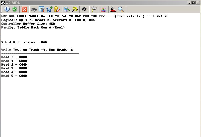

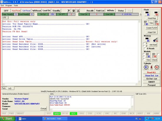

I have a problem with WD20EARS drive after turning off the computer and start it next time disk visible to the capacity 0MB in mhdd.
Drive plugged into the WDR and is visible as:
WDC ROM MODEL-SADLE_G6 FW: 20.76 SN: WDC-ROM SN XYZ
The disk spins and turns off after a while.
What can I do teeth hard work :(
Provides snapshots of the WDR:
 Post subject: Re: WD20EARS - 00MVWB1 0MB problem
PostPosted: March 29th, 2014, 2:52
Posts: 1061
Location: Bangladesh
Why dont u scan the SA?
can be ATA/ROM

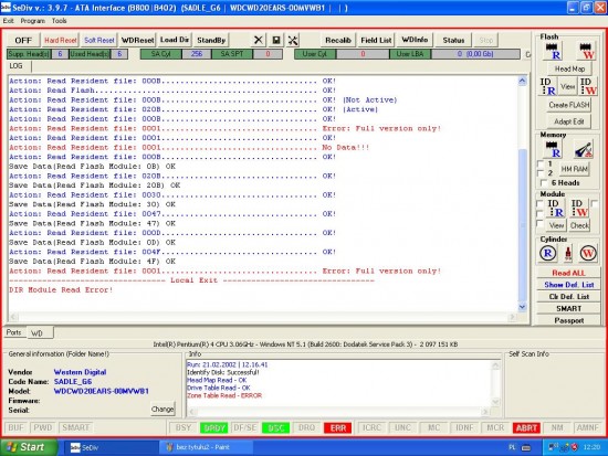

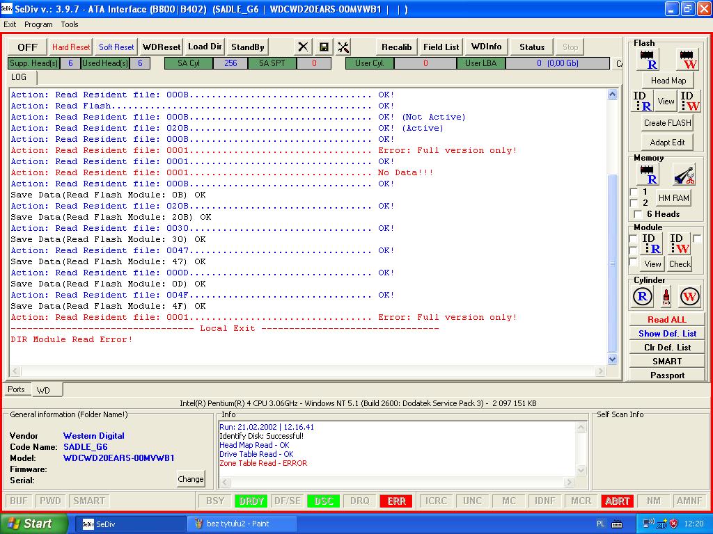

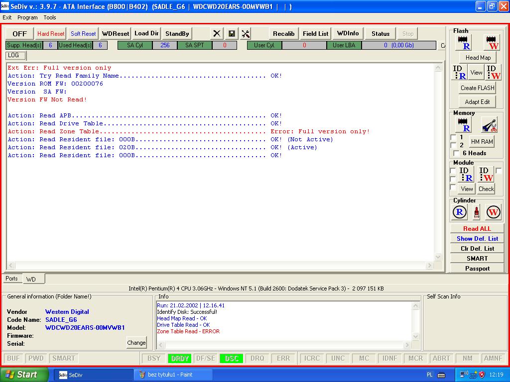

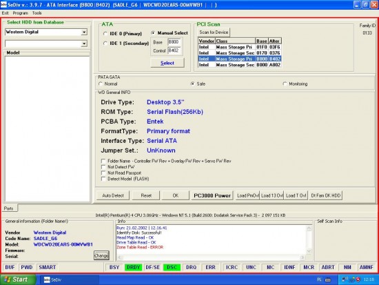

PostPosted: March 31st, 2014, 10:34
Joined: January 13th, 2014, 10:29
Reading from Sediv.
PostPosted: April 3rd, 2014, 7:47
Posts: 849
It seems like mod 03, copy0 is damaged. Try starting the drive from copy1 and check all modules. Make a copy of all modules and repair SA.
