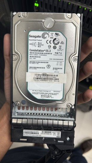

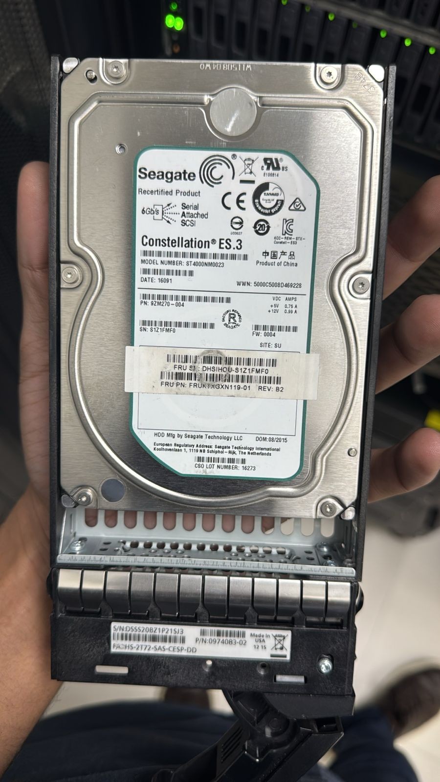

I purchased the 2 discs you see in the images. I hope image is clear.
I have a IBM m4 x3250
Lines of code I tried;
Home · ahouston/setblocksize Wiki (I tried, it didn't work)
sg_format --format --size=512 /dev/sg2 ( I tried, it didn't work)
GitHub - Drive-Trust-Alliance/sedutil: DTA sedutil Self encrypting drive software (I tried, it didn't work)
sudo sg_format --format -v --size=4096 (I tried, it didn't work)
sg_format -F -F -F (I tried, it didn't work)
THE ERROR I GET IS THE SAME IN EVERYONE;
illegal request, type sense key apart from invalid opcode.
