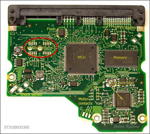

Because you want to learn, i suggest you to begin reading this to understand how hard drives are made inside:
http://hddscan.com/doc/HDD_from_inside.html
However i marked with a red circle the HDA contacts (which connect the pcb with heads):

You were right, the contacts seem to be dirty, I will upload a picture in 5 minutes.

How do I clean that?

lo mejor para limpir esos contactos es usando un goma de borrar, puedes usar la de un lapiz....

Gracias, le pasé un poco de alcohol normal de 96º, le pasé un paño seco y despues lo dejé una hora secar, ahora parece que va incluso más lento.
Ahora probaré con la goma de borrar.
Thanks you, I cleaned that with 96º alcohol, and I wait until it was dry, now it seems to be slower.
Now, I'll try with a rubber.

99% the 'dirty' contact is not the problem. They often all look 'dirty' after a short amount of time (ROHS), your problem is elsewhere.

I agree too that for the 99% dirty contact isn't the problem, but is always better to clean those since it's very easy.
Before you think fault is most unlikely best to make sure the most trivial things are alright!

Well, the contacts are like new, but the drive still don't works.
