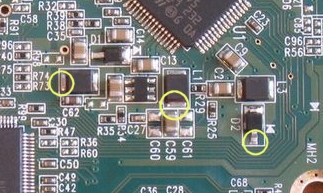

Measure the voltages at the indicated test points.
They measured 0.1 V, 0 V and 0 V respectively, from left to right. Kind of sad.
While I was at it I also measured the voltage around C76, which was 5 V and 0 V on each side, if it helps.

ISTM that the SMOOTH motor controller IC is dead. This chip generates the onboard Vcore, Vio, and V- supplies. All three supplies are at 0V. I suspect that C6, C9, and C14 will have either 5V or 12V across them. If so, then that would be added confirmation that the chip is dead.
Yes, C6 has ~12 V and C9, C14, C13, etc. have 5 V. The SMOOTH chip must be dead.
