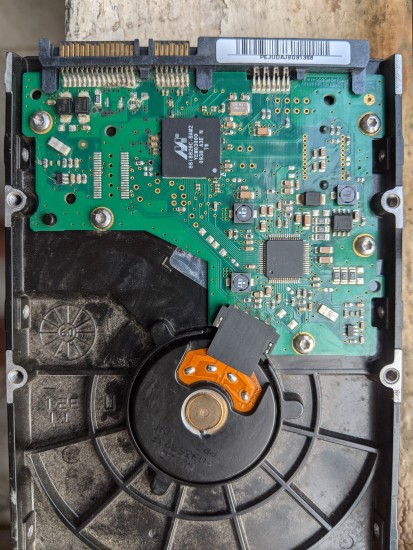

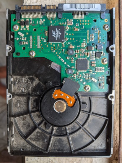

Joined: January 29th, 2022, 10:21
Hello fzabkar!
I'm Uday Kiran. I'm from India.
I have a Samsung Hard Disk Drive. Apparently an old one. Model No. HD321HJ. I've been using it as secondary storage for my desktop computer. It stopped working suddenly. I notice no clicking sound or no buzz sounds. I've tried accessing it through an external case but no luck. It is not getting detected. I'm looking for solutions online and thankfully found this forum and this topic. Can you please help me out with this?
This drive contains a lot of data. I should call memories instead! Please find the attached photographs of the disk.
Thank You.
 Post subject: Re: SAMSUNG HD321HJ repair - PCB DEAD?
PostPosted: January 29th, 2022, 19:45
Posts: 17340
@Kiran, your PCB has a great deal of corrosion near the SATA connectors and MCU. Try cleaning up the area with isopropyl alcohol and a toothbrush.
I suspect that the PCB may be unsalvageable, in which case try to find a replacement board from the same model and firmware version.
