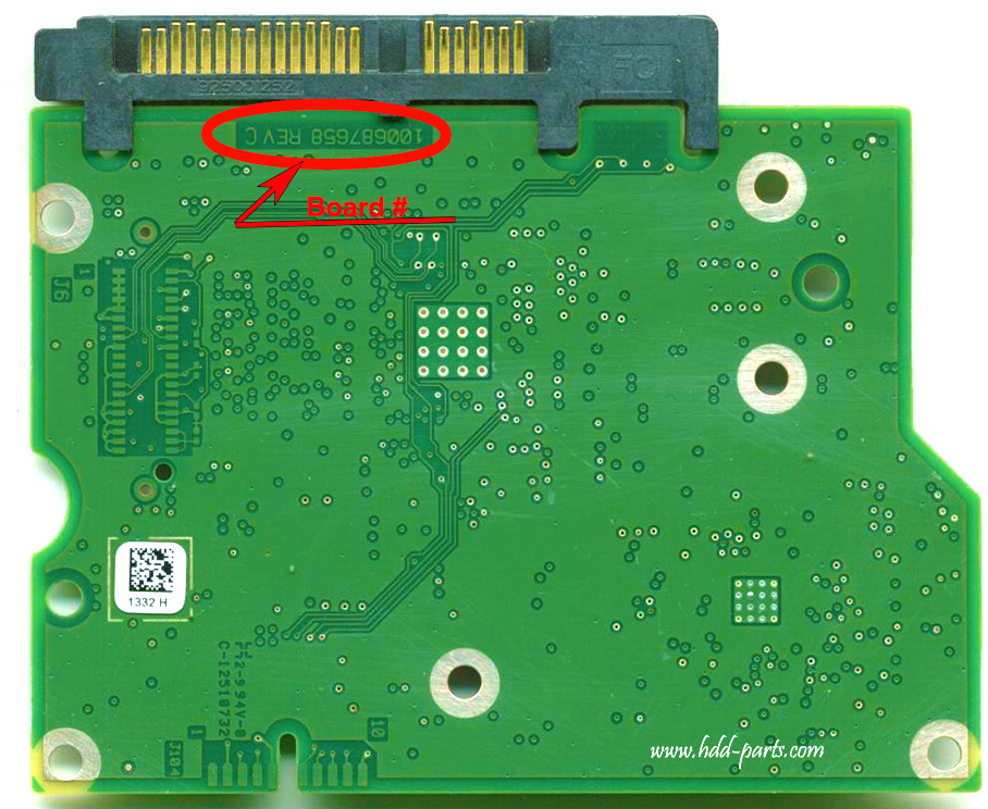

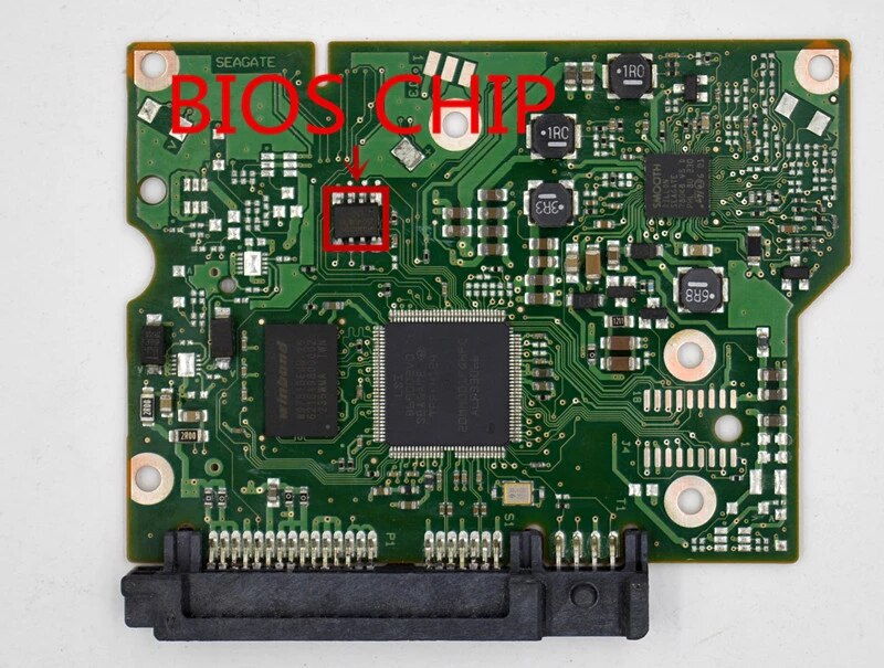

Hello everyone
seagate pcb short pin 100687658 rev c
please
I have problem This is what I am getting now:
Boot 0x40M
Spin Up
FAIL Servo Op=0100 Resp=0003
0100 0000 0000 0000 0000 0000 0000 0000 0000 0000 0000 0000 0000 0000 0000 0000 0000 0000 0000 0000 0000 0000 0000 0000 0000 0000 0000 0000 0000 0000 0000 0000
ResponseFrame 1A00 0000 0000 3EC0 0008 0000 0000 0000 0E46 0000 0000 0000 0000 0000 0000 0000 7439 C266 1FDE 7F6B 75BD DF12 CDDF 4BD5 1FB5 C508 0000 0029 0000 0000 001C 0002 0000
ResponseFrame 1A80 0000 0000 3F40 0008 0000 0000 0000 0E2E 0000 0000 0000 0000 0000 0000 0000 7439 C266 1FDE 7F6B 75BD DF12 CDDF 4BD5 1FB5 C508 0000 0029 0000 0000 001C 0002 0000
File comment: 100687658 rev c
ST3000DM001-1CH166-CC24-W1F2SGQG

your problem is more likely that heads are toast, shorting points won't help in such case...
