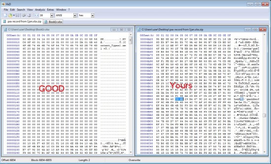

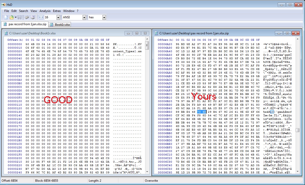

Here is the file I attached my friend has travel agency and this is the record file. I recover some other files so he just continue his work. You can try to repair...
pax record from 1jan.xlsx [37.83 KiB]
Downloaded 854 times
 Post subject: Re: Data Recovery .xlsx File
PostPosted: April 14th, 2014, 6:46
Posts: 4022
file has no header or the header is trashed. I see no way of fixing it.
It Is possible that the recovery software did not save the correct data, all the data or saved too much.

PostPosted: April 14th, 2014, 10:42
Posts: 4022
a blank excel 2007 document, when extracted (as a .zip file) expands to 6 folders with 11 files. The file is either going to need to be a slightly damaged zip file or pretty much perfect.
Unless the OP can recover the file from source again in better condition, then I think it is already game over.
a good excel file you can find the string "xml" in numerous places, and also see many consecutive 00's between the original files inside the zip, neither of which is present in the OPs file.
Remember that the answer "no solution" is a valid one.
