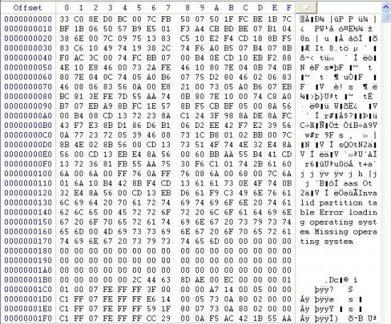

Greetings! Looking for some advice on next steps for getting data off of a dead drive.
In 2006 I had a Windows xp machine with it's own ide Bootable drive. I had a 2nd IDE drive (a Seagate barracuda) attached via an inexpensive usb enclosure. The drive/enclosure was used as a network drive on my windows machine. The drive died unexpectedly one day. No clicking, no warning, just dead. I was not at a point financially where I could afford a data restoration so I just put the drive to the side.
Fast forward to last year, I decided to get the restore done and I send it in to a company. After taking a LONG time to evaluate the drive, they asked for me to send in the old enclosure (which I still had) so I was hoping that was the key but apparently it wasn't. They claimed that the drive had an electronic issue and that the drive was fully encrypted and therefore could not get to the data. They sent me back the dead drive and an ISO image of the drive that cost me $500. They sent me a gif of the mbr and I saw an "invalid partition" error. (The snapshot is attached)
My confusion lies here: While it had been years since I used that pc and drive combination, I don't ever recall encrypting the entire drive. On the off chance that I did, I would hardly know even what program was used to perform such encryption. Moreover, I have no idea how to even possibly decrypt an iso file. My first instinct is to send the drive to another restoration shop but before I do I wanted to get more informed.
1) is it even possible for me to possibly decrypt this iso file myself and if so what tool could I use?
2) is there any value in sending the drive to another shop?
3) is it possible the drive was already encrypted at purchase time? (probably not but I'm really grasping at straws) encrypting an entire drive is nearly a day long operation today, much less 8 years ago and while I don't have an elephant's memory, I think I'd remember spending a whole day not being able to use my drive while saying to myself "just think, if I forget this password I'll never be able to use this drive again! "
Any kind words of advice would be helpful, even if they are "sorry mate but you're fucked". I'm just a bit floored that what I thought was going to be an easy restoration turned into a mess. Thanks for your time!

First of all the screenshot you attached shows perfectly normal MBR, there is nothing wrong with it. It shows that your drive has 4 partitions (all 4 are most likely NTFS partitions)
Second, based on that screenshot it is impossible to say if your drive has any encryption at all

As one can see, the boot sector is not encrypted. This means that there is no hardware encryption, and the drive is not fully encrypted. If there is any encryption, it must be an operating system induced one or software encryption. You might have to remember if you have activated NTFS encryption using Windows explorer.

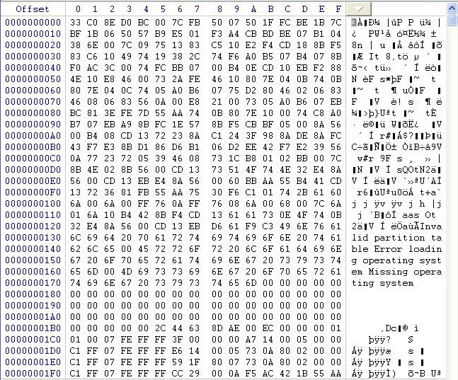

I would examine your image with a disc editor (eg DMDE freeware) in readonly mode. Start by uploading sector 0. Then we can see for certain what kind of file you have. You could also use HxD, depending on your version of Windows.

Spildit wrote:
Most likely you are dealing with file base encryption, and that explains why you can see the partition and the file names but they apear as if they don't have any valid content.
Also if you took the drive to a reputable data recovery lab (not an ordinary computer shop) and if they stated the files were encrypted, let's assume for now that their statment is correct.
Maybe you can extract some files from the image and post them here, so we can try to check the file content to confirm encryption ?
