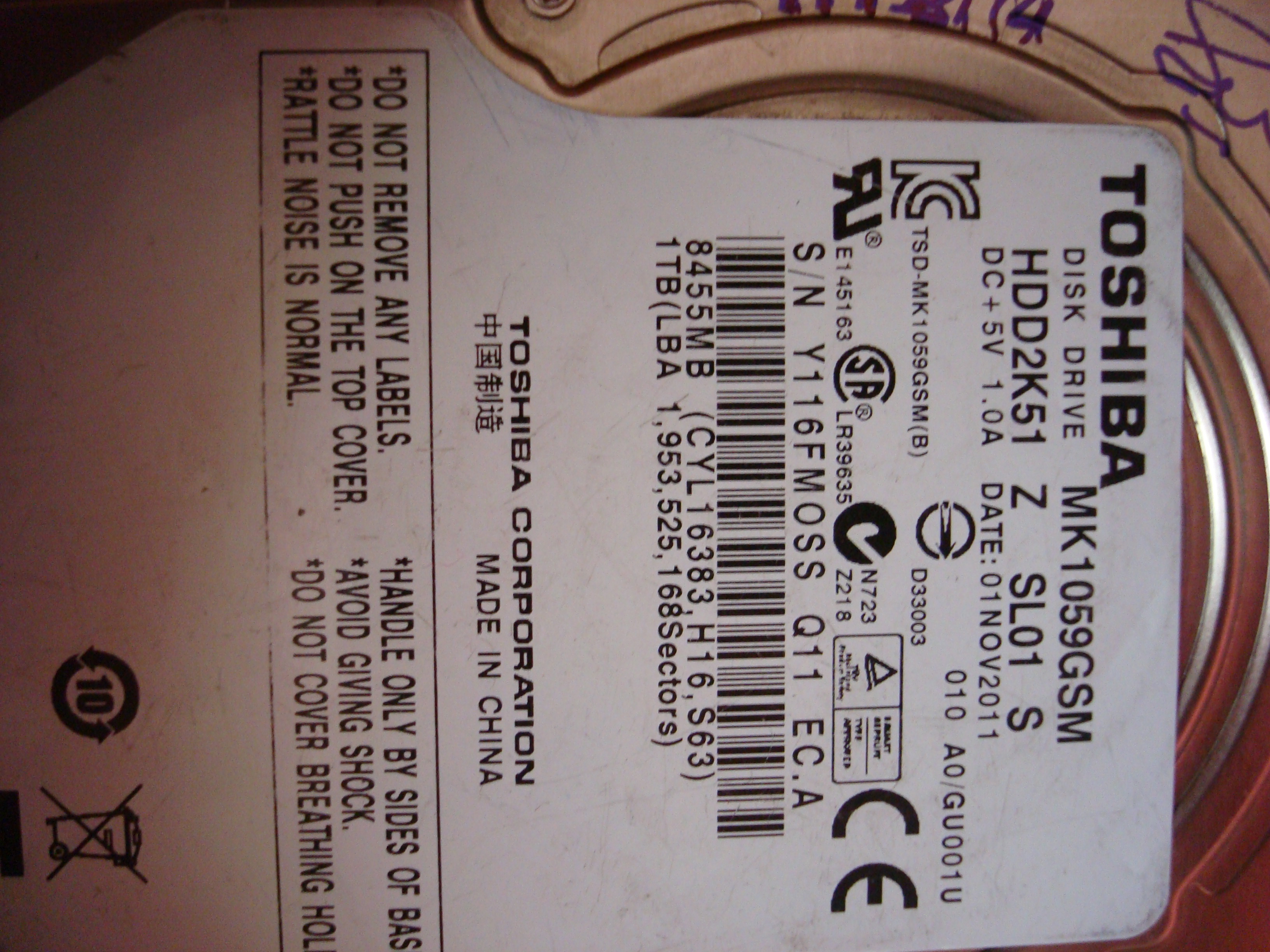

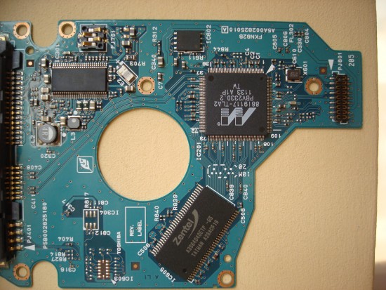

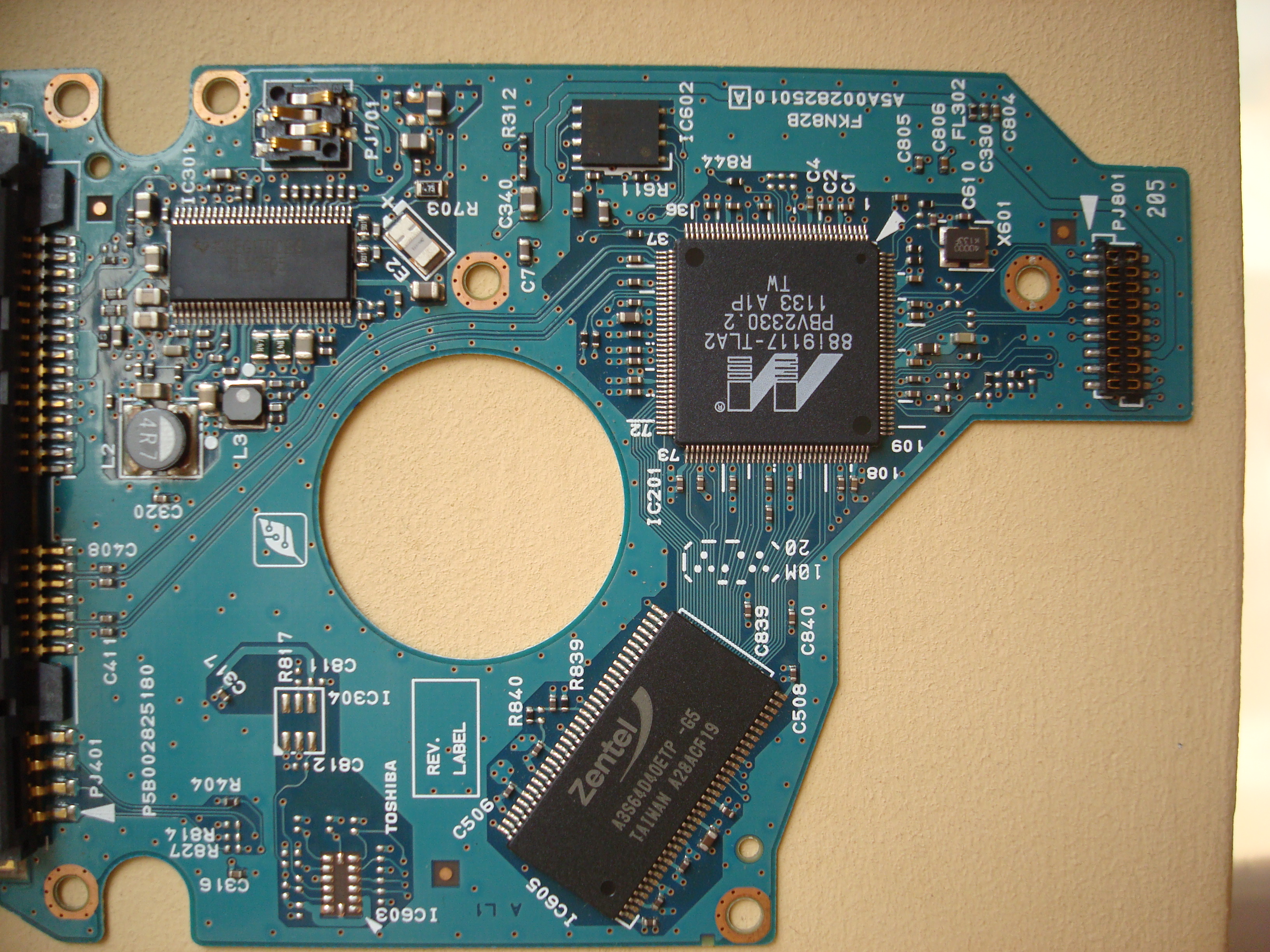

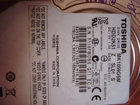

Yesterday my Toshiba 1TB HDD went kaput all on a sudden.
The hdd is not being detected by bios.
Now my question is "Where from to start for Repair of the hdd? which component is bad.
Gurus please guide.
File comment: This is the component side.
File comment: This the model.

What exactly do you mean by "kaput"?
Totally dead (not spinning)?
Clicking?
Buzzing?
Sweeping noises?
Sounds normal?
 Post subject: Re: My toshiba 1TB HDD went kaput
PostPosted: April 29th, 2014, 3:40
Joined: December 9th, 2010, 2:59
Posts: 241
Location: kolkata
total dead
PostPosted: April 29th, 2014, 3:58
Posts: 17232

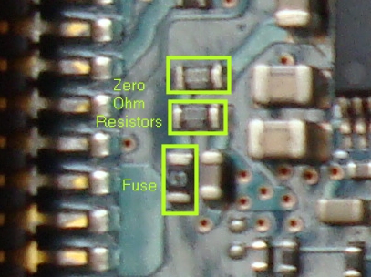

Can you measure the resistances of the following components?

Thanks, Fzabkar, I was expecting u.
Please give some tipss, how to start with that with multimeter. I am very much conversant with multimeter.

Recovery would most likely be as simple as replacing the PCB with a functional matching board and migrating IC602.
See section 5:
