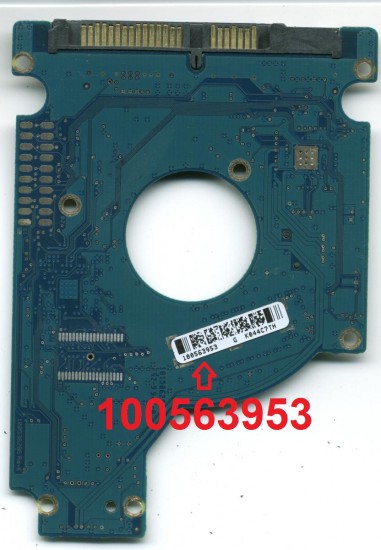

I receive hard drive from http://www.caritas.ch/en/home/ The worker of this organization has some personal and office data on the drive. The hdd spin down after few clicks I changes the PCB and bios chip the problem is same now the original PCB is on donor drive running perfectly so no PCB issue at all. I am also data recovery expert now final solution is a head swap I have many successfully head swap case but in most case head scratch the platter I have no solution for that and i think not available in the world the data is critical that's why i am discussing with hdd's guru's.
I will transfer the case if anybody has proper solution for this model.
