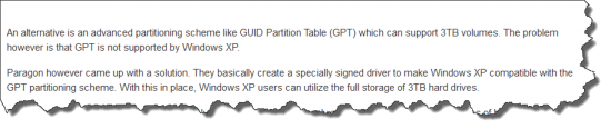

 Post subject: Re: new 3tb hard drive and problems
PostPosted: May 1st, 2014, 18:31
Posts: 293
bri:
could give this a look ...
http://www.ghacks.net/2010/11/04/how-to ... indows-xp/
K
Голод не тётка!
PostPosted: May 1st, 2014, 18:58
Joined: April 26th, 2014, 11:55
Posts: 9
Location: united kingdom
digitalferret that is the first thing i tried lol, i think it is not free anymore
thanks for replying man
