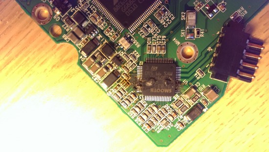

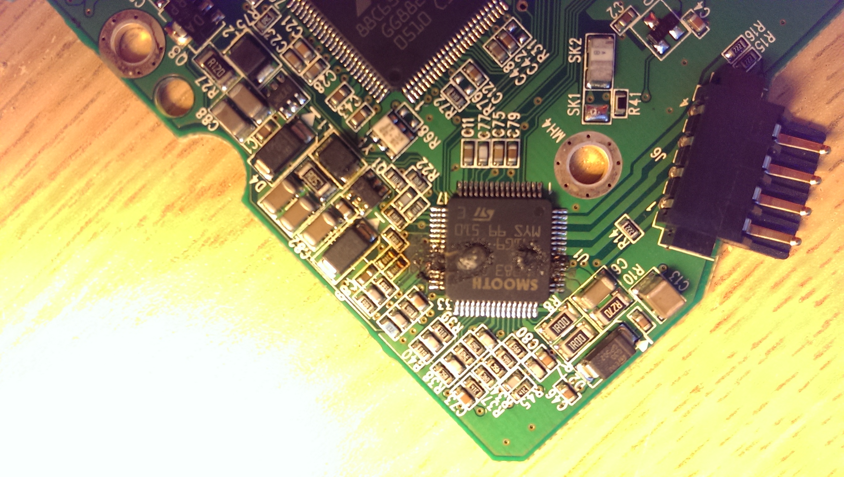

MY donor board finally arrived and i've noticed a small difference:
WD1200JB-00GVC0, 2061-701265-200 AJ - It's AJ and not AH like the original...
So, I tried it anyway - it now boots up and spins but does a single big click every 4-5 seconds and then tries again, nothing is recognised by PC.
I imagine the U12 swap is the final step now - good or bad chance of working?
Original PCB has several pins burnt out on SMOOTH chip!
 Post subject: Re: WD1200JB - 00GVC0 board needed
PostPosted: May 8th, 2014, 14:02
You may want to confirm that the donor PCB still works properly by testing back on the donor. It should, but based on what you said about SMOOTH, there may be other complexities involved.
If the donor PCB still works fine on the donor drive, then keep going on with the old plan.

Attached a pic of the damaged chip...
File comment: The damaged chip
