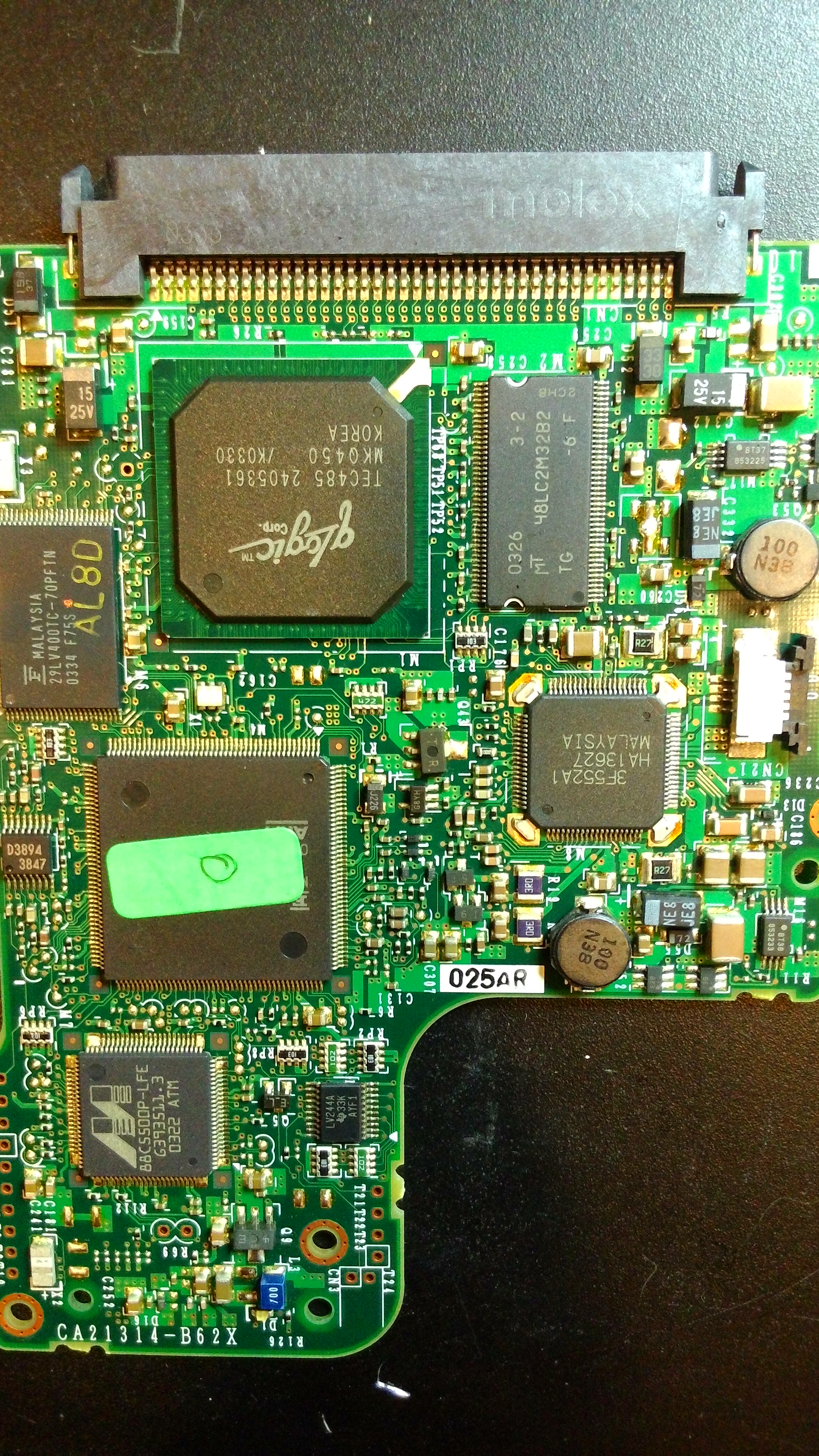

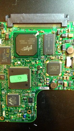

Dear all,
I've a faulty HP SCSI HDD. It doesn't spin up at all
Capacity: 36.4GB
Model: MAP3367NC
Part#: CA06200-B70100DD
Date: 2003-10
GNP: 271837-003
I've an identical donor PCB and it spins up the drive but obviously for a short one.
I'm totally new to SCSI drive, so it will be very grateful if anyone can tell me whether this PCB has TVS diodes & ROM? If it does, please let me know the location
Thanks in advance!!!!
Best Regards

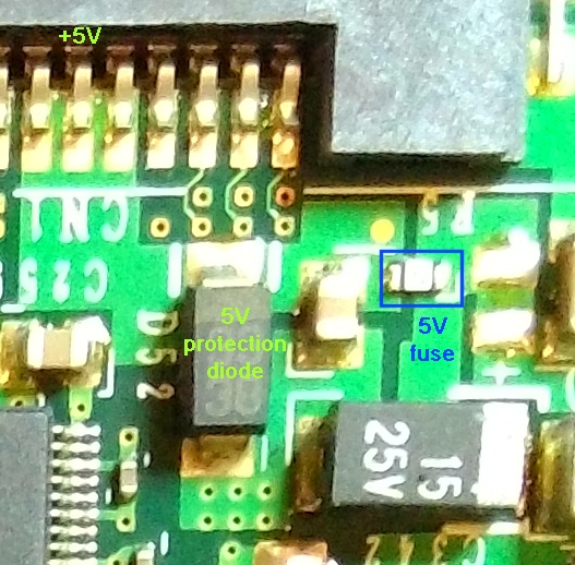

D51, D52, M6.
 Post subject: Re: SCSI Hard Drive's PCB Issue - PLEASE HELP!
PostPosted: January 12th, 2016, 16:34
Posts: 17328

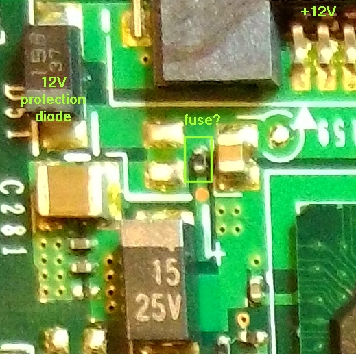

Check the fuses. I can help you with voltage test points if you are up to measuring them, but it would help if you didn't cut off the edges of the PCB in your photo.
PostPosted: January 12th, 2016, 18:07
Posts: 927
Location: uk
F5 is a fuse.
PostPosted: January 12th, 2016, 18:24
Posts: 17328
F5 is a fuse.
That's the 5V fuse. There appears to be a second 12V fuse at the top left corner of the QLogic disk controller. This fuse looks blown.

References:
BD3894FV, Rohm, Shock Sensor Signal Processor, 16-Pin SSOP, marking D3894:
BD3893FV, Rohm, Shock Sensor Signal Processor, 3.0V - 5.5V, SSOP-B16:
http://media.digikey.com/pdf/Data%20She ... 3893fv.pdf
SN74LV244A, Texas Instruments, OCTAL BUFFERS/ DRIVERS WITH 3-STATE OUTPUTS, 2V - 5.5V:
http://www.ti.com/lit/ds/symlink/sn74lv244a.pdf
88C5500P-LFE, Marvell, HighPHY PRML Read Channel physical layer device, DSP, 3.3V, 1.8V internal regulator:
http://www.ic72.com/pdf_file/8/73313.pdf
MBM29LV400BC-70PFTN, Fujitsu, parallel flash memory, 4M (512K x 8/256K x 16) bit, 3.3V:
http://pdf.datasheetcatalog.com/datashe ... Xustts.pdf
HA13627, Hitachi/Renesas, SPINDLE MOTOR & ACTUATOR COMBO. DRIVER:
MT48LC2M32B2TG-6F, Micron, SDRAM, 2 Meg x 32, 86-pin TSOP II, 3.3V:
https://www.micron.com/~/media/document ... _sdram.pdf
TEC485, QLogic, SCSI disk controller:
http://pdf.datasheetarchive.com/indexer ... 483388.pdf (FAS660)
1SS337, Toshiba, ultra high speed dual diode, common cathode, 80V, 200mA, TO-236MOD, marking J9:
http://toshiba.semicon-storage.com/info ... ame=1SS337
1SS336, Toshiba, marking I9, dual 200mA, 80V, ultra high speed switching diode, common anode:
http://www.datasheetcatalog.org/datashe ... ba/541.pdf
http://www.toshiba.com/taec/components2 ... N_1774.pdf
marking G8YH, LDO regulator (?)
marking "BT38 853233", 3.3V buck regulator
marking "BT37 853225", 2.5V buck regulator
MAP3147NC/NP, MAP3735NC/NP, MAP3367NC/NP PRODUCT/MAINTENANCE MANUAL:
http://pdfstream.manualsonline.com/2/2f ... a27a29.pdf

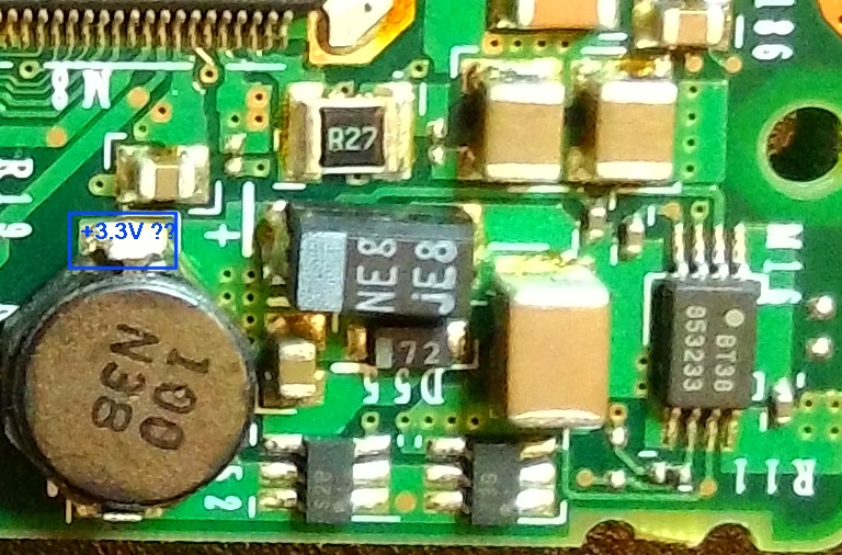

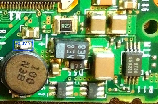

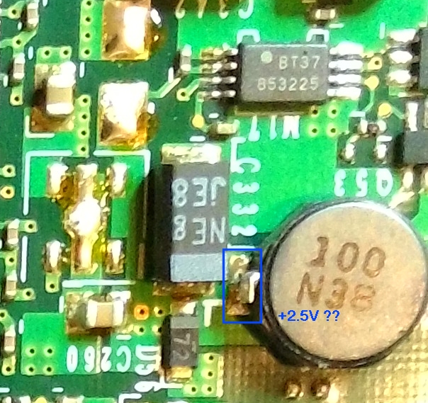

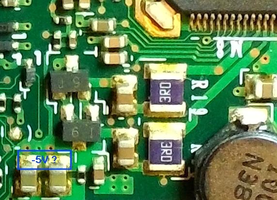

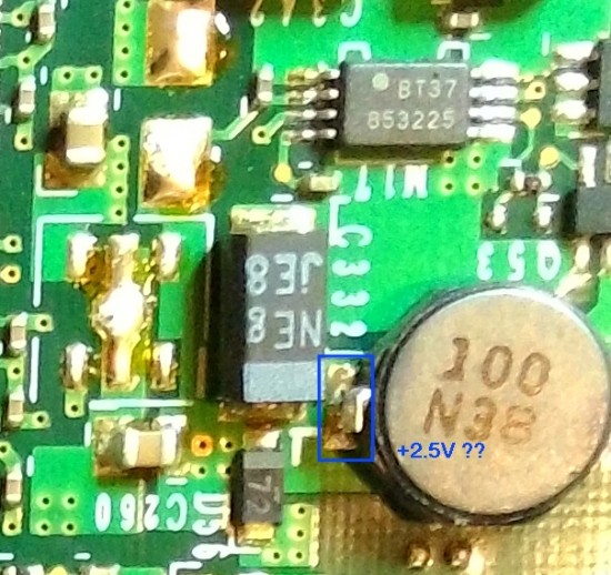

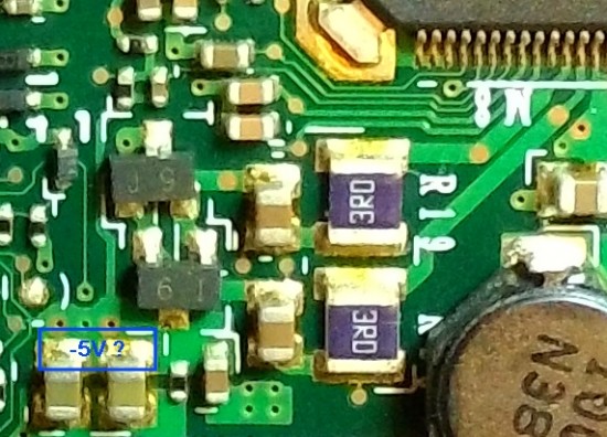

Some test points ...
The -5V regulator appears to have the same topology as the -5V DC-DC converter in the following article:
http://www.users.on.net/~fzabkar/HDD/Tu ... 0411N.html
