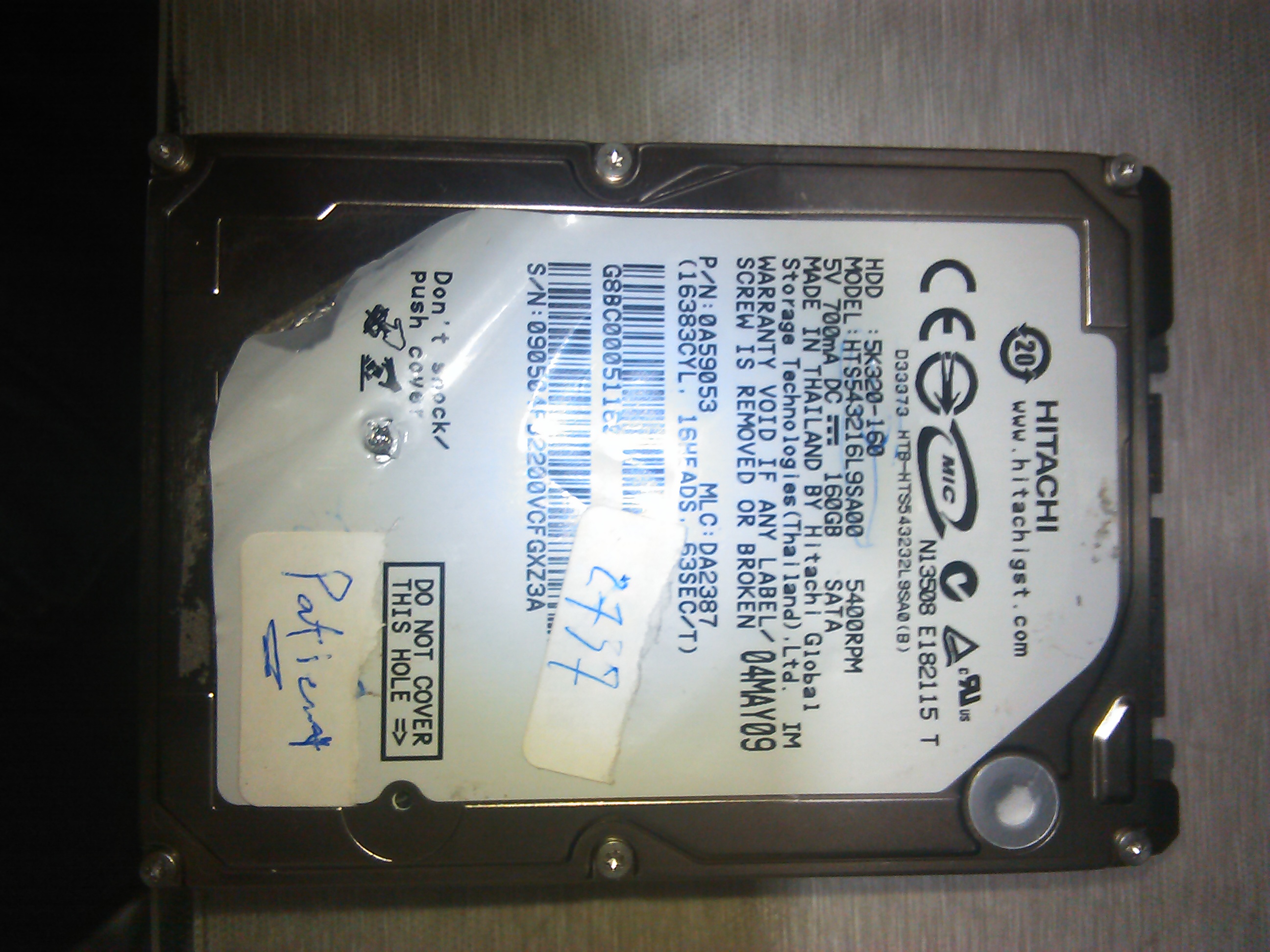

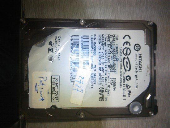

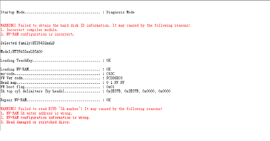

Hello Gurus,
The drive came to me from Kuwait opened. ( I don't know who opened it, but surely it's opened in non-controlled room with non-professional person )
The drive has a fingerprint on the top side and a ring scratch to the outer diameter ( 1 platter-2 heads ).
After replacing heads from fully matched donor, the drive spin up and calibrate normally but there's a 1 click then the drive become ready but no ID.
Any thoughts friends?

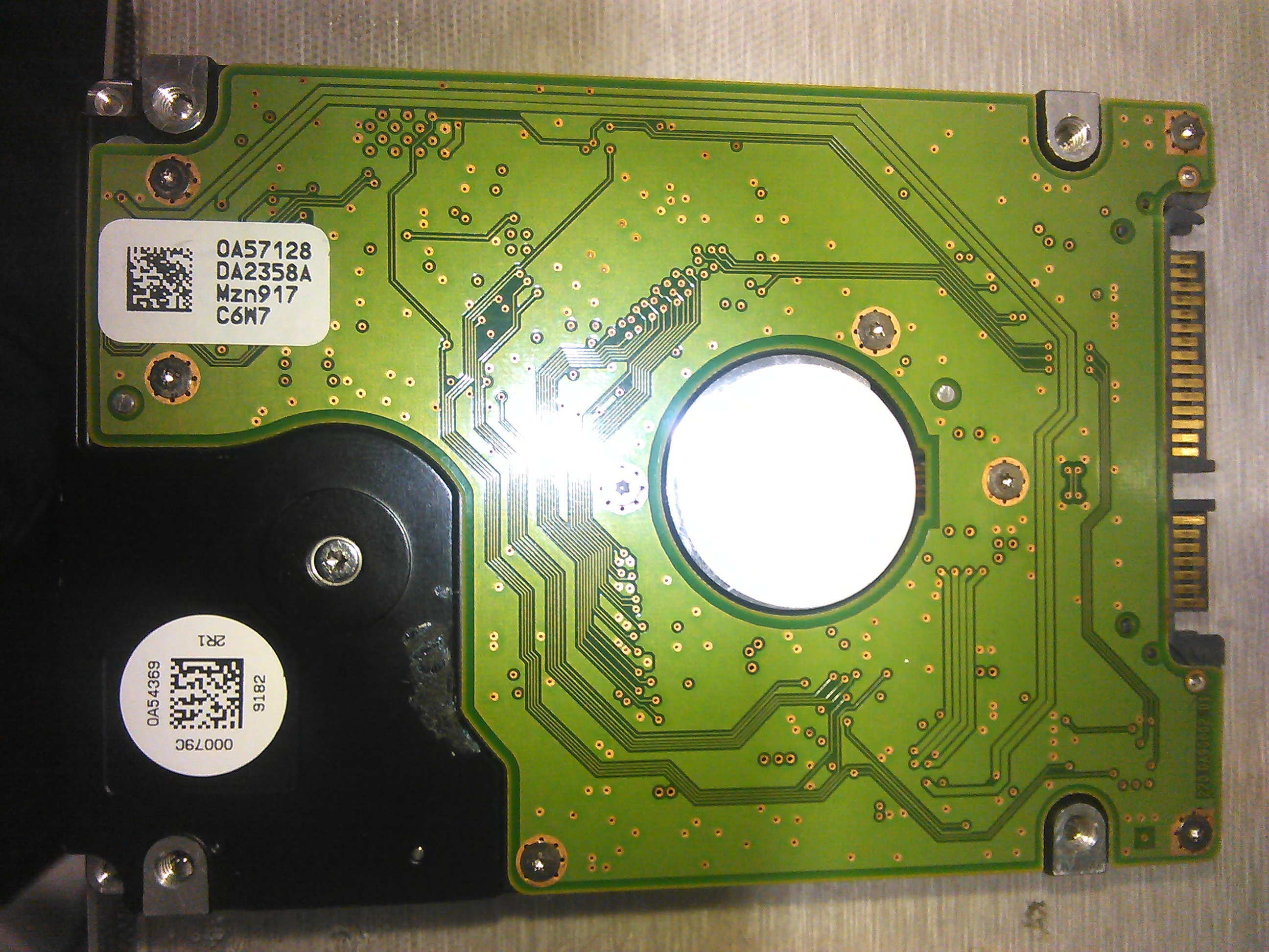

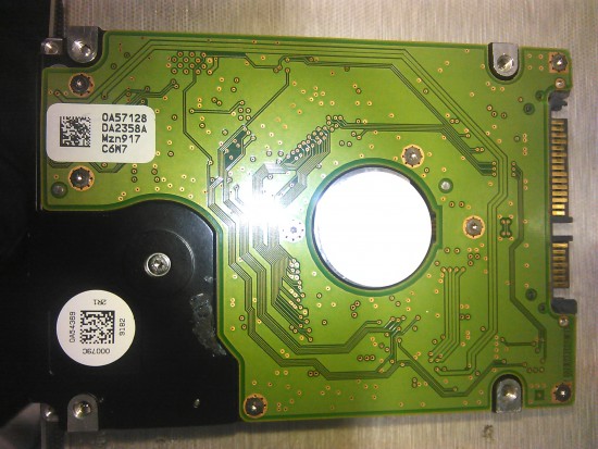

 Post subject: Re: HTS543216L9SA00
PostPosted: January 11th, 2016, 12:37
Posts: 1729
I don't know even if it's the original PCB and NV-RAM or not.
Is there a way to identify if it's the original PCB or not ?
Thanks in advance.
PostPosted: January 11th, 2016, 15:00
Posts: 17223
The label would suggest a serial number of "VCFGXZ3A" but the NVRAM doesn't agree.
000001C0        56 43 47 30 42 31 52 41                      VCG0B1RA
The manufacture date on the cover 04MAY09) seems to match the "Mzn917" on the PCB label. That could be a YWW date code, ie week 17 of 2009, which does match the cover.
PostPosted: January 11th, 2016, 18:00
Posts: 17223
I may be wrong, but IIUC the serial number in the NVRAM does not match the one on the label, so it can't be native.
Here are 5 drives that appear to confirm my thinking:
http://www.ebay.com/itm/HTS543216L9SA00 ... 2206wt_918
Edit: Sorry, I didn't see the previous reply.

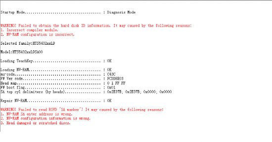

PostPosted: January 12th, 2016, 8:22
Posts: 1729
Thanks for reply Mr. Shahi.
I have MRT, but I have no access to SA ?

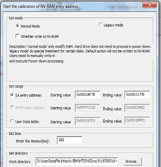

PostPosted: January 12th, 2016, 10:52
Posts: 1388
Location: isreal
i'm not familiar with MRT but isn't there a function for NVRAM adjustment ?
if not PC3k does, outsource it to someone who has PC3K
PostPosted: January 12th, 2016, 10:57
Posts: 1729
Yes.

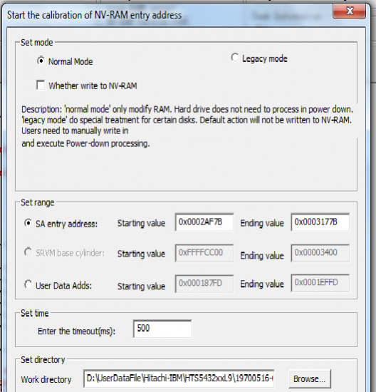

PostPosted: January 12th, 2016, 13:32
Posts: 1061
Location: Bangladesh
You won't get SA Access, it's normal in such circumstances.
You can try the NORMAL Mode and see
