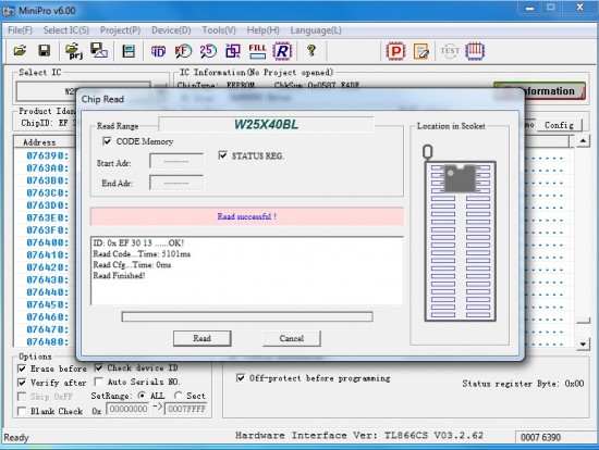

I got the programmer to work and I've read the 'dead' 8-pin Flash ROM chip.
Only problem is, I can save it as a HEX or BIN file type, but this Forum will
not accept ANY file extension I can think of. Should I just copy and paste
the raw read AS text? ( I DID)
Here is the data:
Any help appreciated...
Oy!
MONARCH.TXT [2.43 MiB]
Downloaded 714 times

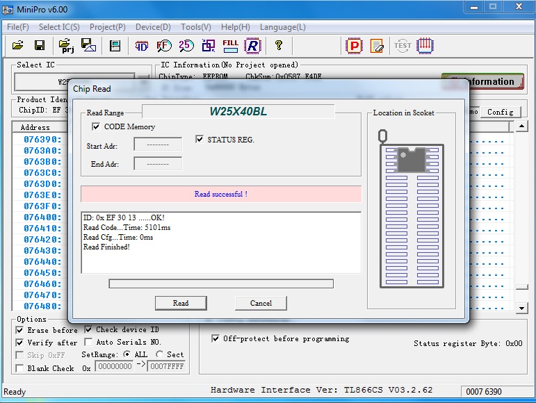

I've never done a ROM dump before. The reader gives me the opportunity
to save it directly as a .bin file, but this forum doesn't let me upload such
a file. I had to convert to text. maybe that's the problem.
This time I just zipped it. Please check and advise....
I also attached a screenshot from my reader
-Oy
monarch.zip [173.44 KiB]
Downloaded 468 times

C:\Downloads\Samsung\Firmware\HD103SJ-1AJ10001_3>chksum2 -16 *.bin
MONARCH.BIN: 524288 bytes checksum16 = 0x0200
FIPS.BIN: 1024 bytes checksum16 = 0x0000
ROM_256K.BIN: 262144 bytes checksum16 = 0x0000
All the checksums appear to be OK.

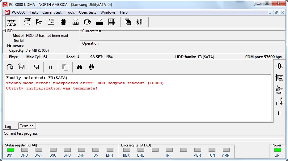

Okay, results:
1 - Original PCB with Original ROM on Original drive - - drives stays BSY all day long
2 - Donor PCB with Donor ROM (altered during last hotswap) on Original drive - - drives stays BSY all day long
and, just for fun:
Donor PCB with Donor ROM (altered during last hotswap) on Donor Drive - - drives stays BSY all day long
I think I need another Donor.....
-Oy

Yes, drives spin in all cases.
But, I don't get what your asking. What Terminal log?, the drive is BSY.
The drive can`t be identified, the start arrow in PC3K just gives error.
Am I missing something ?
-Oy

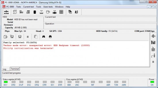

Hi. Okay, I wish to start over from the current state. Here is a Samsung HD103SJ 1TB hard drive
that spins up in PC3000UDMA and here is a screenshot from Safe Mode:
 Post subject: Re: Samsung HD103SJ FW 1AJ10001 corrupt ROM - HOTSWAP woes
PostPosted: June 3rd, 2014, 12:40
Joined: November 17th, 2013, 15:28
Posts: 38
Location: Canada
Wow, my post disappeared after posting the Safe Mode screenshot - I was not done.
Anyway, the normal Mode screen is exactly the same.
-The Terminal windows is totally blank in both cases.
Note the drive is spinning and the BSY stays on forever.
There is no clicking or other abnormal sounds.
After in the utility (with 0MB showing) and looking at blank Terminal Window,
if I cycle the power, I can see this output:
*PA VID=0000 PN=0004 Rev=0002- 785x Found
ChipRev = 63B0
U
S_0
RV En Sensor Circuit
En Shock Sensor Circuit
SO_1
RPM at Handoff: 3333
Temp : 33 degC
SpinOk
mS1 00000003
SK C:101904 H:0
Loaded FIT ( 0: 0: 1)
CalibTable Loaded. Rev:0x14
Selective MARC NX Loaded
ResoTable Loaded. Rev:0x01
Ovly loaded to 0x0001CD00
Ovly loaded to 0x1005B800
This output is the same whether you enter Normal, Safe or Terminal Mode.
So, at this stage, what would a knowledgeable Data Recovery person try?
Thanks!
