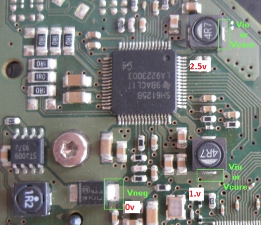

Anyways, I stripped the HDD out of the USB enclosure (a Samsung HD204UI), and popped it into a PC I had on the bench - disk didn't spin up, not detected in the BIOS. After a lot of poking about with a multimeter I concluded that the PCB was dead, and that there was a reasonable chance that a replacement PCB swap would get the drive going again (PCB serial No is BF41-00314A).
After furnishing my colleague with my findings and the number of the PCB, he decided it was worthwhile and procured a second hand one from Hong Kong (his decision, not mine...) The board arrived today, nothing outwardly wrong with it, more or less identical as fas as I could tell. I fitted it to the HDD, and sure enough, no spin up and not detected in the BIOS. Great.
Removed the board, and out with the multimeter again. This board has a few more signs of life than the old one; the only thing I can find wrong with it is that the Vneg isn't present. Does anyone know what could cause this, and if it's possible to fix it? Any help is greatly appreciated.

The native PCB did not have any shorts on it, when plugged into the PC it started normally. There was no voltage present at any of the points in the pic I attached on the leading post, leading me to think it was dead. Removal of the TVS diodes on the native board didn't improve the situation, and the 0 ohm resistor was not blown.
Any thoughts on the lack of V neg on the donor board?

@chrisund123, was there any damage to the TVS diodes on the patient PCB?
What resistance do you measure between ground and Vneg when the donor PCB is installed on the drive?

I dont recall there being damage to the patient tvs diodes, but I de-soldered them anyway in a "poke and hope" kinda way... I'll check them again on monday when I'm back at work.
I suspect the donor board is faulty personally. I did a little more poking about while my post was waiting for moderation, and I found that the diode where I was hoping to find Vneg seems to be shorted out on the donor board, but good on the patient board. Reckon I should try swapping them over?
Did you measure the diode while the board was on the drive? If so, then a shorted preamp (on the headstack) would produce the same result.
Nope, I've removed the board from the drive for testing.

chrisund123 wrote:
That's interesting. Assuming that it's not the capacitor that is shorted, then I wonder what killed the diode. You might like to place the patient board on the drive and perform the same resistance test, just to be certain that a bad preamp hasn't killed your donor. Otherwise I'd swap the diode and hope for the best. Test the board off the drive before trying it, though.
BTW, you may still find that the donor PCB could be incompatible, depending on the firmware version, but at least it should spin up the drive.
