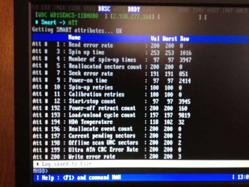

Someone brought me a Western Digital 1.5TB drive. It has been in a Mybook USB enclosure. It stopped working, so it was taken to Best Buy, where they (Best Buy) sent it to some outfit that told the owner it would cost $1500 - $2000 to get the data back.
It is "just" photos and not worth that much to the owner. So the owner got my name from a friend and brought me the drive.
I tossed it on my machine and ran MHDD and get an ABRT on every sector.
Any ideas on anything I can check w/o having PC3000 or similar tools?

What's the smart status?
Press F8 in mhdd to see it.

 Post subject: Re: WDC firmware fix w/o pricey tools?
PostPosted: April 27th, 2013, 16:26
Joined: September 27th, 2005, 9:10
Posts: 220
PostPosted: April 27th, 2013, 20:54
Posts: 17326
FWIW, MODs 20h and 21h are showing that the SMART Command Timeout attribute has hit its threshold. That's one of the hidden attributes that isn't reported to the user.
ID   Typ   Cur  Worst  Raw             Description
1   2F    200  200    00000000000000  Read Error Rate
3   27    253  253    000000000003F8  Spin-Up Time
4   32     97   97    00000000000F6B  Start/Stop Count
5   33    200  200    00000000000000  Reallocated Sector Count
7   2E    191  191    00000000000355  Seek Error Rate
9   32     97   97    0000000000096F  Power-On Hours
A   32    100  100    00000000000000  Spin Retry Count
B   32    100  100    00000000000000  Calibration Retry Count
C   32     97   97    00000000000F69  Power Cycle Count
B8   B2 H  100  100    00000000000000  End-to-End Error
BB   B2 H  100  100    00000000000000  Reported Uncorrectable Errors
BC   B2 H    1    1    0000DF00E10151  Command Timeout
BE   A2 H   68   52    00000000000020  Airflow Temperature
C0   32    200  200    000000000000A0  Power-off Retract Count
C1   32    197  197    0000000000266E  Load/Unload Cycle Count
C2   22    118  102    00000000000020  Temperature
C3   B6 H  100  253    00000000000000  Hardware ECC Recovered
C4   32    200  200    00000000000000  Reallocation Event Count
C5   32    200  200    00000000000002  Current Pending Sector Count
C6   30    200  200    00000000000002  Offline Uncorrectable
C7   32    200  200    00000000000000  UltraDMA CRC Error Count
C8    8    200  200    00000000000003  Write Error Rate
F0   B2 H   99   99    00000000000371  Head Flying Hours
F1   B2 H  200  200    000000102A61AA  Total LBAs Written
F2   B2 H  200  200    0000000BAD411D  Total LBAs Read
PostPosted: April 27th, 2013, 22:40
Posts: 220
jono-ats wrote:
It could be bad Relo, but I doubt it, since the checksum is OK.
More likely it's a weak head.
Given the way the drive acts otherwise (delays after ID and EID and SCAN, sometimes timeout on any of those) I'm sort of guessing it is a weak head.
But in this case, the weak head has lead to firmware issues too?
