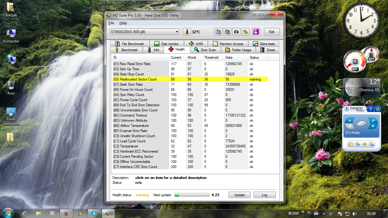

Hello everyone, I am writing to you to ask, because I have the drive in a laptop HP DV7 Seagate Momentus 5400.6 2.5 "SATA2 ST9500325AS. General condition of the disk is good, no wheezes, knocks, hard working properly is generally in good shape but if not for the fact that in SMART shows the parameter 05 reallocated sector count raw value of 50, has not given rise to this subject.'m sure there are a bad logical not physical, and why I think so? Because the drive never fell or was not transferred to laptop without anti-shake briefcase. Gently celebrate with such things. Question I have, how to remove the G-list this drive? And SMART attributes?'m asking because I have this attribute by a general decline in overall system performance.
:arrow: PS. In the drive is installed Windows 7 Ultimate x64 Original.
:arrow: I have a terminal built on the MAX232.
:arrow: I attach is SMART drive:
:arrow: btw, My English is how to say, lame and are backed by some with the help of google translator, because i come from Poland.
:arrow: If someone, wants to work with the HDD, the offer from your site teamviewer.
Thanks in advance to everyone for their willingness to help less experienced. Regards!

Hey Spildit, Exactly the problem is that I do not want that data has been lost, I just want to clear G-list, and SMART attributes to get rid of bad logic. This parameter has not increased since two years.
I know that N1 command is used to clean the SMART attributes, but what about the G-list?

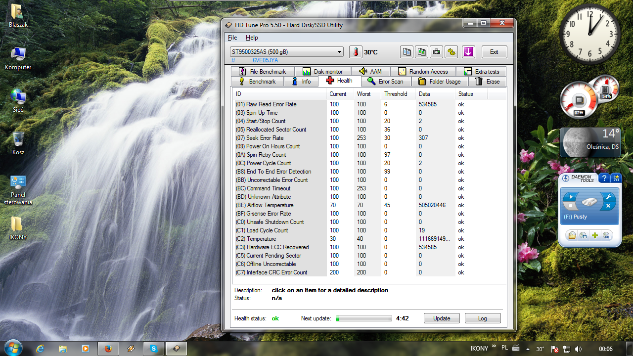

Hey Spildit, It worked, drive regained its performance. Overall, the system began to run much faster (new windows) than it was before the operation. Btw, the action of the drive never lost any data. The data are now safe. I worked on this drive.
I attach a new disk SMART:
I know it was this emergency assistance in the disk, but the purpose has been achieved. The disk is not for sale, but only for home use (As I worked on the HP DV7 Laptop)
