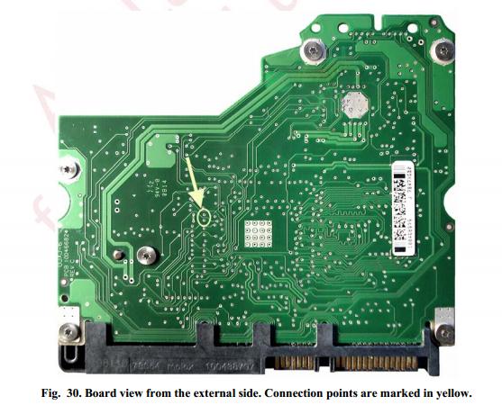

I found a document that speaks to shorting the read channel. http://www.rom.by/files/SeagF3_NET.pdf
Page 20 of the document shows the location of the vias to be shorted for my PCB. Can I get some specific guidance on how to proceed?

which is your pcb number?

UJAJ-6
PCB 100466824
REV C

Short points are marked on fig.30 in the pdf you posted.
Power on the drive and short those points before getting led cc error.

I usually solder 2 piece of thin wires to a switch to do this, i'm not comfortable using tweezers.
OK
wires are attached. ImageImage
If I understand correctly the process is this:
power up then immediately short the wires.
QUESTION: how long do I wait after shorting the wires before I send the ctrl+Z?
send Ctrl+z to get F3 T> prompt.
QUESTION: if I do not get the F3 T> prompt do I keep trying by sending subsequent ctrl+z's?
send /2
send Z
QUESTION: after spindown is complete is that when I unshort the wires and continue with the original procedure?
Sorry for so many questions, but I want to do this right the first time.
YES
i don't remember, a couple of seconds i think
YES, you should get the prompt in less then 10 seconds, if not repeat the process again changing the timings between power on and short channel.
you can unshort wires after you reach T level.
don't worry if you don't short read channel with proper timings, just repeat it again.
The very important thing is to not mess with commands N1 and expecially with m0,2,2,,,,,22
Be sure to type them right before pushing enter.
N1 should take 2 seconds to be done.
m0,2,2,,,,,22 will take more time to complete, just be patient

i remember one time i had to wait 90 minutes on this type of drive to finish translator regeneration.
I had to isolate the drive terminals
you don't have to isolate pcb if you short the read channel
My firmware database:
 Post subject: Re: Seagate 7200.11 not detected
PostPosted: June 5th, 2014, 17:18
Joined: June 3rd, 2014, 18:11
Posts: 13
More than 4 hours now and still only the F3 1> prompt on the screen.
Is there some way to tell if anything is happening?
