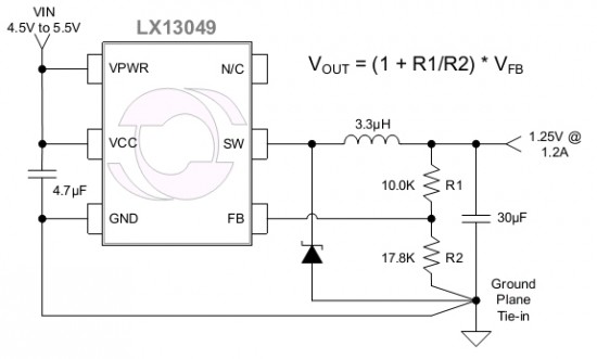

It does appear that there is something wrong in the Vio supply. Could you tell us the markings on the square 6-pin IC in that area?
 Post subject: Re: Seagate ST9250827AS
PostPosted: June 20th, 2013, 6:28
Joined: June 18th, 2013, 4:46
Posts: 22
Location: Portsmouth
The nearest one I can see is 9 O'Clock from the coil (on my picture).
The markings are:
3049
0838B
MSC
Thanks again
PostPosted: June 20th, 2013, 6:51
Posts: 17323
Here is the part:
LX13049, Microsemi, PWM Buck regulator, 1.25A, 6-pin, marking 3049:
http://www.microsemi.com/document-porta ... -datasheet
Very carefully measure the voltage at each pin. Do not slip with your probes, as catastrophic damage may result. I suspect that this chip may be faulty, in which case it would probably be more expedient to replace the board.
PostPosted: June 20th, 2013, 16:35
Posts: 17323
The first (VPWR) and second (VCC) pins down the left side should both measure +5V. That's because they are wired directly to the +5V pins at the SATA power connector. Either there is a dry solder joint at the VCC pin, in which case just reflow it with your soldering iron, or you have measured incorrectly once again.
However, the more interesting result is the output voltage of 0.8V.
This is what you should be measuring:
5V <IC> Not/Connected
5V <IC> 3R3 coil -> +3.3V (?)
0V <IC> 0.8V (feedback resistors)
Can you measure the voltage at both sides of the 3R3 coil again? It should measure +3.3V (or perhaps +2.5V). If it measures 0.8V, then I expect that resistor R2 would be open circuit, in which case a repair should cost you only a few cents. However we would need to calculate its correct value.

5.03 <IC> 3.43
5.03 <IC> 0.00
0.00 <IC> 0.80
I was supprised as the 3.43v (top right) value should not be connected and the middle pin should have been reporting the 3.43v value.
The coil reported 3.43v one side and 3.41v the other.
PostPosted: June 21st, 2013, 5:43
Posts: 17323
Two of the pins are reversed (typos), but otherwise the voltages are as expected.
Sorry, that's about as far as we can go. :-(
