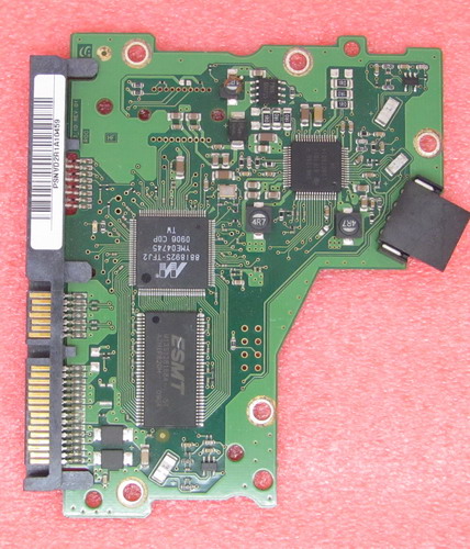

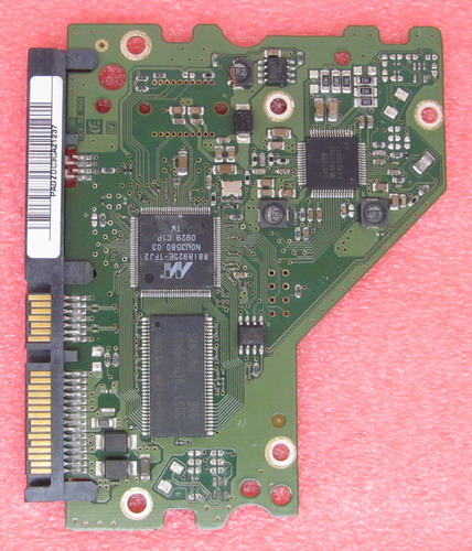

PostPosted: May 25th, 2014, 19:57
Posts: 14945
I notice that there are 88i8925-TFJ2 MCUs with internal ROM and 88i8925E-TFJ2 versions with external ROM.
A Google search finds several HD502HJ PCBs that use the 88i8925E-TFJ2. Is it possible that there are versions that use the 88i8925-TFJ2, and would the ChipRev in the ROM code reflect the difference?
http://www.hddzone.com/images/S10032.jpg (8925-TFJ2, internal ROM)
http://ecx.images-amazon.com/images/I/51F5dJxoetL.jpg (8925E-TFJ2, external ROM)
http://ecx.images-amazon.com/images/I/51tvWnKaNHL.jpg (8925-TFJ2, internal ROM)
http://www.drivestar.biz/images/pcb_samsung/00263a.jpg (8925-TFJ2, internal ROM)
http://www.drivestar.biz/images/pcb_samsung/00278a.jpg (8925E-TFJ2, external ROM)
http://i01.i.aliimg.com/wsphoto/v0/7497 ... 00263A.jpg (8925E-TFJ2, external ROM)
http://www.kompisland.ru/products_pictu ... 3A_enl.jpg (9025-TFJ2, external ROM)

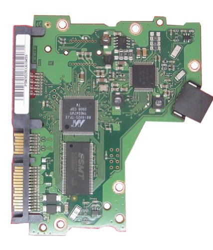

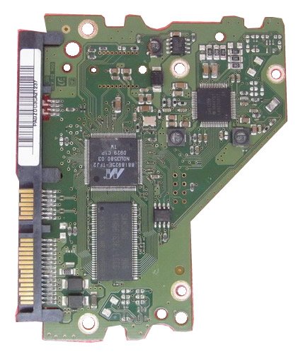

Which one?
I found 6 different PCBs that were used with the HD502HJ. The earliest has an 88i8925E MCU while all the later ones have an 88i9025.
http://ep.yimg.com/ay/yhst-44463692235217/263a-4.gif (BF41-00263A 88i8925E)
http://ep.yimg.com/ay/yhst-44463692235217/302a-3.gif (BF41-00302A 88i9025)
http://ep.yimg.com/ay/yhst-44463692235217/330a-4.gif (BF41-00330A 88i9025)
http://ep.yimg.com/ay/yhst-44463692235217/332a-4.gif (BF41-00332A 88i9025)
http://ep.yimg.com/ay/yhst-44463692235217/352a-4.gif (BF41-00352A 88i9025)
http://i01.i.aliimg.com/wsphoto/v0/1568 ... -board.jpg (BF41-00370A HD502HJ 88i9025)

Matiw wrote:
The original Post shows that the ROM is electrically ok as it had span the drive; but subsequent posts show it has firmware incompatibility with the MCU.
Could not the problem be the lose of the adaptives with the firmware ?
fzabkar," PLL cal timeout" (Phase Lock Loop) seem to be something related with reading problem, reading from platter (clock-data synchronization problem)
http://users.utcluj.ro/~baruch/media/si ... -Disks.pdf.
Dmitri wrote:
Spildit wrote:
Trying to figure out what is wrong with this one.
ROM apears to be OK but i can't access MC and drive stay BSY.
Would it be a burned pre-amp (not sending it's ID to the PCB) or would this mean that ROM isn't native ?
As a quick Monday night solution, I'd suggest the following:
1. Install definitely working donor PCB. Check whether the drive spins up.
2. If it spins up, swap the ROM chip, check whether the drive spins up and initializes.
If it spins up with donor board and donor ROM, but doesn't with donor PCB and original ROM, then ROM is dead even if it looks all right.
Hi there and thanks for your post.
This drive was recieved from a client that stated that is was taken to another data recovery firm.
My guess is that the original PCB was toasted and that data recovery firm replaced the PCB for one that didn't have a matching MCU and swapped ROM.
I've had some problems with this forum and had to re-register to drop some quick notes on some posts that i was following / cases that i was working.
At this stage i will provide the advice to swap the PCB for one with the MCU compatible with the ROM code.
Thanks for all the suggesions and comments.
